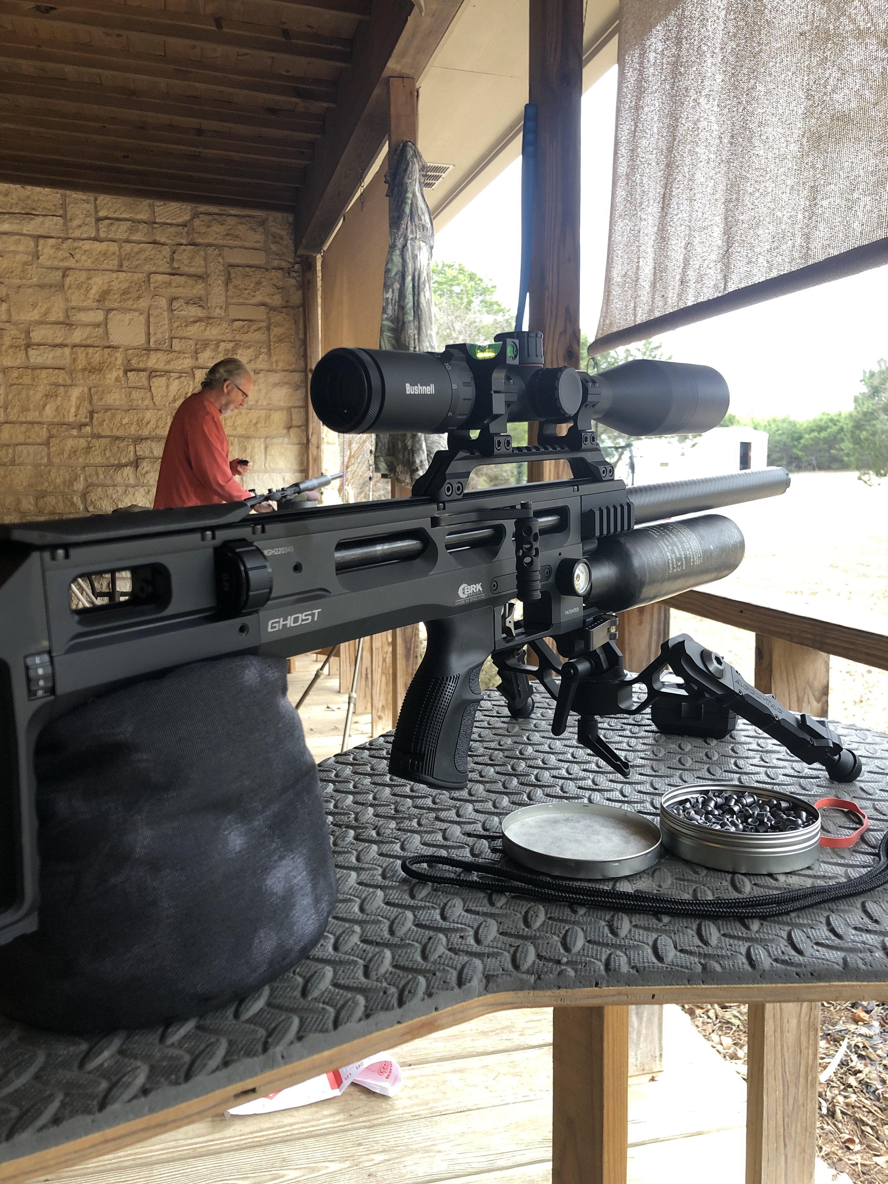

The BRK Ghost is a very well made PCP. When getting under the hood, you know youā€™re in the presence of a well engineered piece of equipment.
Set all 3 Huma regs at 150 bar and tested over the chrony. All performed great. These crew of Ghosts were now ready to rock!!

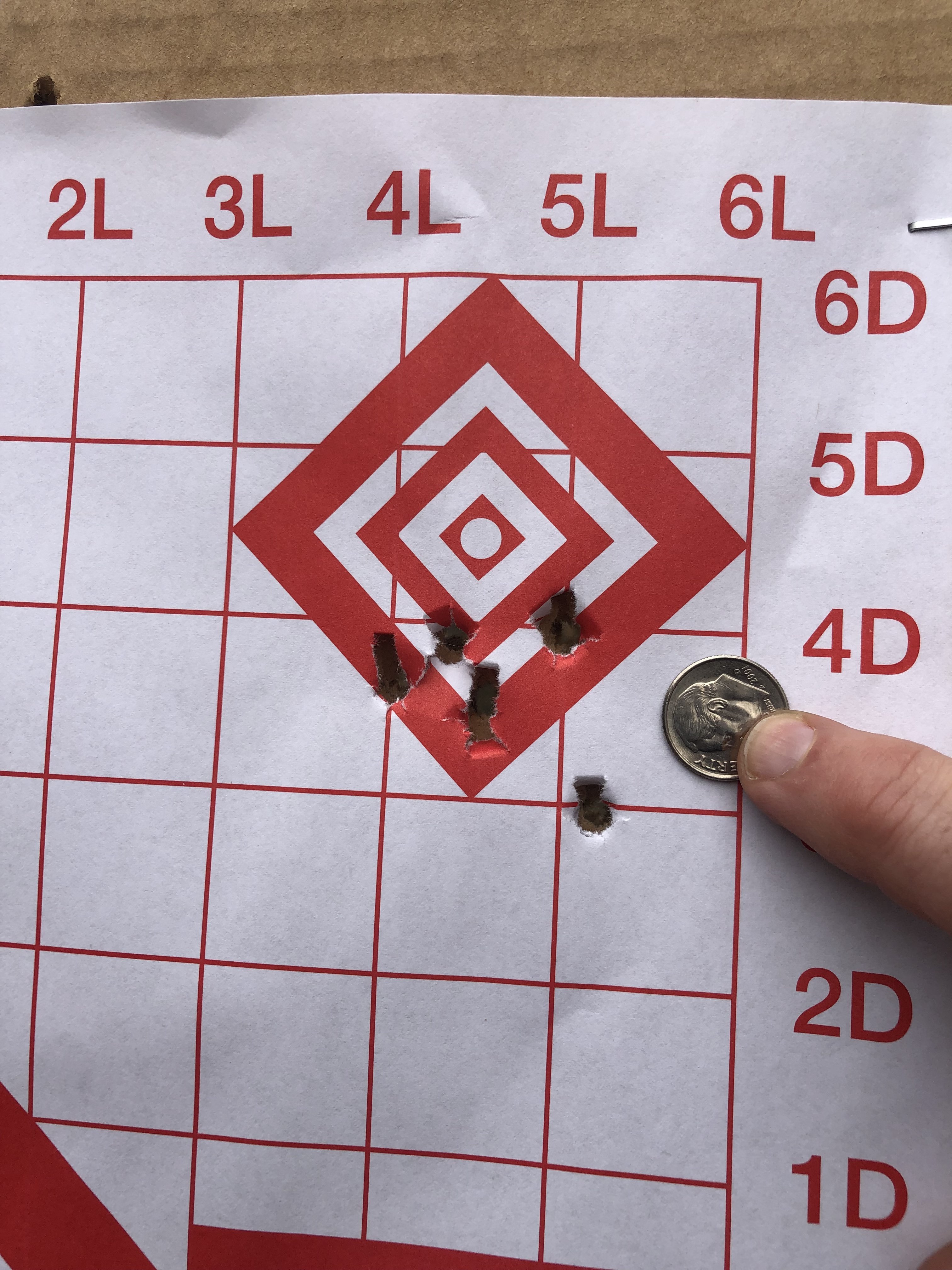

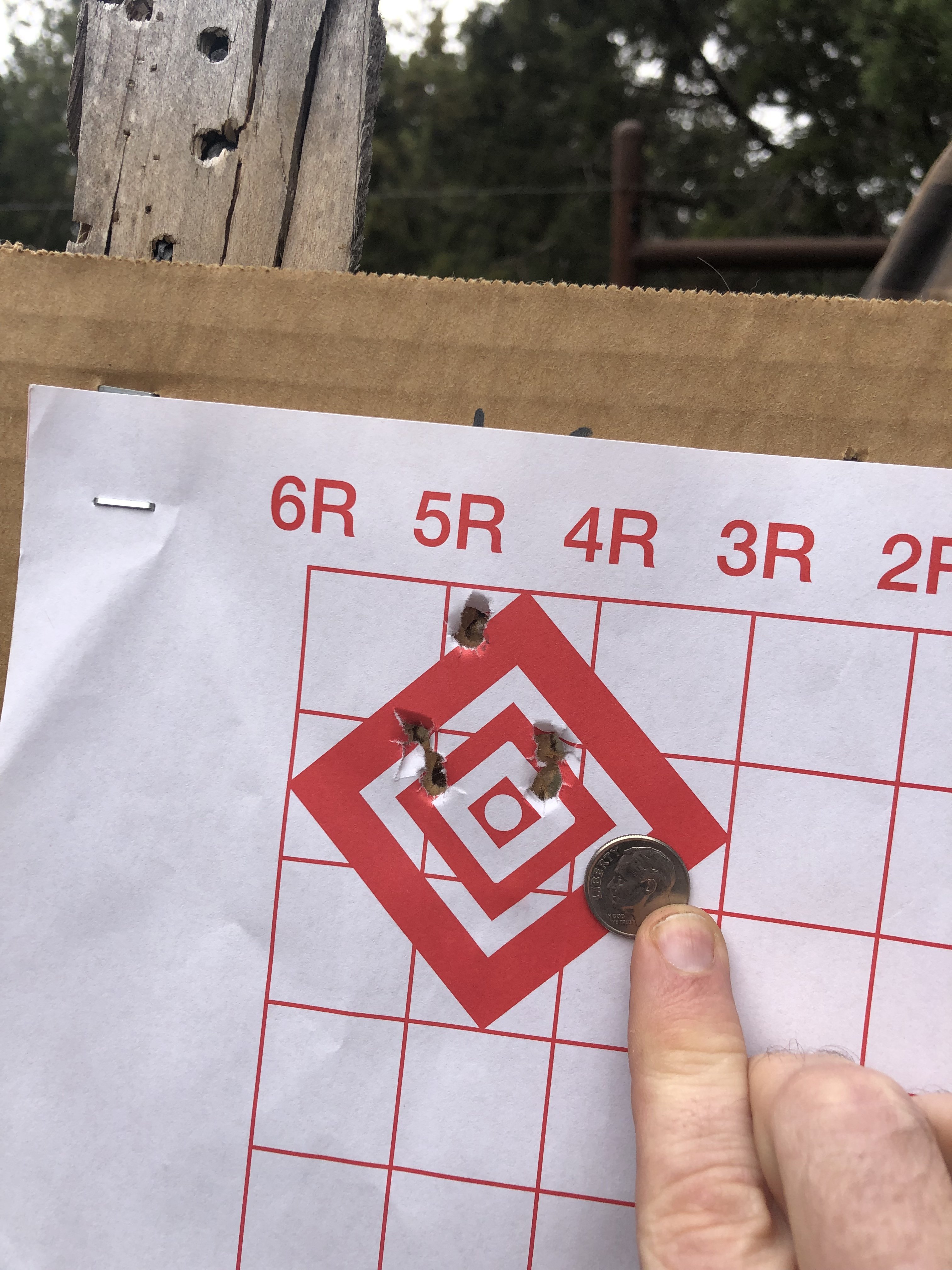

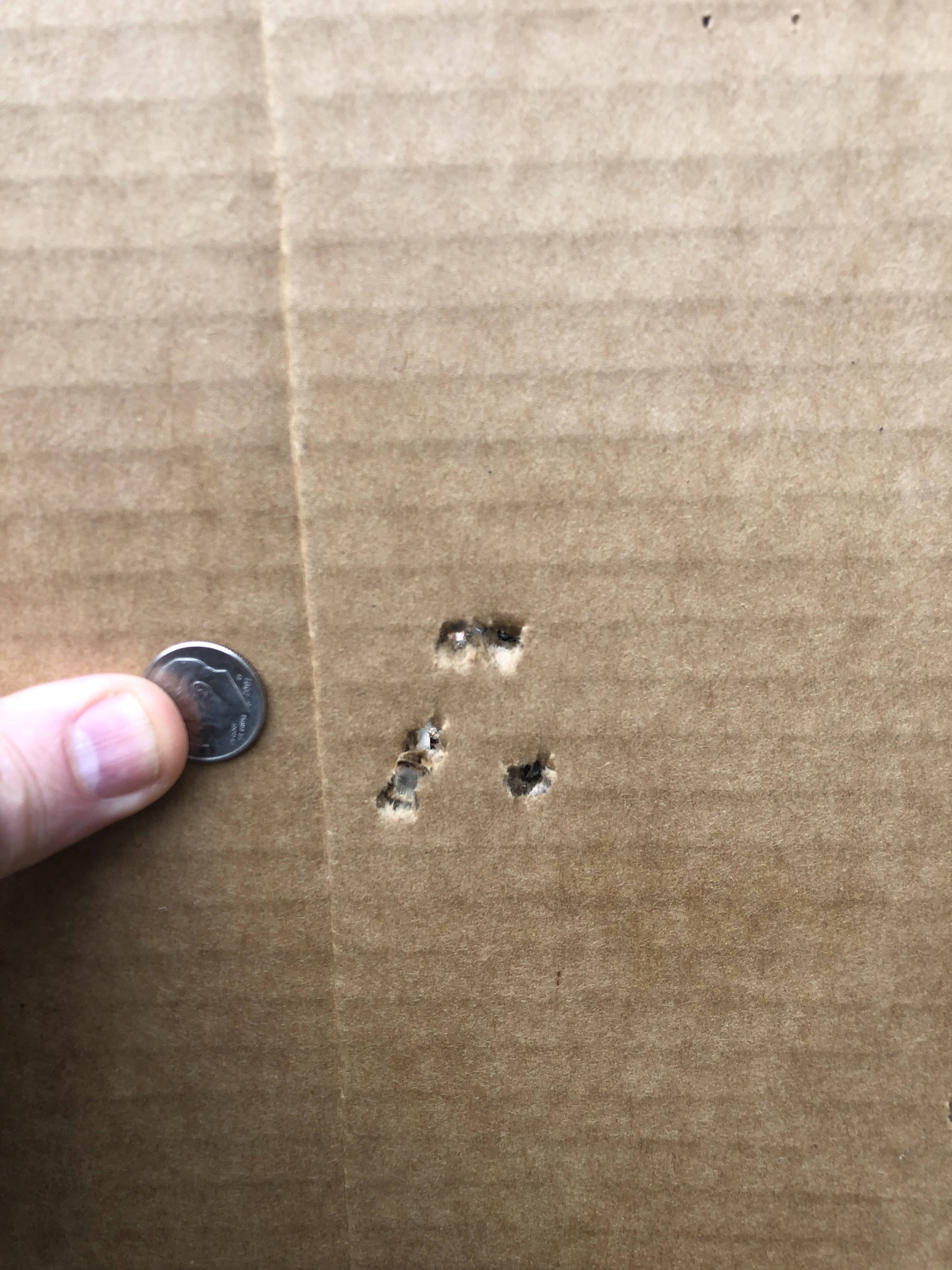

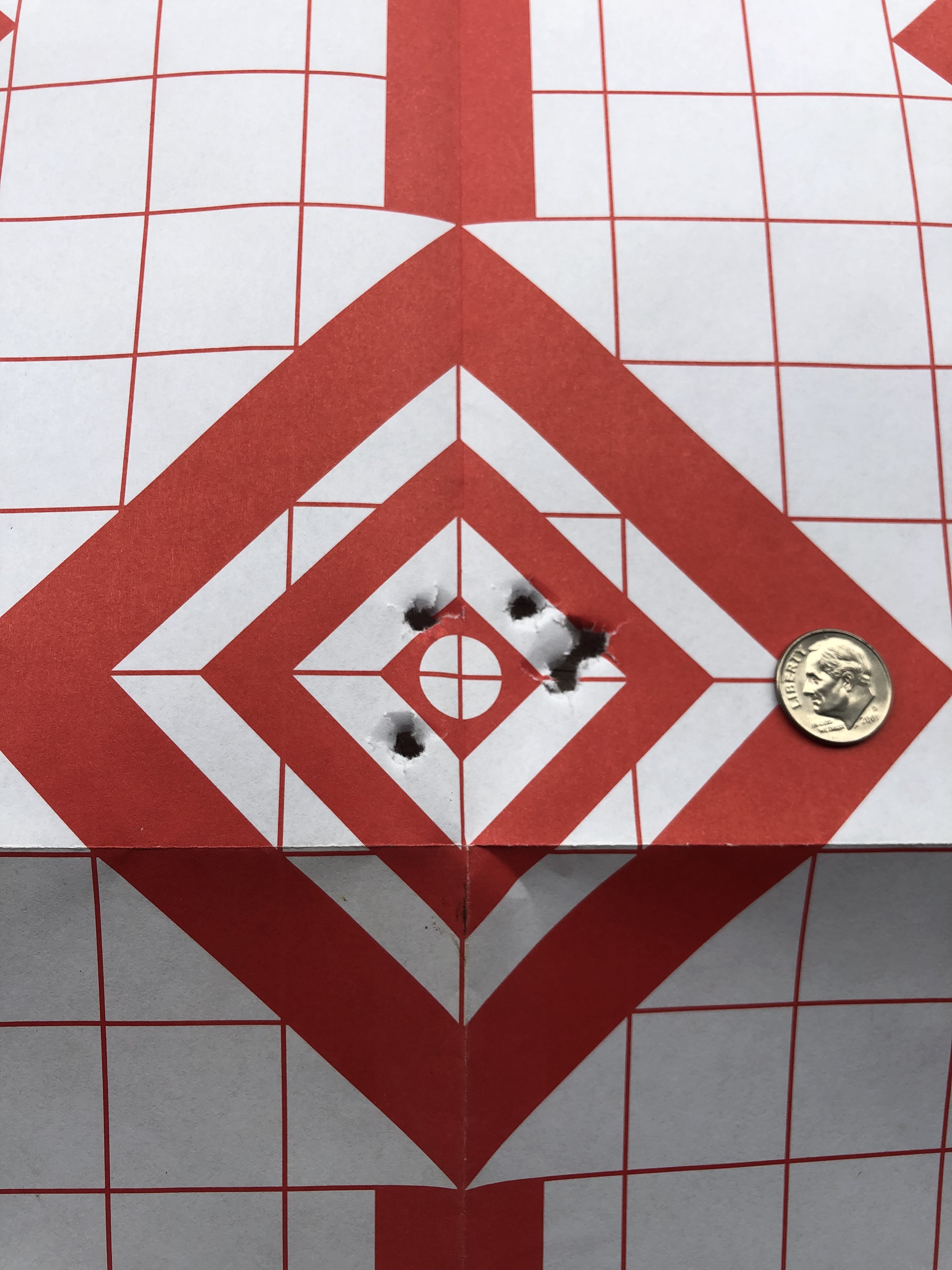

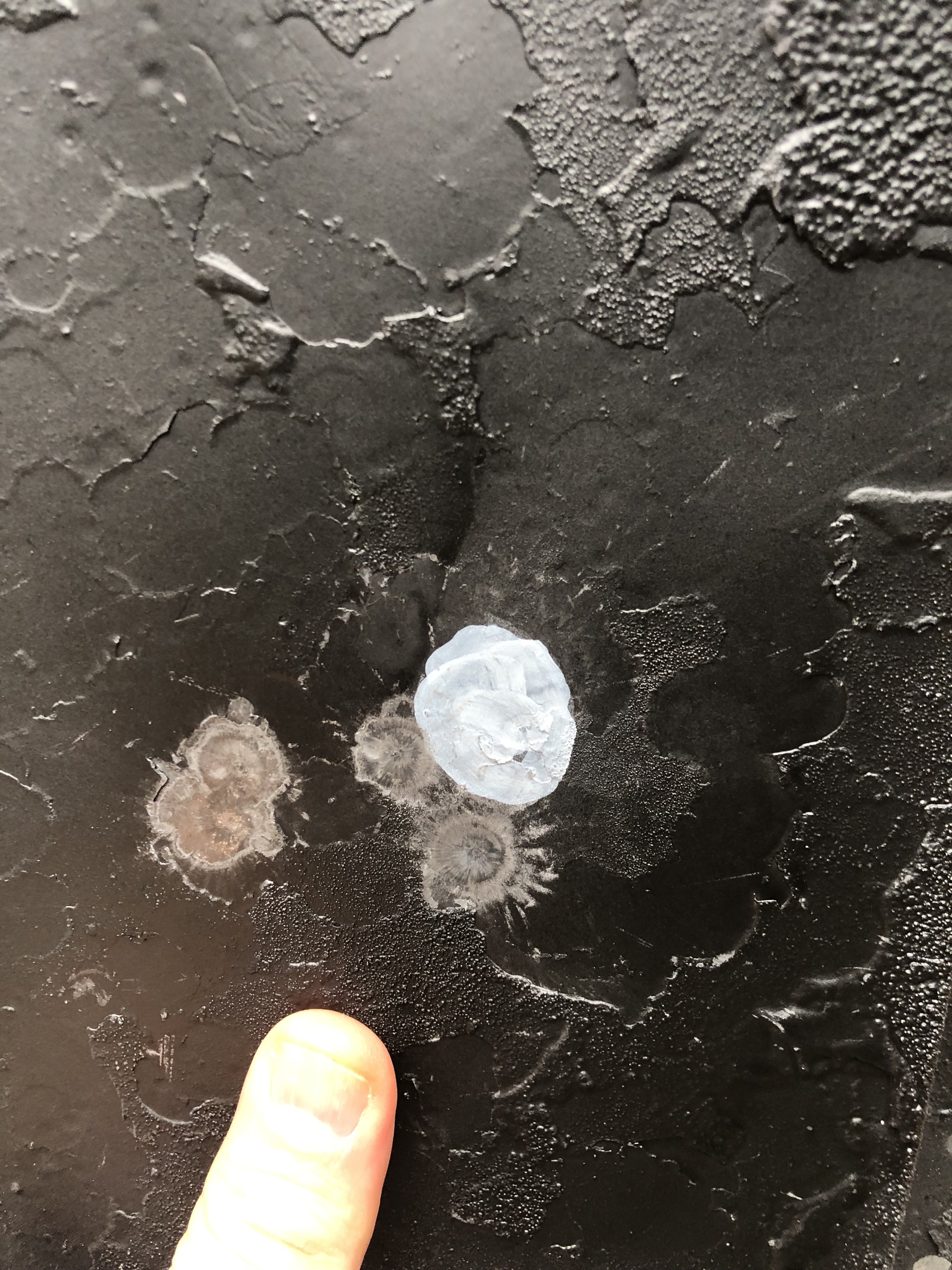

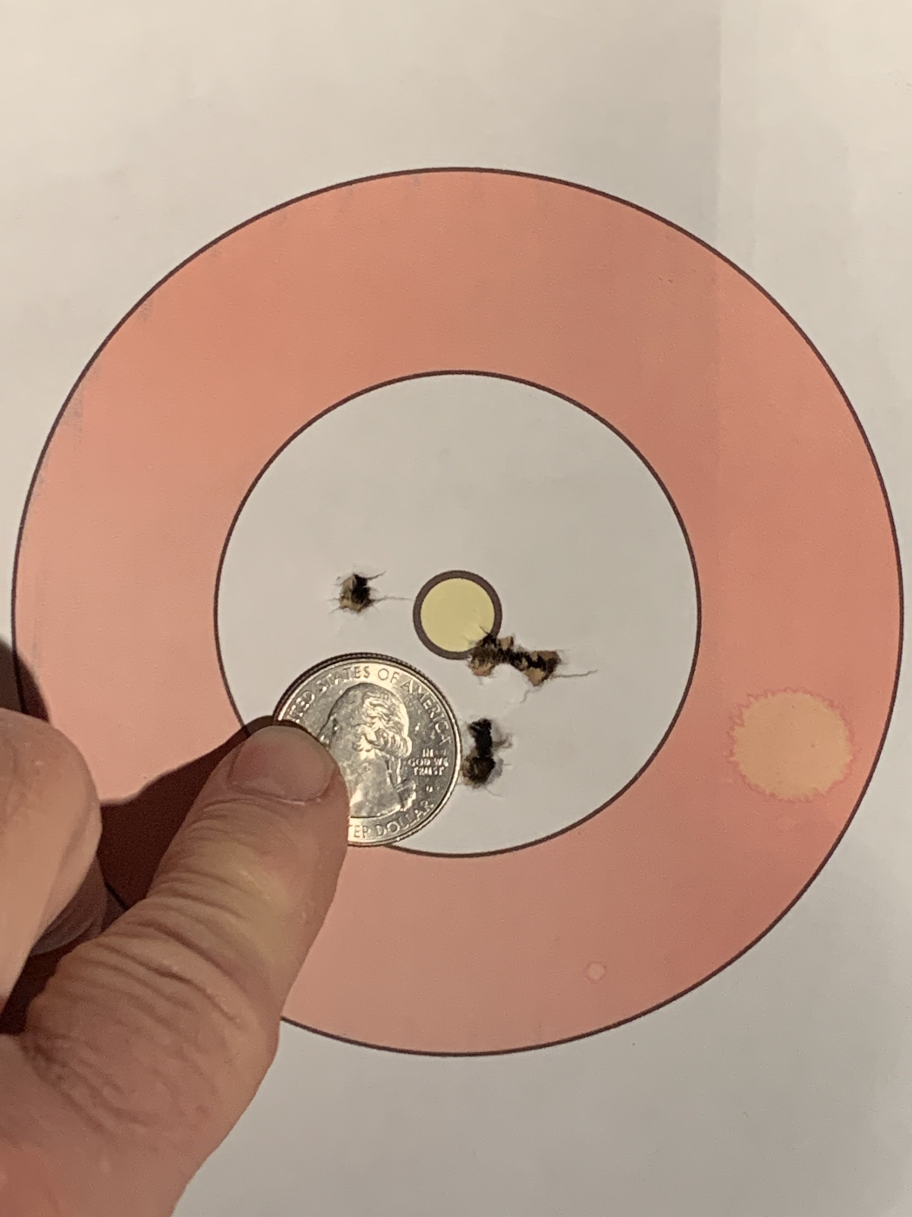

Black Max got the call to the bench first. Itā€™s very first 5 shots at 100 yards looked to be about an inch ctc. Foghorn followed with a good showing and similar accuracy. Spook shot steel at 100 first then paper and produced about the same 1ā€ ctc 5-shot groups.
This was all done with the 33.95gr JSBs. All produce the same power at 150 bar ~ 960 fps on Max (19) and 925-930 on 10. The firing cycle is nice, clean and easy on 10. I found 925 to 940 to produce great accuracy. Filling to 250 bar produced 55 regulated shots at 925 fps with the 33.95gr JSBs. SD was 3.6 fps and ES was 13 fps.
