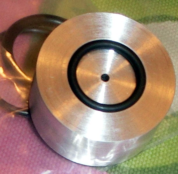

Hi All,
Finally got a regulator tester for the Edgun regulator. Turns out for about $140 delivered you can get one of the old style regulator testers for the old Edguns. While it will not work with the new style regulators, if you add a 0.538" thick spacer on the regulated side and put face seal o-rings on the faces of the spacer, it is good to go. On the tester side you need an OD on the o-ring of .75 or better (as the inside of the tester has a bump) and on the regulator side it just needs to be about .50" or better OD. Here is a picture of the spacer I used. It worked the first time. My "mechanical guess" based on measurements and turns of the adjuster was only 10 bar from my desired set-point.
