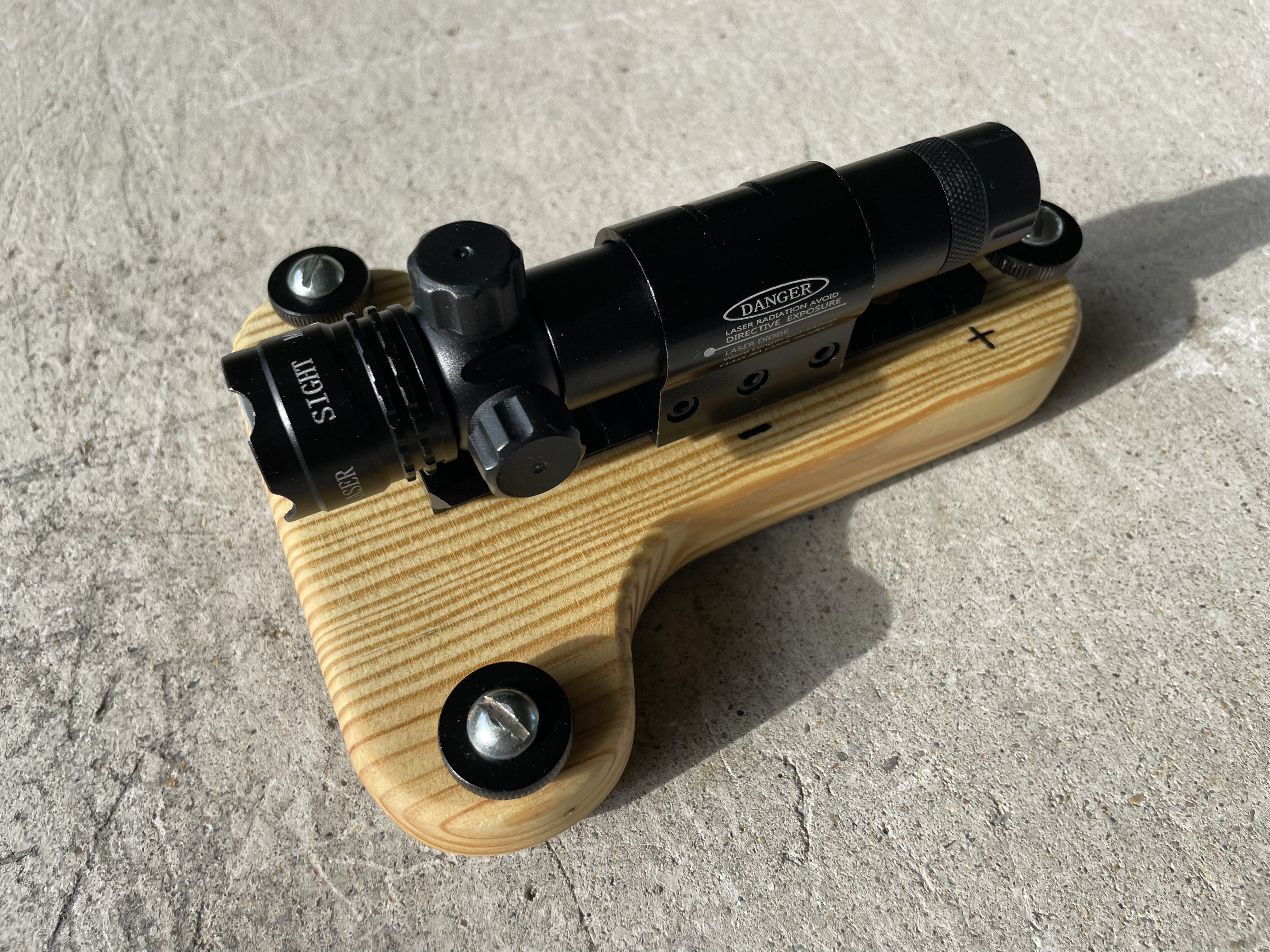

We bought a $18 GREEN laser pointer off of FleaBay but I assume Amazon sells them too. Then mounted it to a 3 point adjustable base. Set the base next to your rifle, on the bench, and point it to your target. Walk out to where you want to position your flag and stand in front of the laser until you find the dot on your chest then position your flag just below the laser. Below is a link to the one I bought.

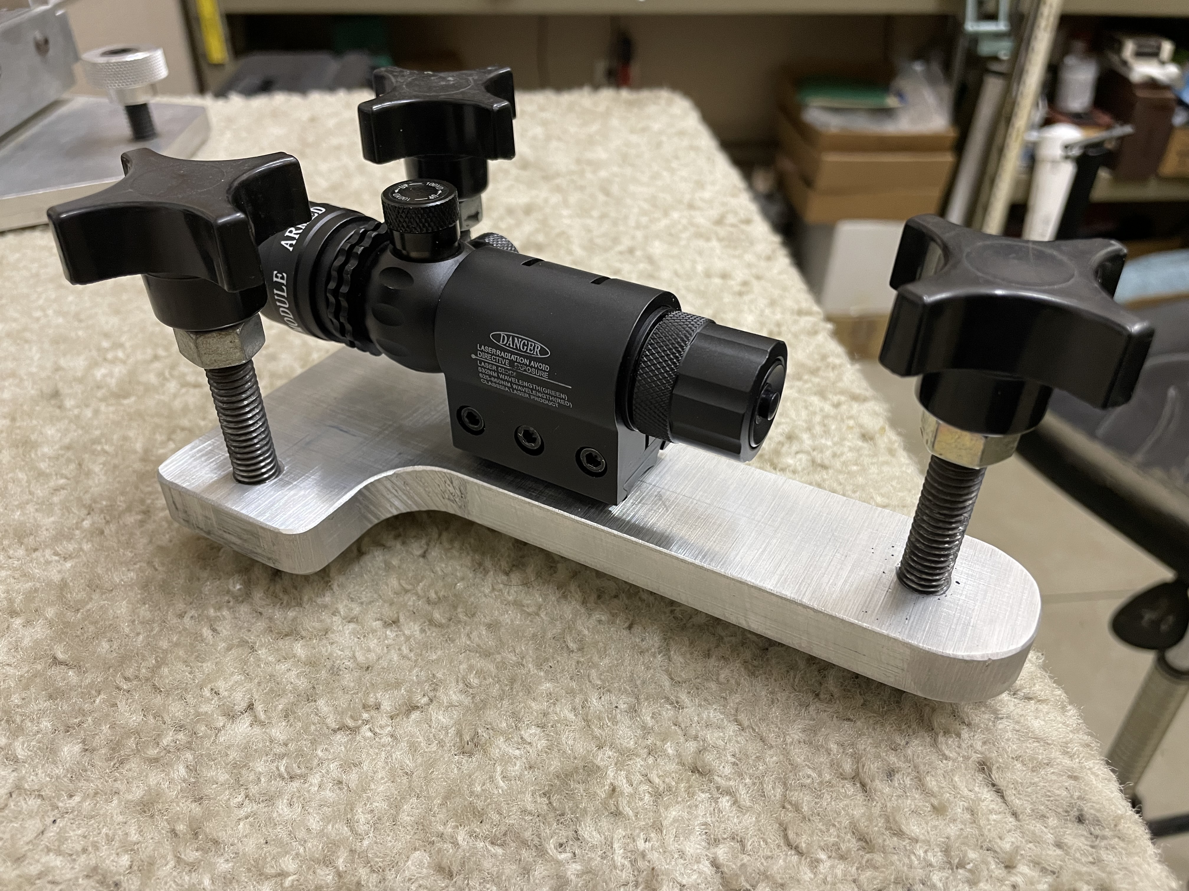

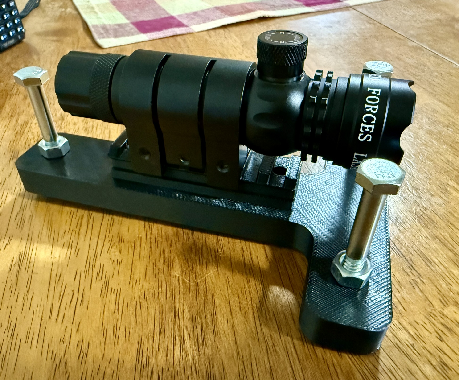

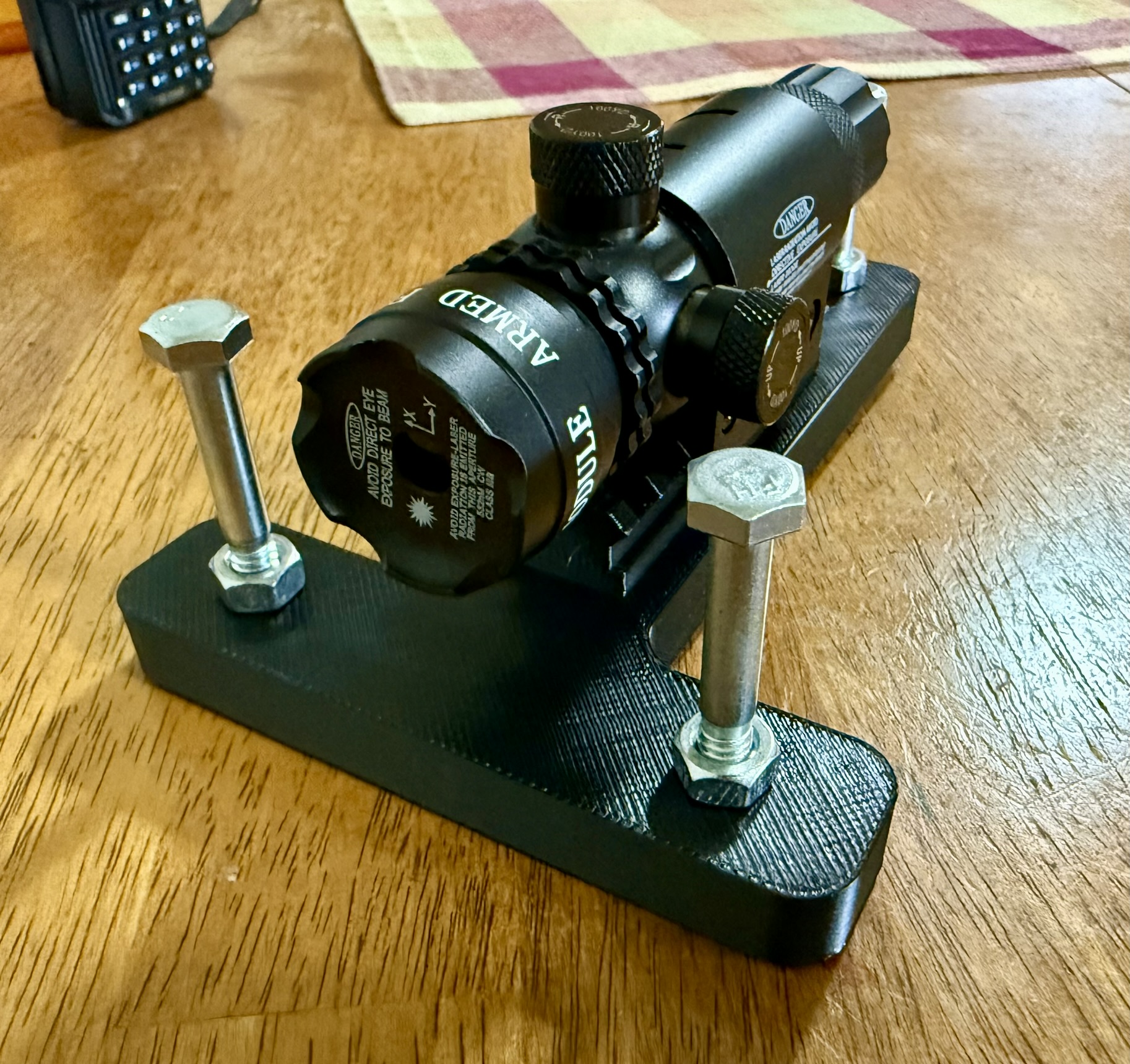

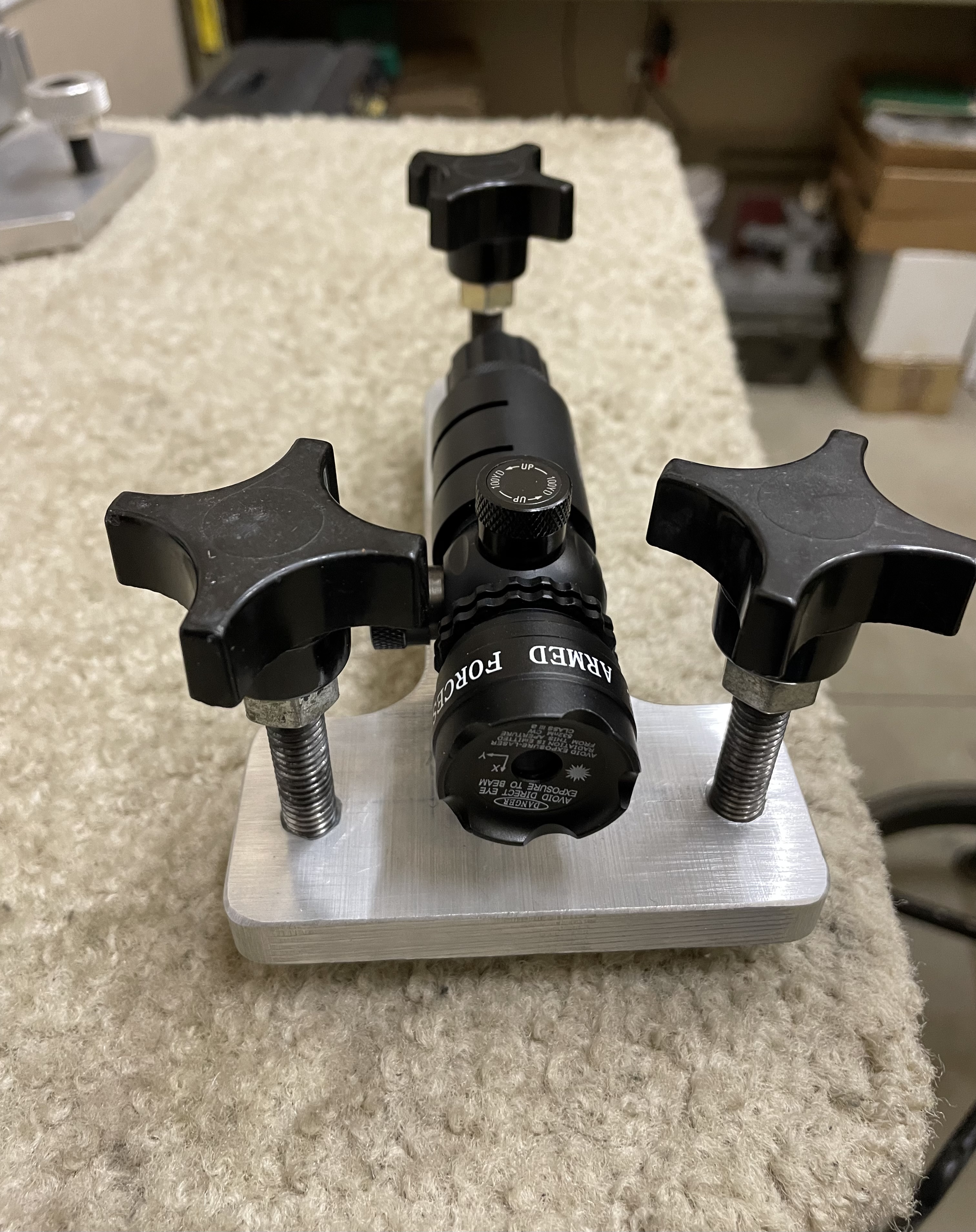

@Buckeye68 has a much higher tech aluminum base. Perhaps he will post a picture of his?
