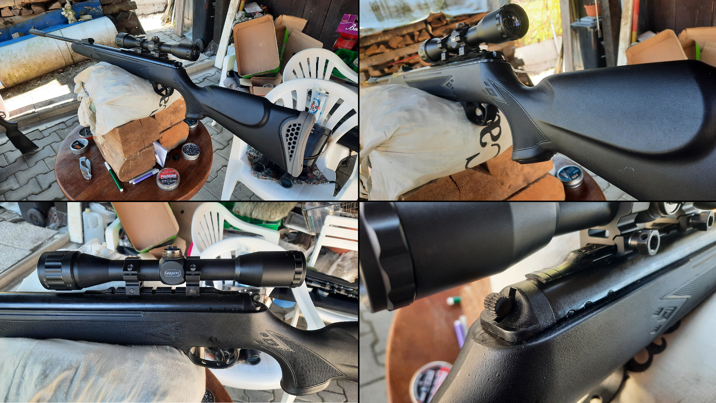

The Hatsan 125 - Standard, fitted with a Leapers 4x32 AO:
I like the safety switch too, it works like a real hammer on a powder burner, although its travel is rather short.
When I was out shopping for a Hatsan, I decided to go with the regular stocked version, with just the plain "Monte-Carlo" styled plastic stock, as I liked the simplest variant the most, apart from the other two, the thumbhole one and the Sniper variant. The gun is already heavy as it is (coming in at 7.9 pounds), so I didn't exactly want the extra weight of a heavy stock, such as that of the Sniper variant. Although I have to say, that the Sniper stock would certainly tame the harmonics of the recoil a little better (and therefore potentially increase some accuracy) than the regular version does, even though it comes with the SAS and the DynaPad, which I actually quite like, cause it's a nice looking and comfortable recoil pad. Nevertheless the recoil is still harsh, even with all of the rifle's dampening features, but the issue I'm still struggling with is in the severe hold sensitivity of the gun's stock, if I don't hold it in the same spot each and every time, the fliers start occuring on the target and the shots go all over the place. Some folks have suggested to simply lay the front end of the stock into an open palm and then the accuracy will improve... I have yet to try out different holds and grips, perhaps leaning the rifle onto the front end of the barrel will help out with the accuracy, who knows... :confused:

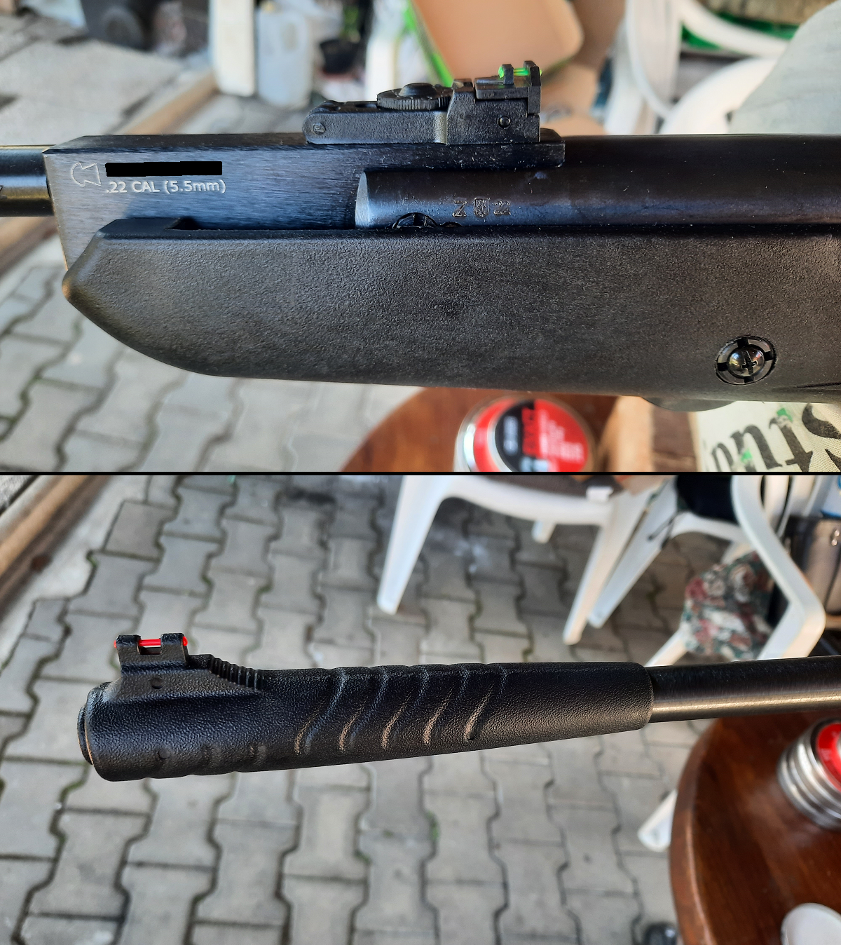

Speaking of barrels, I noticed that the TH version of the 125 has a hooded front sight at the end of the barrel (which is good), but a very short muzzle piece, which is a con, because it doesn't give you that extra, comfy leverage of the muzzle piece, that really comes in handy for cocking the gun. All in all, I like the standard version because of that more, than any other - it has the best properties of the other two and offers a good balance between shooting comfort and utility. Besides, I'm used to shooting guns with traditional stocks anyway, but I believe the TH version allows for a better grip.

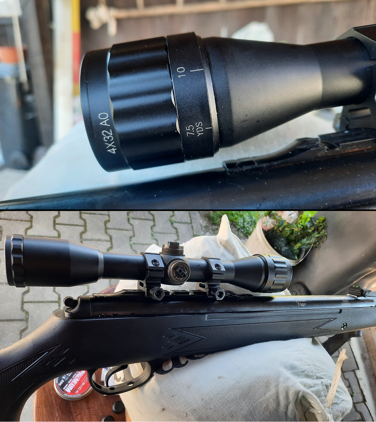

Right now, I've got a Leapers (the old Leapers, not UTG) 4x32 AO scope mounted on this gun, and before you guys start asking questions about it, yes, it's the one my friend gave away to me and surprisingly IT HOLDS ZERO, for when it was on my friends' gun, it had a loose reticle and only the lower half of the reticle stood in place, the upper one was jumping around, or otherwise flickering a bit. Apparently the shock of the recoil on this gun is so pronounced, that the momentum in which the lens flickers happens so quickly, that it's completely un-noticable. Anyway, I didn't send the scope back to UTG, because I wanted to find out what would happen, if I put a partially defective scope as such, on a magnum springer. And found out I have, it's amazing that the lens didn't fall off, or otherwise worked itself out of place by unthreading itself in its module/erector tube... Nevermind, it stopped flickering around and it holds zero. Good enough for me! Now, the mounts I used were two-piece, scope rings that came with the scope and they have a 22mm Weaver base, which is just perfect, because these newer Hatsans have dual-mounting rails, for both 1913 picc. mounts, or otherwise 22mm Weaver mounts, and for 11mm dovetails. The bases of the rings loosen up after some 50-70 shots, because of the guns' kick, and therefore have to be re-tightened every so many rounds.

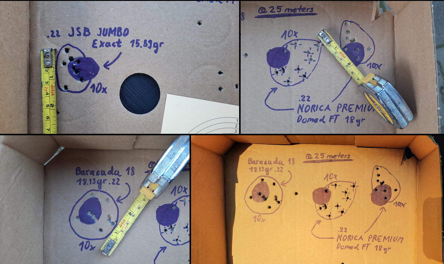

So far I've tried out the following pellets and two types of slugs: JSB Exact 5.52/53, H&N Baracuda 18, H&N 21gr Slugs, JSB KnockOut Slugs .216 (these don't work at all, probably not enough power for these), Norica PREMIUM 18gr and the Norica FIELD LINE, and I've somewhat determined that Norica 18 grainers and JSB Exacts, both 5.52/53 work pretty well, however I'm not exactly certain how the H&N slugs perform, haven't had enough of them through the gun yet...

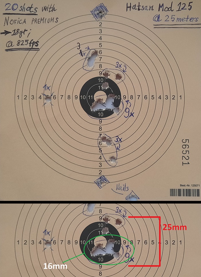

Here's the groups, and as I've stated up above, I haven't exactly figured out how to hold this thing right yet, it's pretty hold sensitive.
Experience will certainly yield better results, or perhaps they have already - I'm gettin' better, see... The 16mm central group speaks for itself, the gun can shoot, but only if the shooter is consistent, relaxed, and breathes the right way. If these conditions aren't met, then there are fliers;
11 shots in the black, the other 7 are just fliers, the gun works fine.
This target was set up on a pole, at 25 meters and there are 20 hits on it (all of the shots taken).

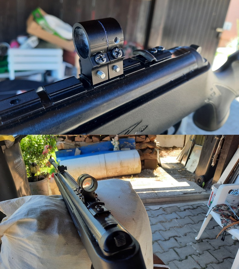

While I was browsing for a scope (in the end I got it from a friend), I came up with a terrible idea. The idea was to line up the top of the chevron with the red fiber-optic on the front post sight, in hopes of getting a point of reference... And as most of you would assume from the image beneath, it didn't work at all. What in the name of... was I thinking?! 🥴
Behold: The one and only, true slavic red-dot:
Even though it's cursed, it kind of looks cool innit?

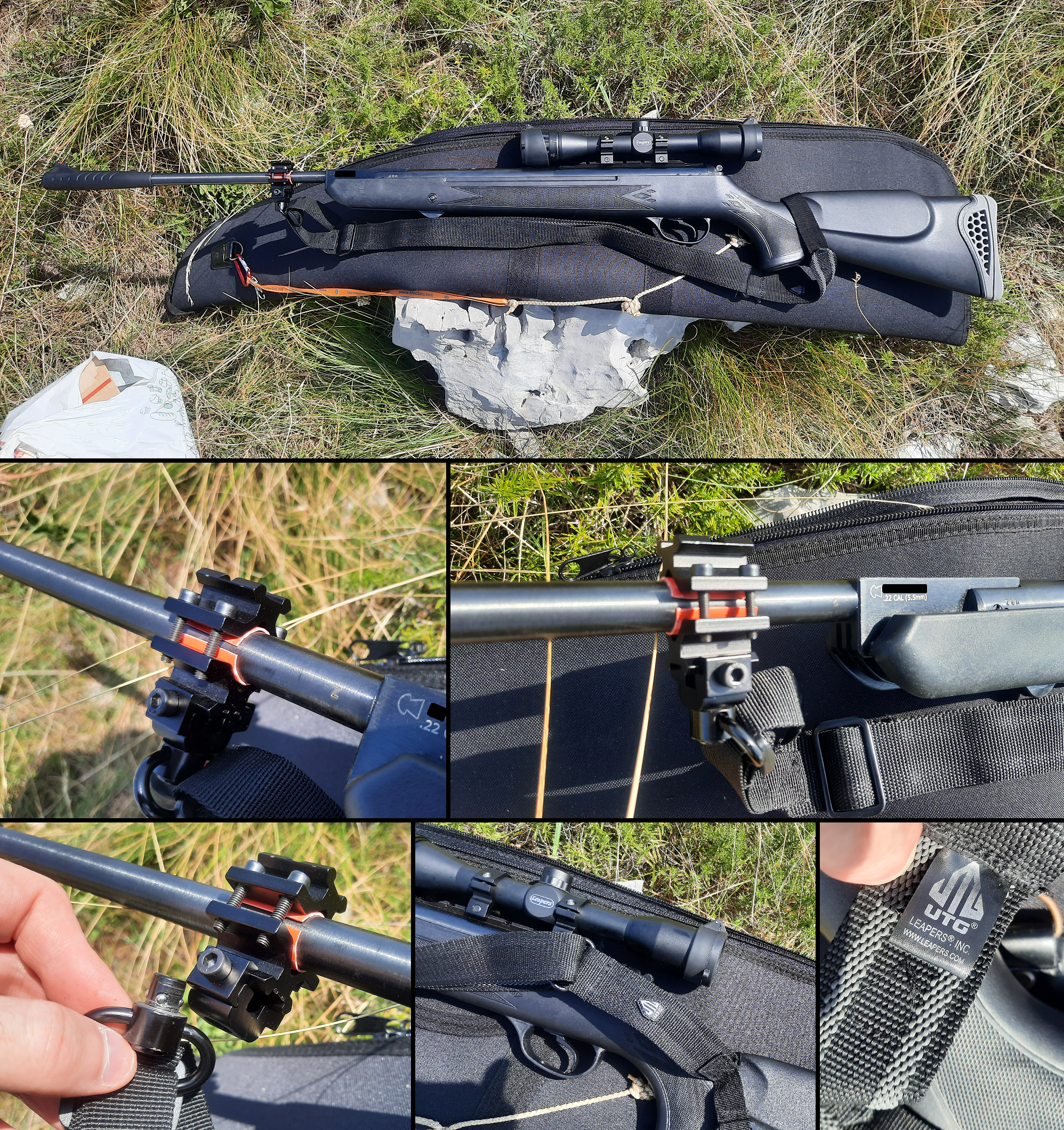

Like that barrel sling clamp assembly. I did a quick search but could not find it. Where did you get it? Before I thought the only way to put a sling on a gun without swivels was the Gamo loop around sling. Thanks for posting.
I got it here, but they don't have this two-sided rail model anymore... it just said NATO barrel mount/clamp - Weaver 22mm.
Your best bet would probably be Amazon or some gun store... I honestly don't know. You can try MidwayUSA too, they used to have these once.

The latch-action on the 125 is really stiff, no way it'd open when put on back.
Reactions: Hateful McNasty
I've got the.177 sniper version and I totally agree that it's not a good caliber for the 125. I have found it shoots jsb 10 grain knockouts pretty good and the barrel seems pretty tight. Cocking the thing is a chore but it's more of the motion needed as I'm use to cocking my Diana m48 which is almost the same cocking effort just in a different movement. I couldn't pass up the price as it's a referb so it was around half the price of a.22.
I did disconnect the sling on my HW 35E when shooting at home. Just easier to handle and takes out a variable if I accidentally set the gun on the sling. The HW 35E has a barrel lock so the sling works. I used a Gamo Slip-on Sling on my RWS 350 but it only worked carry the gun barrel pointed to the ground.
That's why I recommend attaching a good QD mount for a sling loop, on the barrel mount. So that you can take the QD key out and unattach the sling from the rifles' barrel, just as you've explained with your Weihrauch, when shooting at home.
