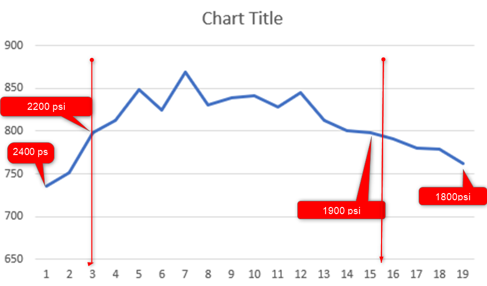

I just graphed out a 72-73fpe tune I JUUUSSSTTTT barely started working with, this data is from the first chrono session. This is a Condor SS .25 using cast MP molds .25/47.6grain slugs. This is without even sorting the slugs, they were still warm from the casting actually. So there are improvements to be had, in various ways.
Vertical axis is fps, horizontal axis is shot count. As-is, I'm looking at a fill pressure to 2200 psi, and refilling after 1900 but before I get to 1800 psi. From this prelim data I could expect 12-13 shots within that pressure window, starting at 798 fps, climbing up to 845-850, and then ending back around 800fps. So about a 50fps spread. The lone peak fps coincided with a slug that didn't fit like the rest, so some sizing and sorting by weight will tighten this up. I also need to use a different transfer port jet and probably dial in some hammer tension. Going down in port size seems to have a bit of a regulating-like effect for non-regulated PCPs.
Just an example. In a lot of ways I prefer working with unregulated. I know dang sure the regulator isn't ever acting up in my USFT and 1720T and Disco before I sold it, and Condor, etc.

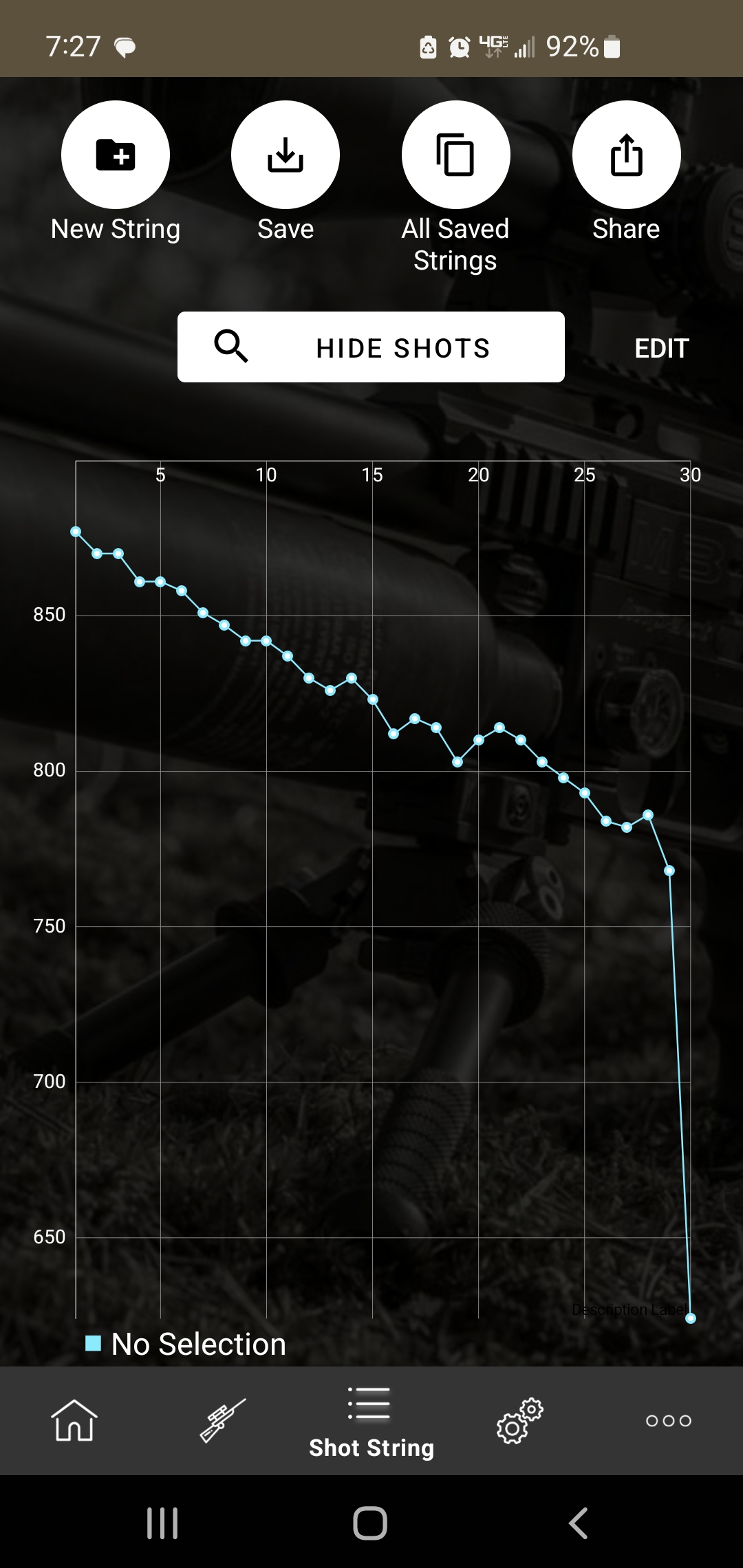

I own two, and wouldn't call myself particularly proficient at it. My mrod got hammer and transfer adjustments until shot 1 was as similar to shot 16 (25 cal and looking for most useable power). I would say your tune looks pretty good if poi shift isn't a big problem.
My aea, I stumbled on something. I don't fill it as far as others do because that gun gets left in the hot sun pretty often. I bottle converted it and turned the transfer closed maybe 40% and just having more air fixed a lot of what I hated about that gun. Back fired pellets, short shot count with a lot of data movement. 330cc bottle fixed all of that. For the guns intended purpose, I can handle a consistent slow downtrend and the shot count is 1 fill with acceptable poi shift for its job(ground squirrels)
Your numbers look like something pretty good to me that could be refined over time as you notice more of its personality. Nice work op!
