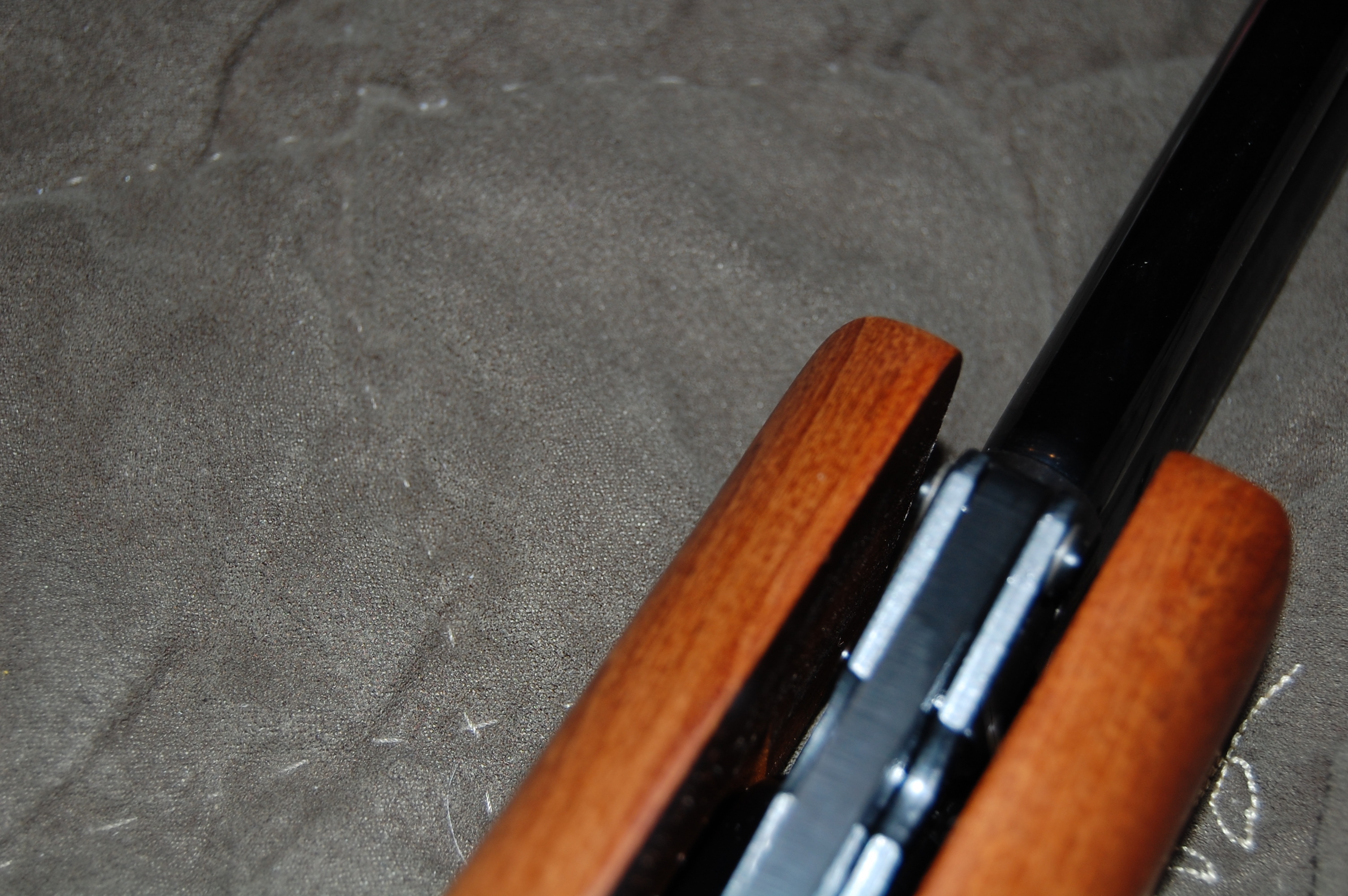

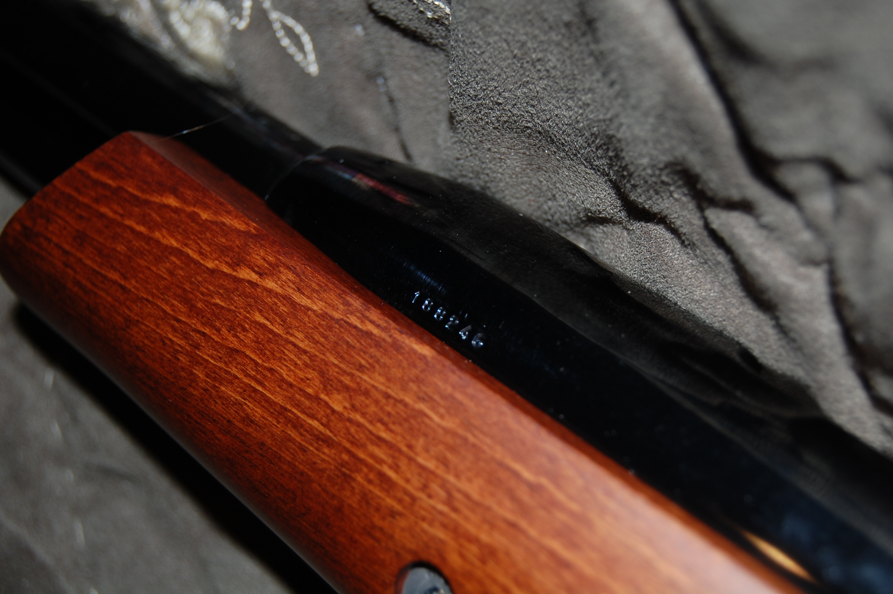

I found this to be an unsettling (shock) find on a NEW TX200HC in the year 2023. Even when the cocking lever is secured, that linkage arm will rattle from side to side with little motion effort on shaking the rifle. This is the first easily seen joint and visibly seen movement. Have to say, on a hunter model with this much said quality and cosmetic effort. why the loose tolerance here? Makes me appreciate other spring rifles I've handled such as the HW77 & 77K, HW97K and a number of HW and Diana break barrels. How did those lower cost rifles keep their linkages from rattling?

Spacers, shims, resizing holes etc to remove the play. Unfortunately these are mass produced and on ocassion a couple parts might be on the high/ low side of the tolerance.
Slight rattle on a second try in the refurbished/used TX200HC category, but its not as bad but still present. Might try to push some grease in the joint or send the rifle off to someone who can properly go through the rifle and maybe shim. IMHO, this should not be present at all in today's manufacturing processes and quality control - dealt . Cheaper springer air rifles get the job done with out loose rattling so a few others figured out how to do it. I have handled a total of 5 TX200's over the past 2 years. 3 TX200 standard did not have this loose arm joint. 2 TX200HC have the loose arm joint. Maybe its the angle difference of the shorter cocking lever & arm. Seems out of place on this higher tier springer compared to the rest.

The linkage SHOULD NEVER BE LOOSE / RATTLE when in battery .... The sliding breech and it making a seal against the barrel requires that when cocking lever is put into battery ( locked up ) there is tension of the sliding breech & linkage being lightly against the barrel.
If / when linkage is loose you have a breech o-ring leak during the initial firing cycle. * That being when piston first starts moving compressing air some is leaking out & not until compression ramps up is compression tube/breech forced to move forward, seal the leak, build pressure on remaining stroke and then launch a pellet.
FYI ...
Number of them with the issue, so I'm leaning to loose machine tolerances based on my observations of the linkage - just different degrees of side to side play. Few youtube videos also mention the issue. A review video describes the rattle. A tuning video shows putting little shims in to take care of the issue of some side to side slop. So either AA is sloppy or there are a lot of TX200 air rifles that are defective. My take at this point is sloppy or could have better tolerances where the arm meets into the cocking arm pivot point. Not sending my refurbished TX200HC back at this point, will live with the slight side to side rattle or send off to a tuner. May try pushing a little axle grease in the grooves. It is what it is...but really liking the balance and stock grip, not so much the short little cocking lever (LOL). Thanks everyone for the input.
