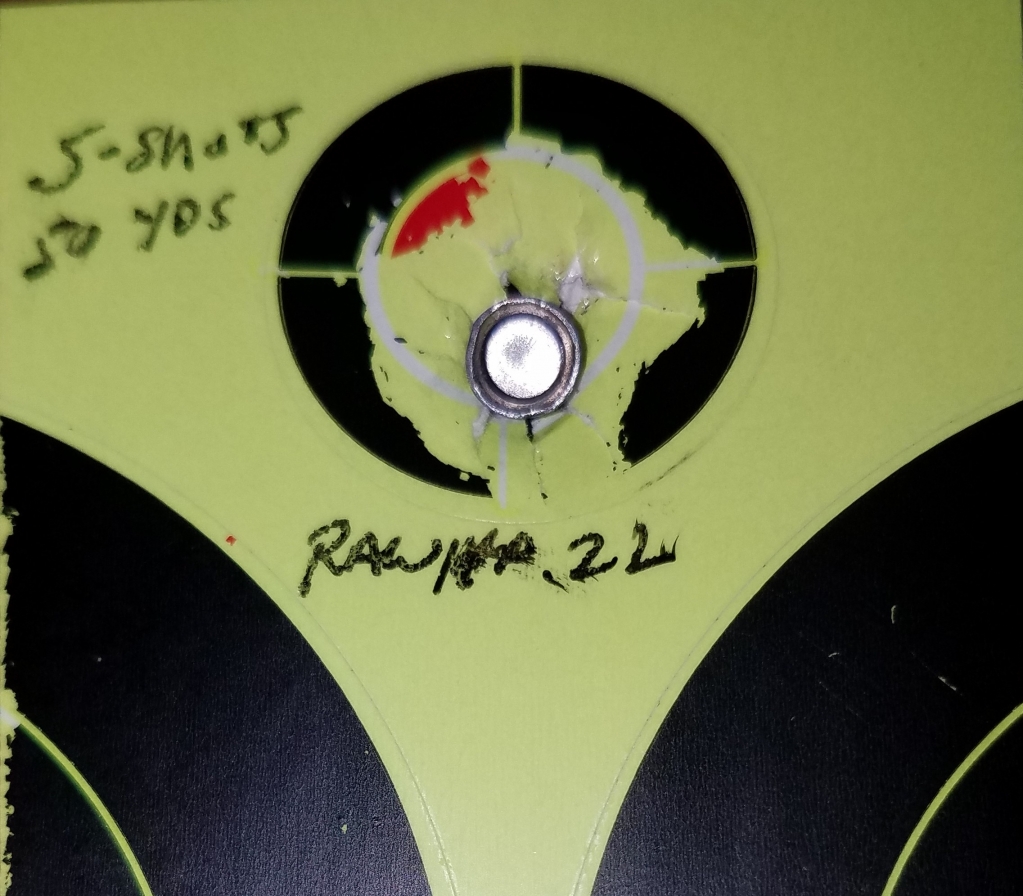

My RAW HP .22 regulator is set at 150 bar and shoots 935 fps for best group results (over 950 fps I get flyers). In 70f plus I can get about 40 shots per fill. Below is 5-shots at 50 yards - true one hole group.

Stan - I think I saw this true one hole group on the “what does one hole mean to you” thread. Amazingly accurate and it’s helpful to get a second opinion/comparison on the 935 FPS sweet spot for your RAW.
