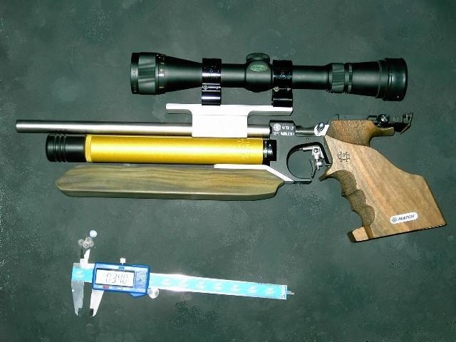

Speaking more airgun specifically, here is a five-shot group measuring .34" center-to-center shot with an air pistol... at FIFTY YARDS.
I have never really been into air pistols, but that one right there is a game changer! Very cool 👍
