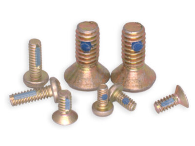

https://www.saftlok.com/stl/Pre-Applied_Threadsealant.htm

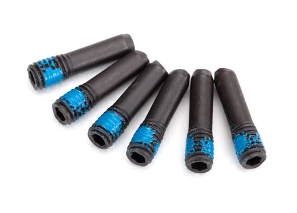

Can anyone tell me what kind of pre-applied threadlocker e.g. Traxxas uses on their screws? That holds tight but doesn't lock up completely, and stays flexible and makes adjustments possible over time? It doesn't look like LocTite supplies any of this type of threadlocker, but clearly someone does. Anyone know or have any suggestions?
