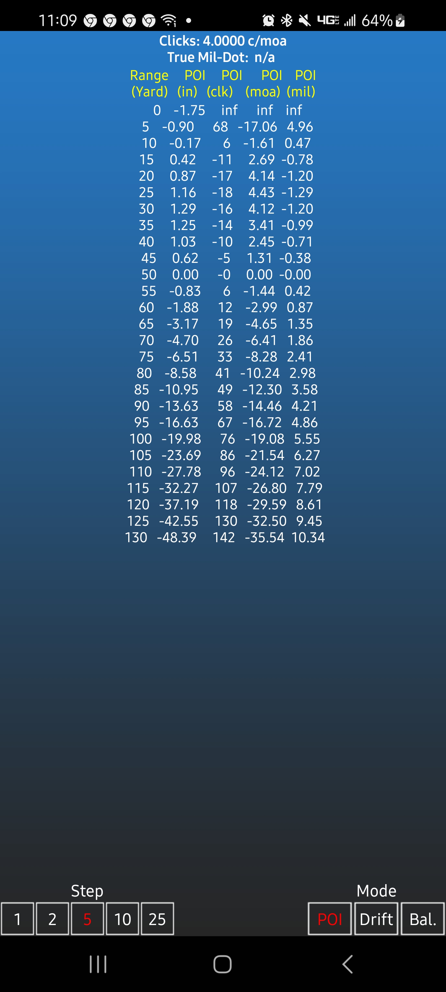

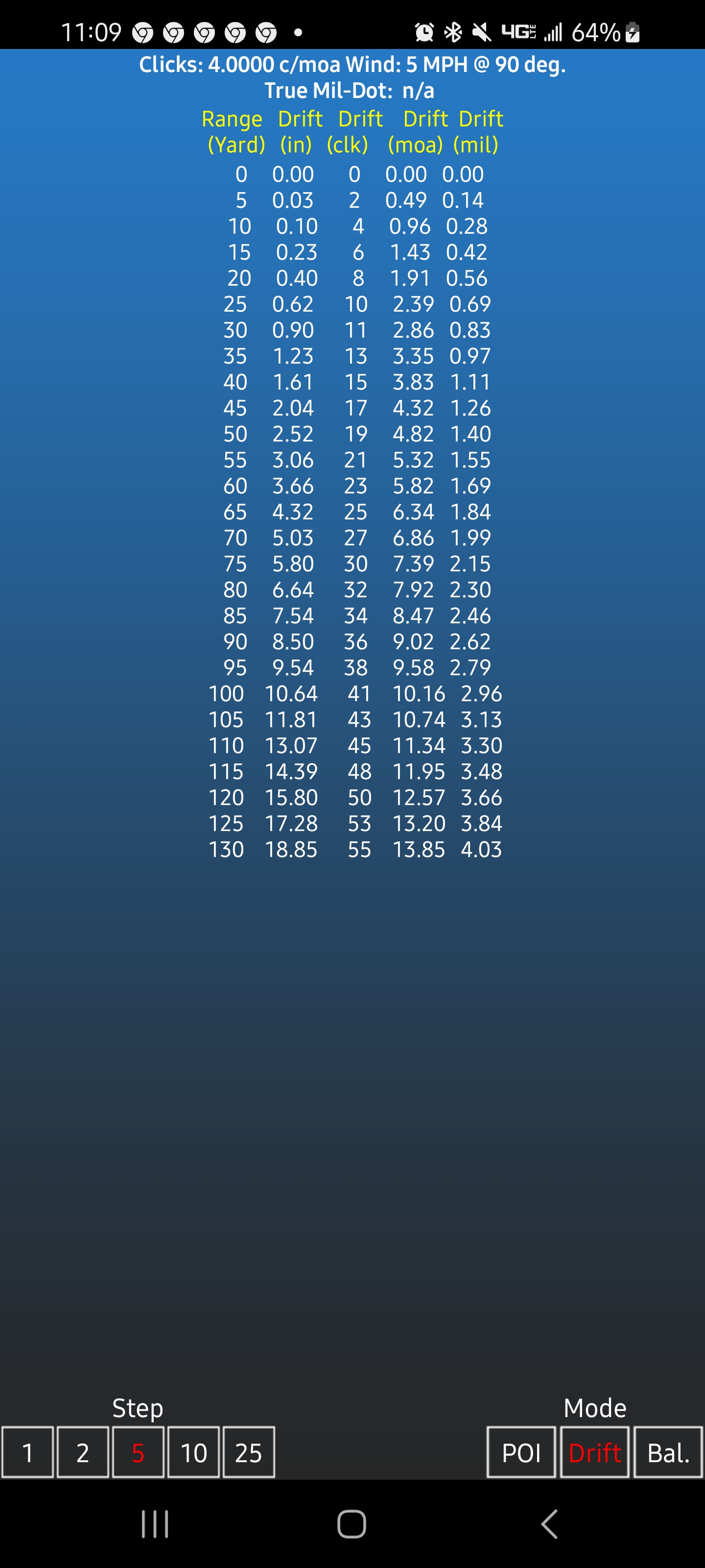

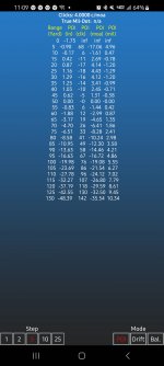

It is a kill zone and ballistics review. Look at the kill zone for each quarry. Then use the ballistics charts to look at drop and wind drift. 5 mph 90° wind. When drop and/or drift exceed kill zone the shooter becomes the most important even if the rifle is perfect (none are). Add the group size each ammo/rifle is capable of at that range and it layers on the added luck factor.
So using my TX200 as an example. Sighted in at 50 yards. Average group .75" (.40 to 1.0 common range). Kill zone is a head shot 1". So for drop... under 40 or over 60 requires shooter skill.
With a 5 mph wind... anything over 35 yards is shooter skill.
As 1" is about the group size at 50 yards... a good deal of luck plays a role anything over 50 yards.
