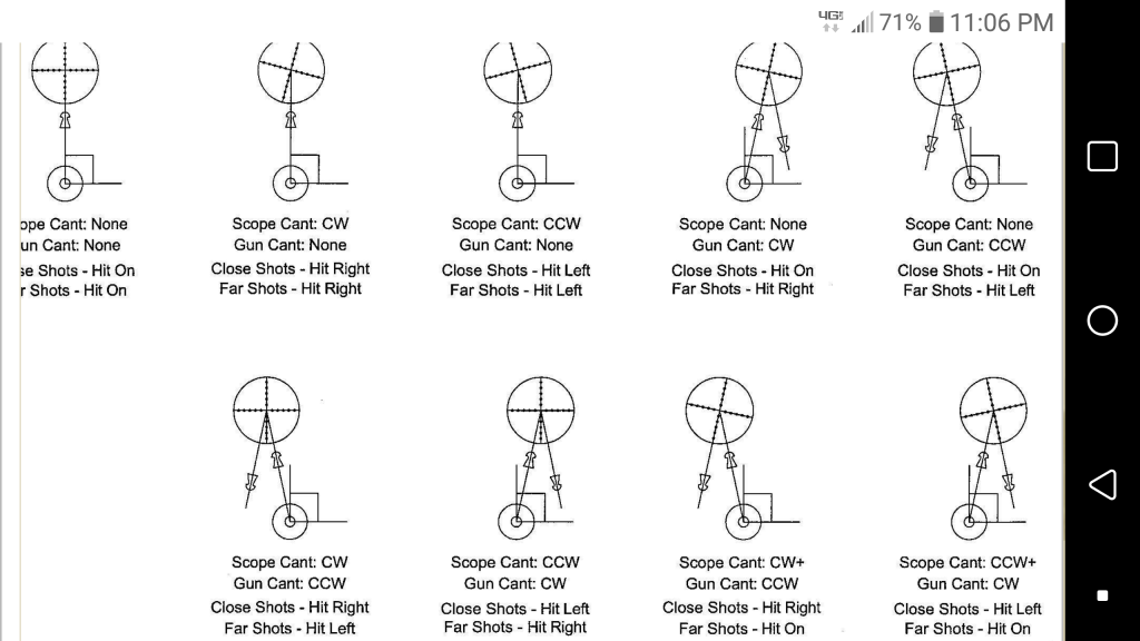

Need to make sure the scope is level and centered with respect to the bore as well. This is a guide to (scope and/or gun) cant related errors with respect to unexpected POI for distances closer and farther than the distance your scope is zeroed:

Please note that using wedges or bubble levels on the scope turrets makes a variety of assumptions about the perfectness of machining and assembly features that may or may not be true. Most of the time the result will be better than just eyeballing it but if you want to be sure the scope is installed correctly, use a laser boresighter or a mirror to center the vertical bar of the reticle with the bore.
Everyone has a mirror but perhaps not a laser boresighter so let's go over the mirror method for installing a scope and then how to install a level. First let's establish that the requirements to eliminate cant error are two-fold:
1. Align the scope's reticle with the rifle's barrel.
2. Hold the reticle level when shooting.
Item 1 deals with scope cant…i.e. mounting the scope incorrectly.
Item 2 deals with gun cant…i.e. holding the gun incorrectly.
To correctly align the scope to the barrel, set up a mirror at a distance of, say, 5 yards and set your AO to 10 yards. Look through the scope at your reflection in the mirror. Twist the scope in the mounts until the vertical bar of the reticle simultaneously bisects both the muzzle and objective bell. Then lock it down. At this point you have eliminated scope cant (item 1). If it's hard to see your muzzle, add a little dot of White Out or take a dot from a hole punch and tape it to the muzzle with clear tape.
Now to eliminate rifle cant, install and use a level. View a known good plumb line (e.g. hanging string) through the scope and orient the rifle so it precisely aligns to it. Now affix your level so it shows level. From now on when you're shooting, hold the rifle so it shows level and you can be sure you've eliminated both potential sources of cant error.
By the way, don't buy a level that attaches to the scope rail. There is no guarantee it will show level. Instead, get one that attaches to the scope tube so you can rotate it and lock it down where it shows proper level with a plumb line.
