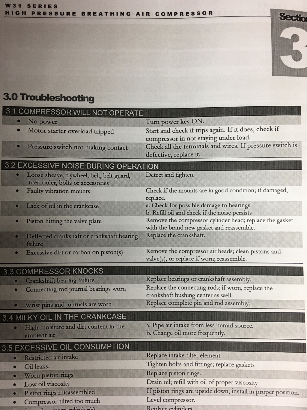

Page 47 sections 3.2 & 3.3
This is what will happen if people run it with the stages open for long periods of time.
The initial break in of 25 minutes should be done with 1st, 2nd stage close and 3rd stage fill wide open just blowing air.
There's specific instructions for most anything & I'm just pointing out how to avoid the repairs that might be required.

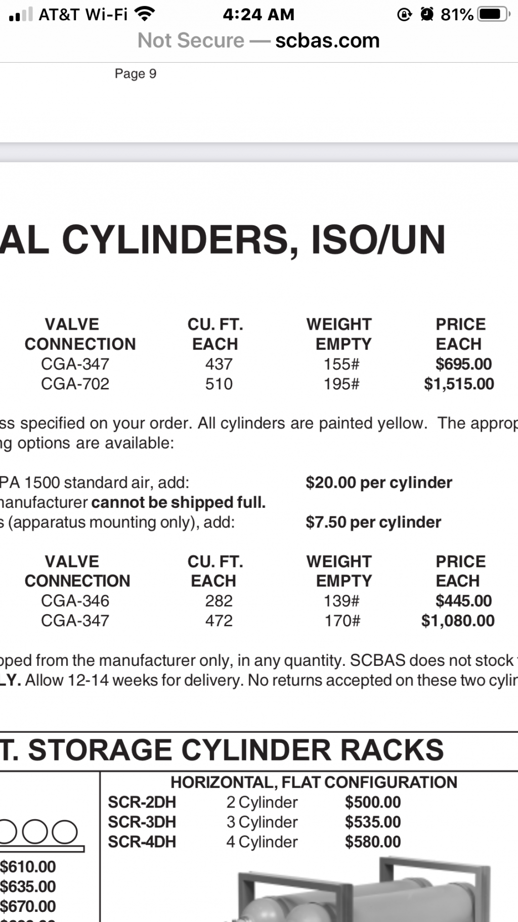

I like PerkyVal's extra oil/water towers. As someone said when those big 282cf bottles are depressurized add 2lbs of desiccant beads in each and a litmus strip test every so often will guarantee the driest purest HPA available. The only thing better is Nitrogen and from what I've found the cost would exceed a Alkin W32E within 5-10 years.
With a set up like hers I wouldn't even consider renting Nitrogen.
