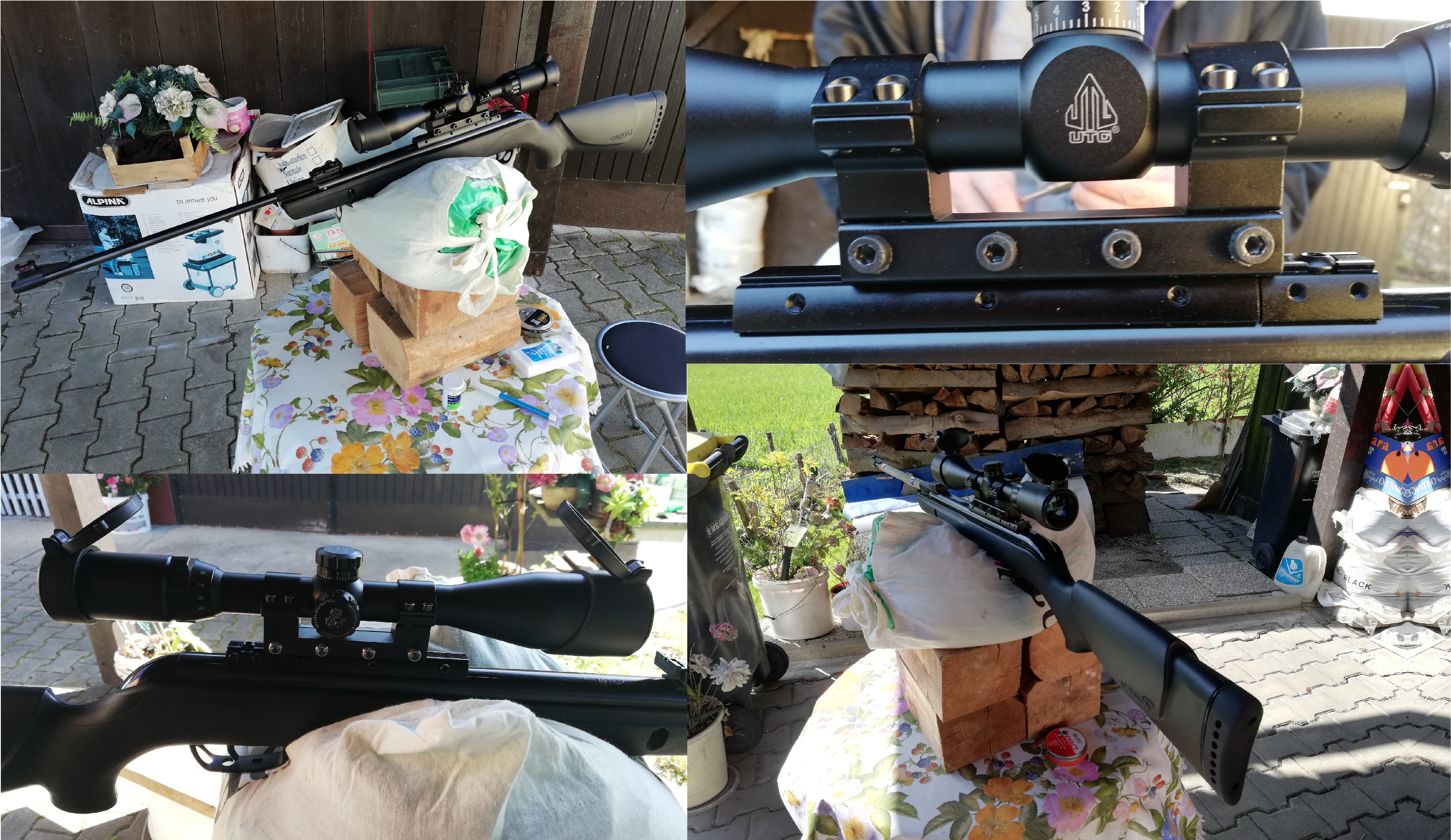

As I've already stated, I got this springer brand new, back in early 2019, half a year after my Cometa 300 blew up and as soon as I got it, I put a Gamo RRR (Recoil-Reducing-Rail) on the dovetail and on it, a UTG-Leapers 3-9x42mm scope. I already knew by then, that the UTG scopes are very robust and nearly all of them are springer rated, but just in case, I also decided to put the Gamo's RRR on it, so that the zero would truly be 100% unaffected by possible hardware malfunctions caused by the two-way recoil. Anyway, over time I took the RRR off, as it only raised the POI beyond the scope's extent of adjustment. It really made no difference at all in relation to the longevity of the scope, the scope still works to this day...
I hear people, such as the "Cyclops" hate on the UTG's scopes all the time, because of their "monochromatic offset" and "non-linear" adjustment/tracking, but the fact of the matter is, that they're decent entry level scopes, that hold their zero firmly! And that is also all I wanted from an airgun scope;
Sure, it's no Hawke, but it HOLDS ITS ZERO!!!
I've had my scopes eaten up by springers and the Leapers scope was and still is, the one that still holds its zero, even though I've had it on 3 different guns already, that have together shot in-excess of 3000 pellets. Alright, enough about the scope... Here are some pictures of the gun:

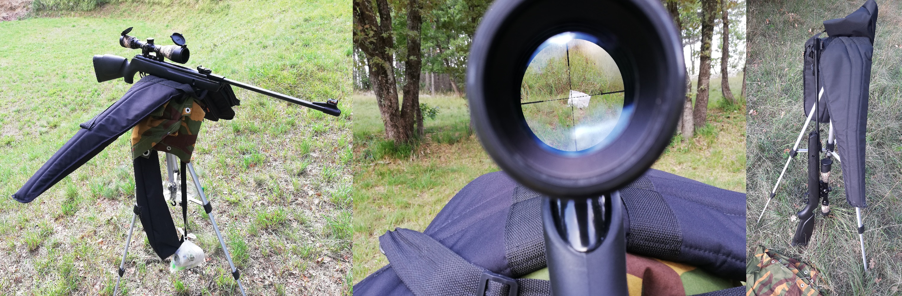

Here are also a couple of photos of the sight picture, through the UTG 3-9x42mm scope:
Excuse me, but I unfortunately forgot to which level of magnification I had the scope set to:

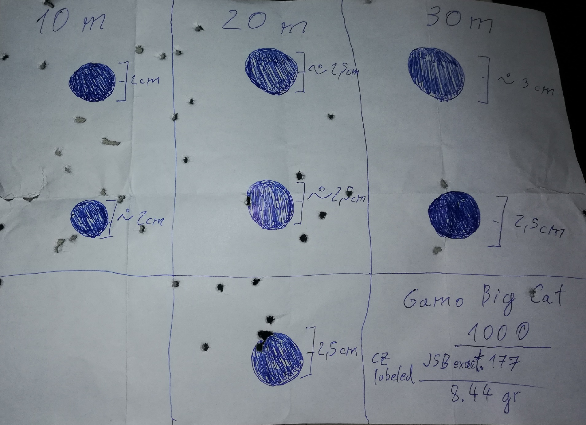

This is what happened after some 500 pellets were fired through the gun, the seal got chewed up completely and had to be grinded down due to wear & improper dimensions - Note that these "groups", if you can even call them that, were shot with open sights, that I actually quite liked, because of their slimmer profile...

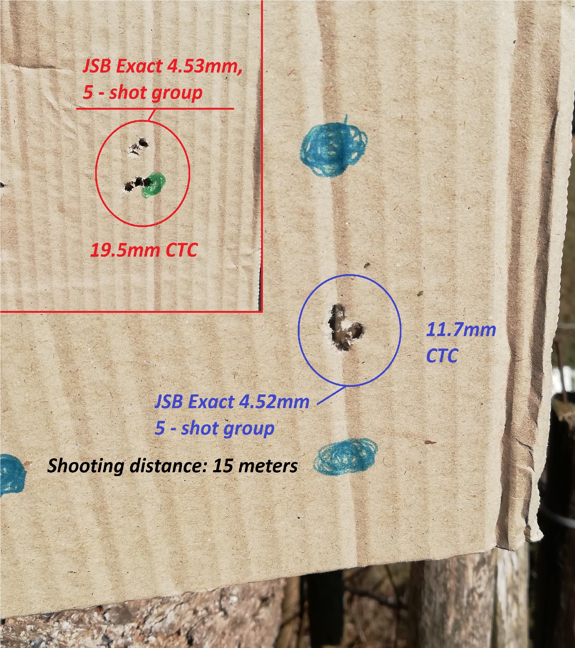

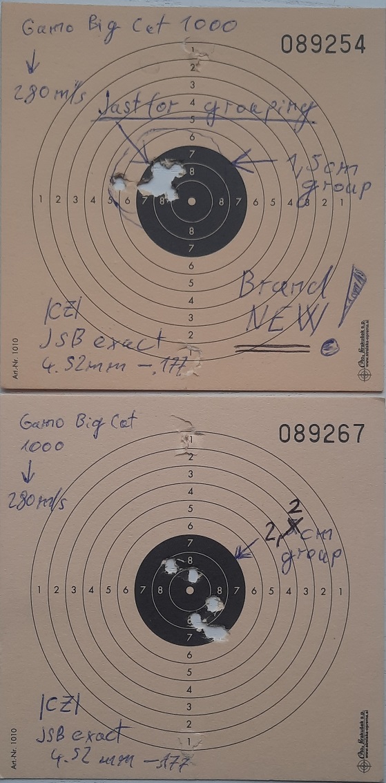

...And this is how the gun performed out of the box with JSB Exact 4.52mm & 4.53mm pellets, at 15 meters:
Note that before I started experiencing issues with accuracy, and before I de-tuned the gun to 12 Joules, I was able to shoot beer cans 90+ meters away with ease! Now the gun's effective accuracy in regards to hitting a 12 oz. beer can is somewhere in the 60-70 metre range, beyond that I don't think I'd be able to hit it anymore.

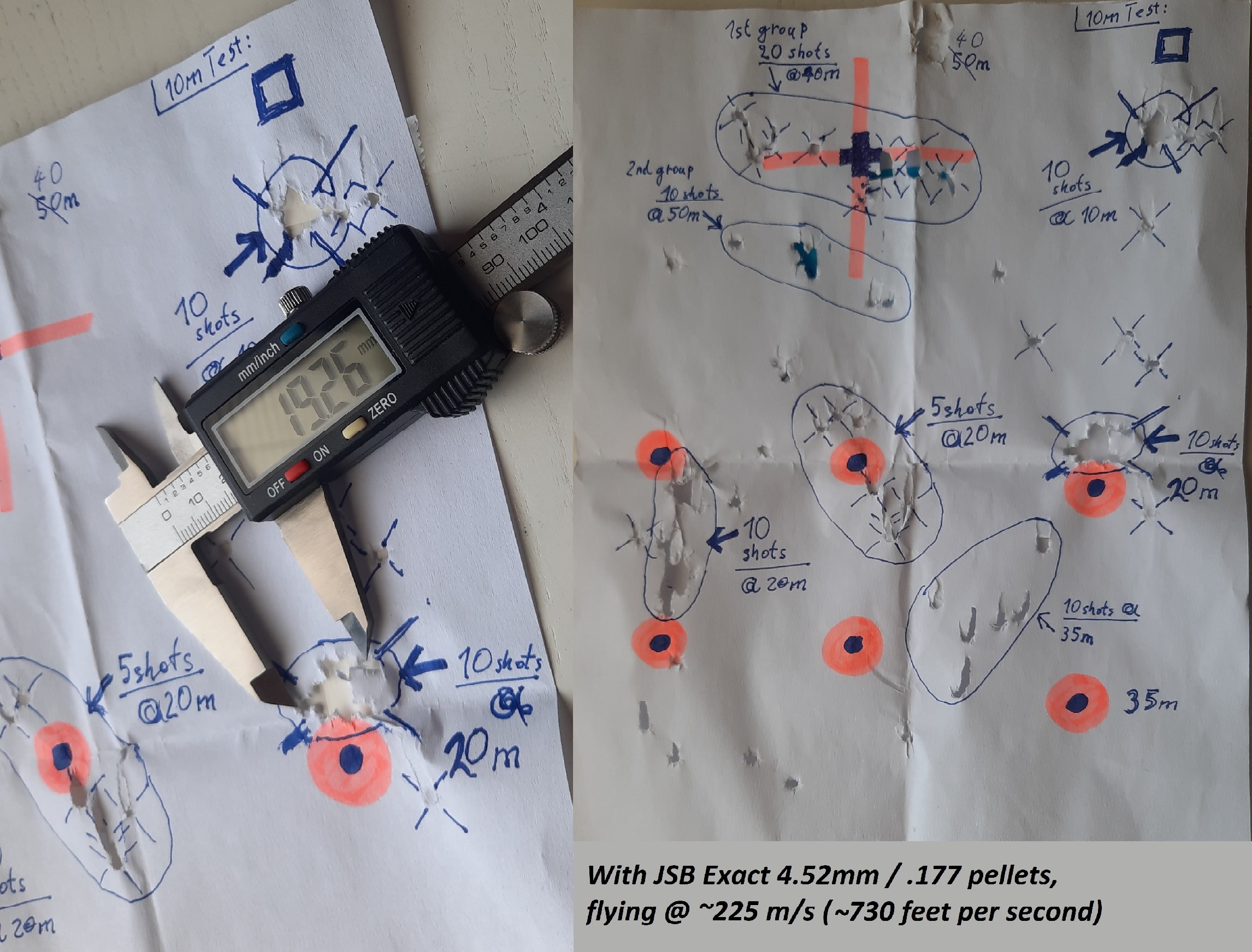

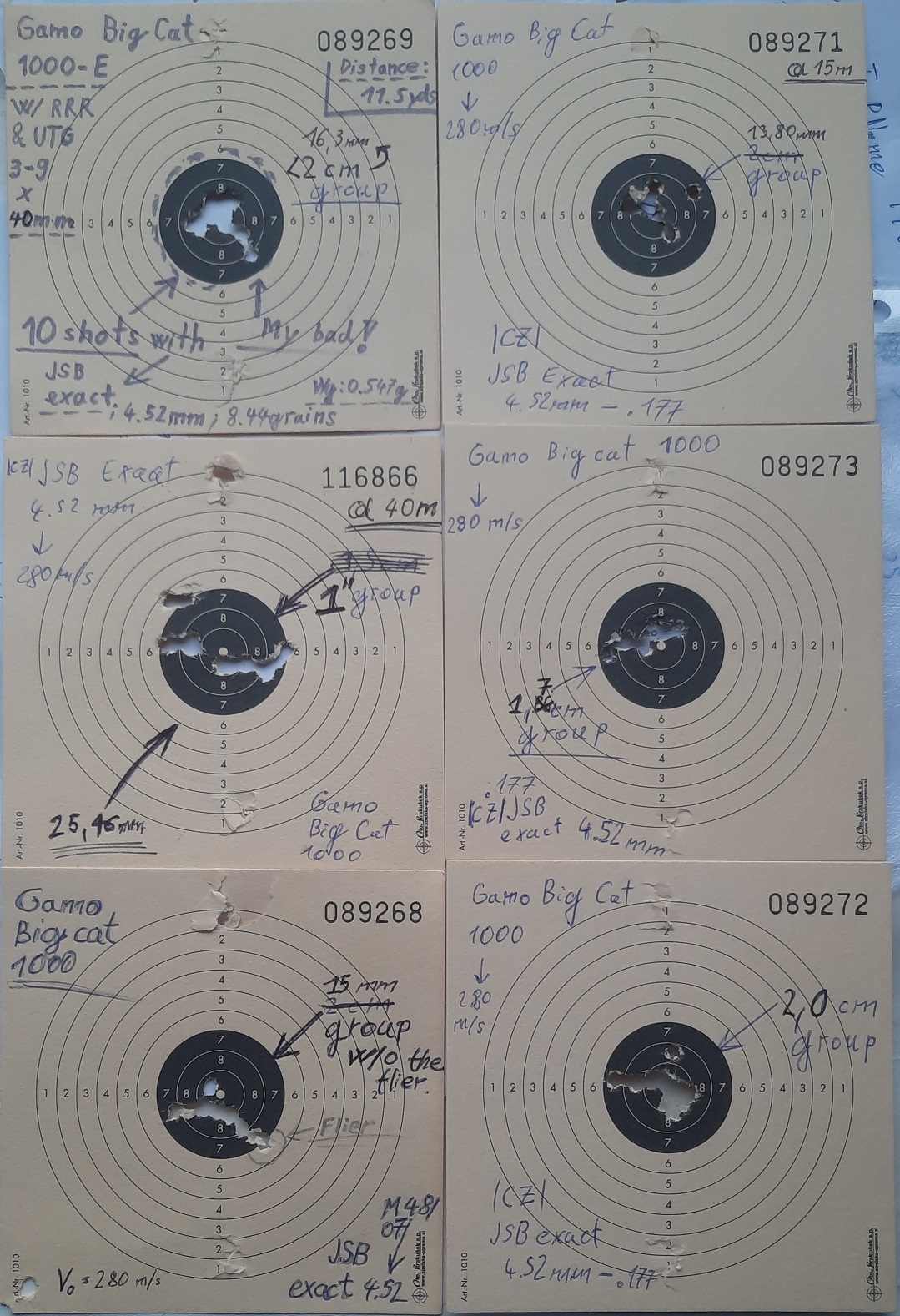

Sometime last fall, I re-tested the gun and this is the kind of accuracy this thing of mine is capable of now, after it's been properly tuned:
I've tuned it down and fixed the seal some 2.5 years ago and so far it seems to be holding its accuracy.
BTW, the vertical/horizontal stringings, that's you're seeing on the targets are due to the sudden bursts of wind, that were blowing that day...
I really should've picked a better day to go shooting. However, while it was calm, I was shooting at the targets on the right (10m, 20m on the right),
and that's where the true accuracy potential of my Gamo really showed.

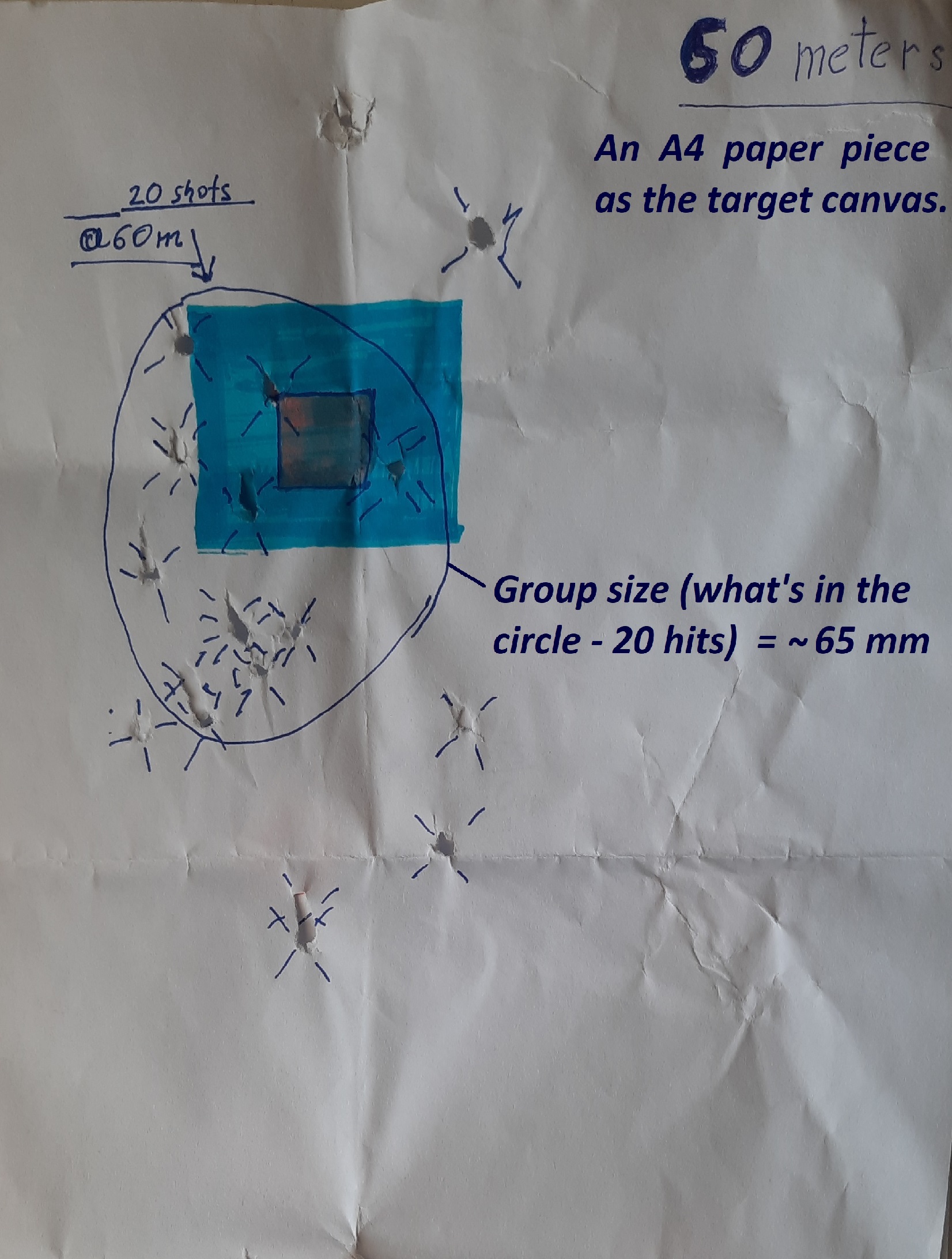

...And this is the delivered accuracy at 60 meters:
Note, that the wind was starting to pick up...

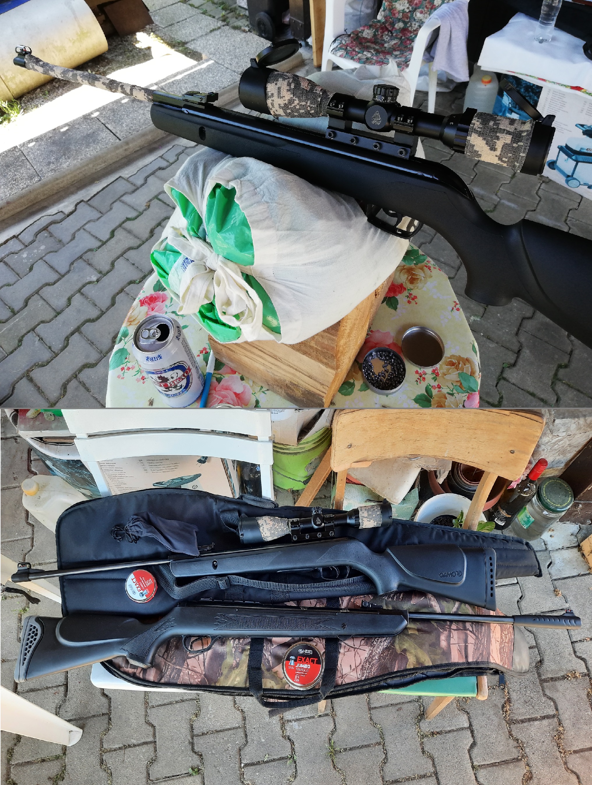

Also, here is how I eventually came to customize and accesorize my Big Cat, along with a size comparison between the Gamo BG-1000-E and
the Standard Hatsan mod. 125 version in .22 (5,5mm) caliber:
The 125's receiver/cylinder is a fair bit longer, while the barrel and the stock are roughly of the same length.
