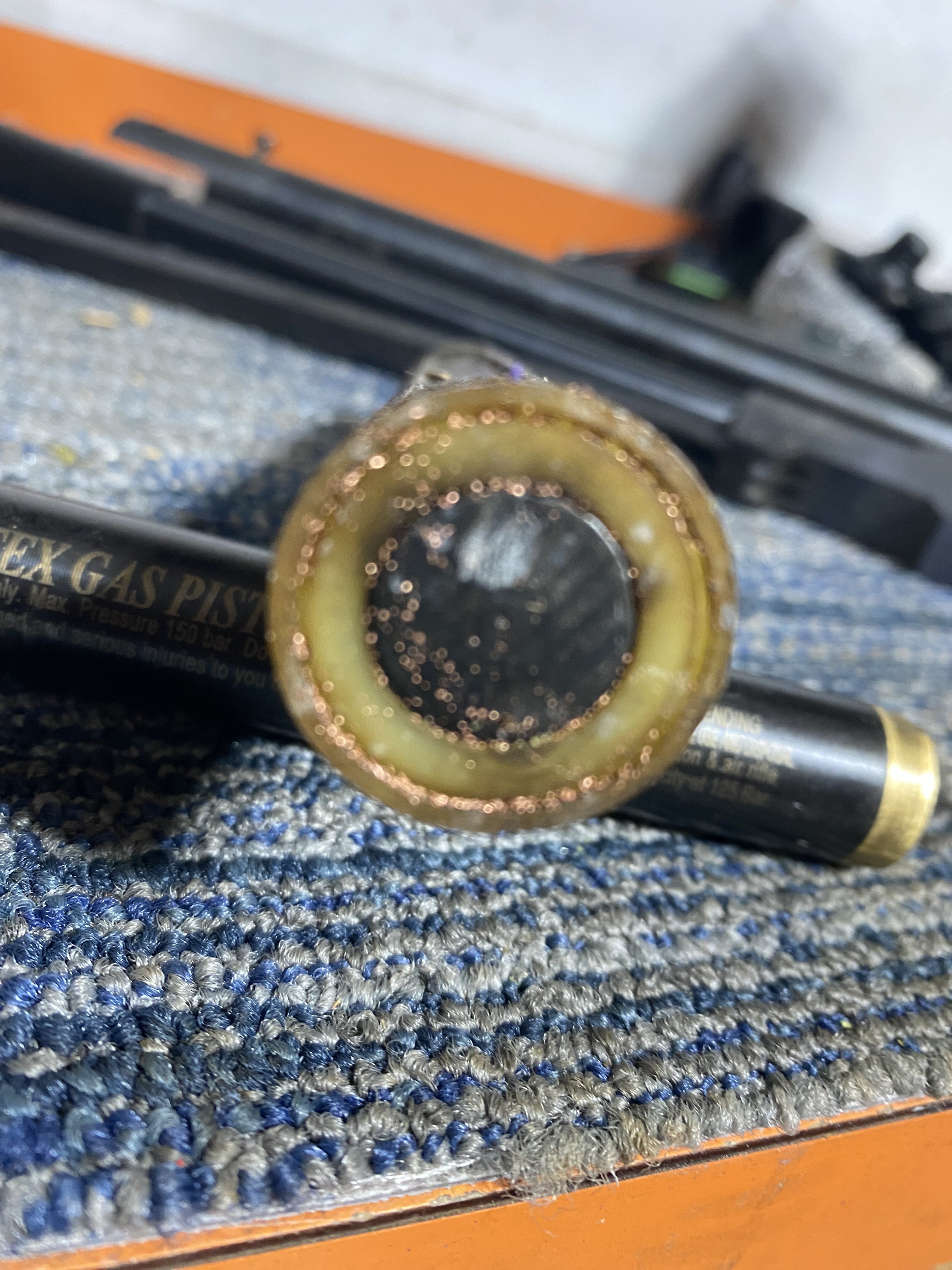

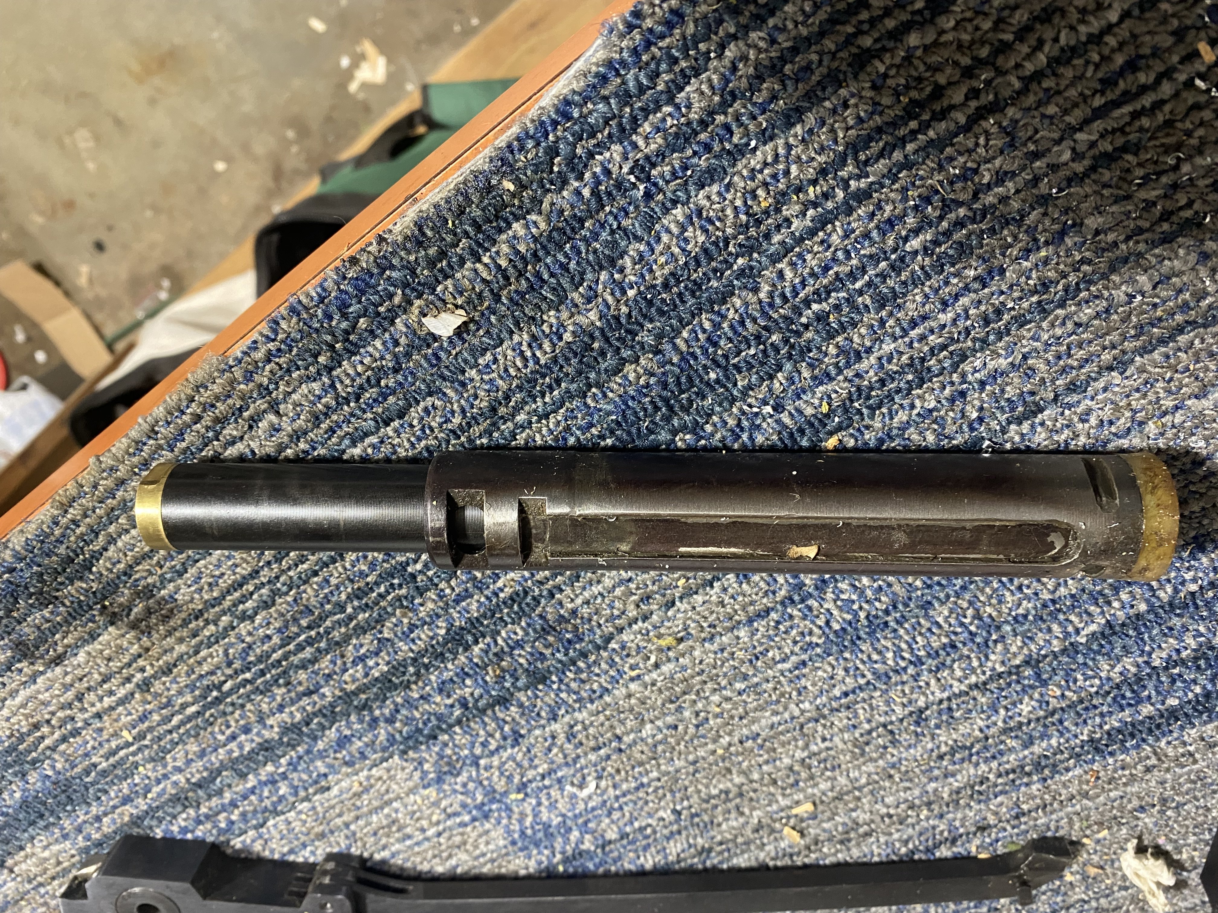

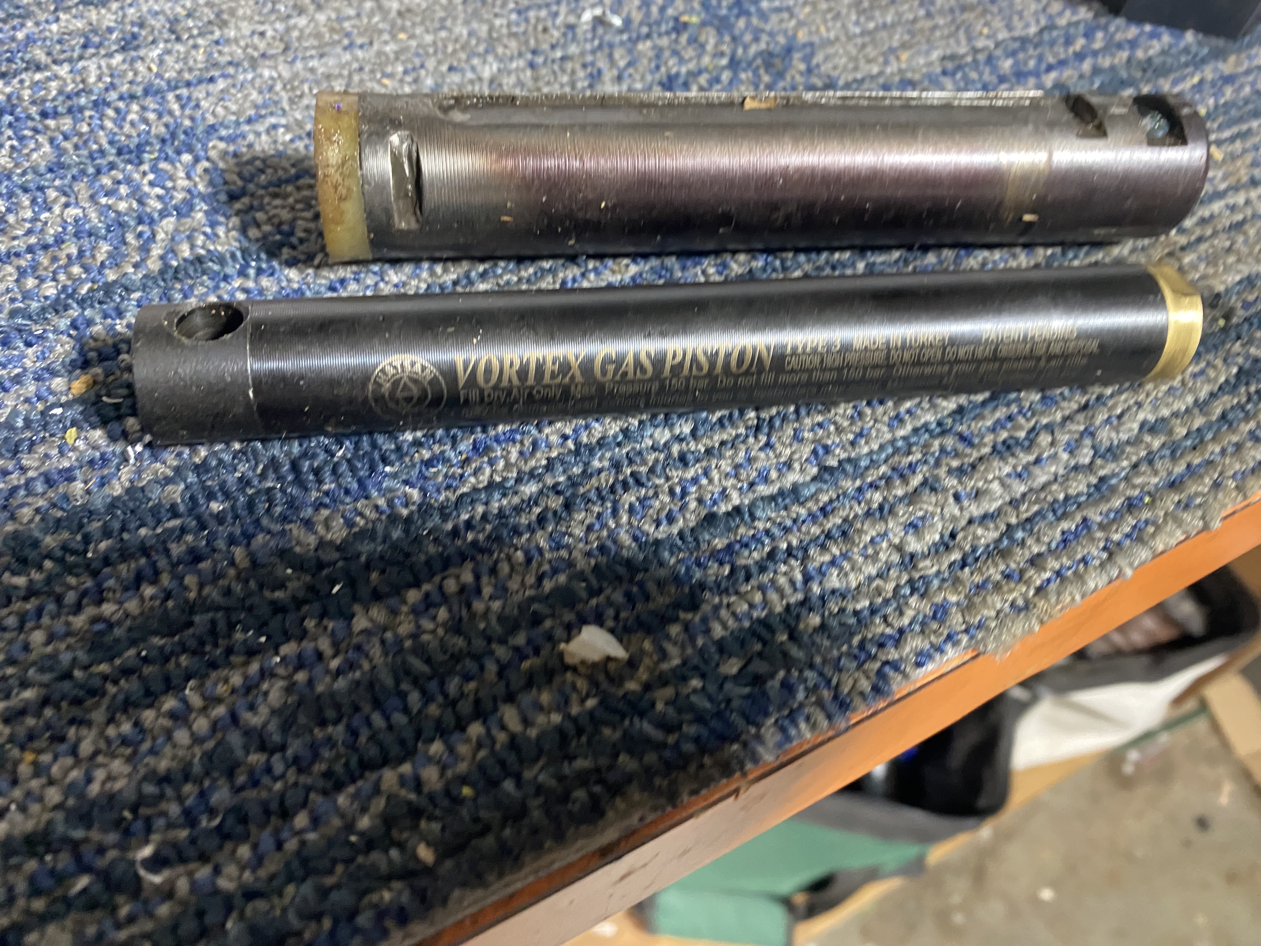

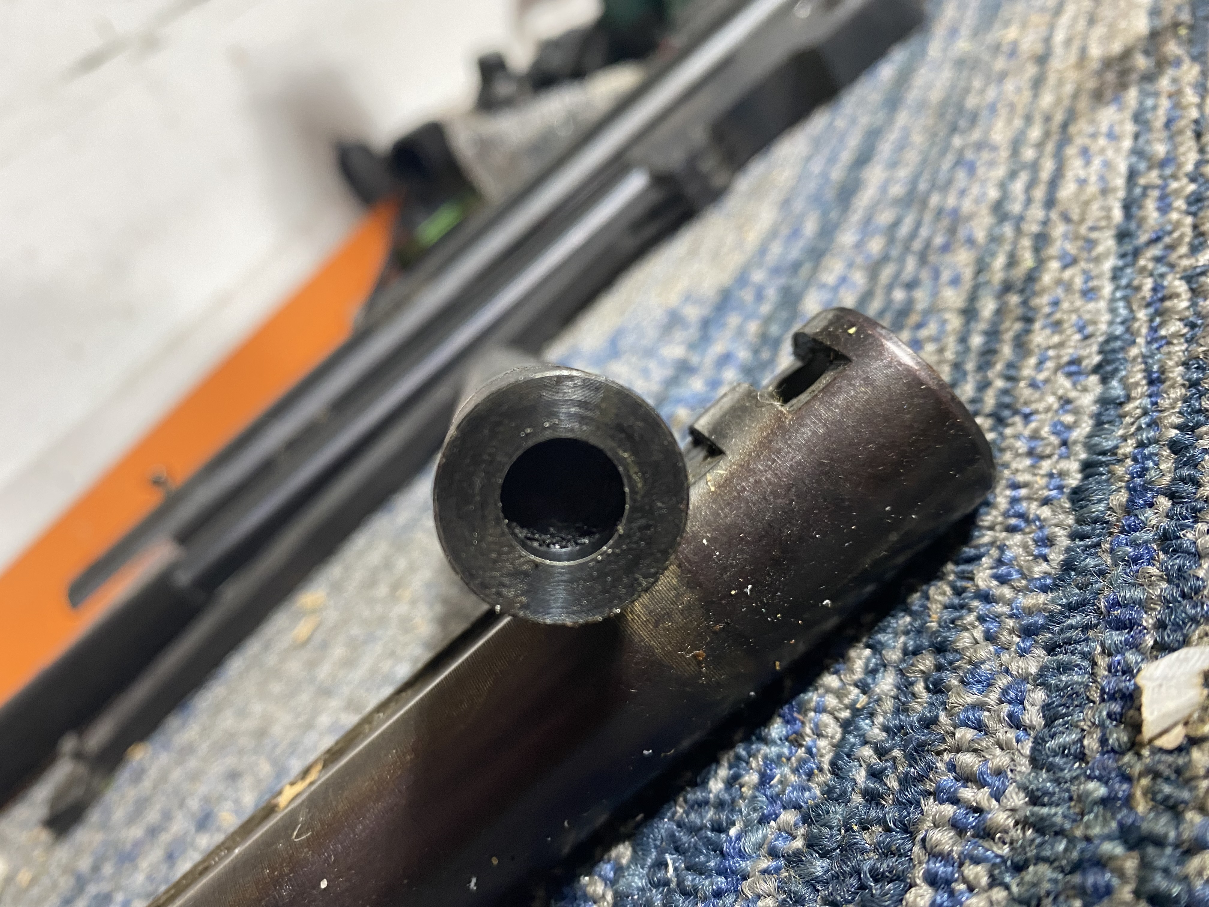

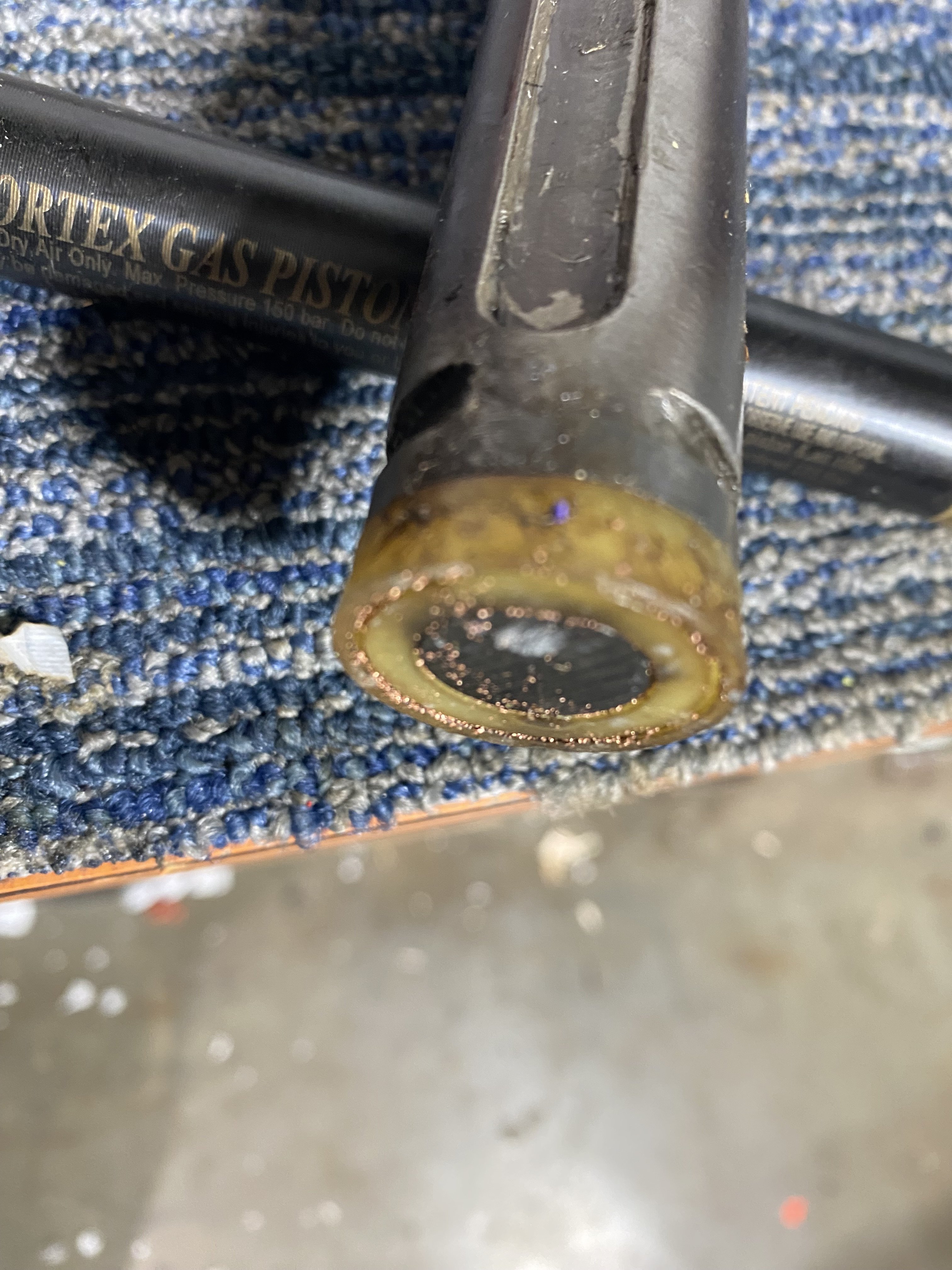

Came in a group buy. .25 caliber and would not cock. It looks like the gasram failed as the tail shaft is no exposed. The interesting thing to me is the piston seal, imbedded with what looks like copper debris.

Not uncommon for those rams to fail . They are cheaply made. There was a dude rd sealing them as the front seals are weak
The copper looking dust is a odd thing. Unless they brazed the pickle forks on and the honing reamer left that in there.
Sadly ,Hatsans are not made horridly ,just poor quality control and weak piston seals..

Looking at your pic of the gas ram inside the piston, is that the way it came out of the comp tube when you took it apart?? The body of the gas ram doesn't go inside the piston and if it was, someone had that thing apart and either put it back together wrong or just tossed it all back in already knowing the ram was toast.
AGR already said it but the Hatsan rams tend to fail from lousy orings inside that brass cap the shaft rides in. There are 2 of them in there and when they dry out/wear out, away goes your air. They can be rebuilt if you're that bored and want to, You want new, I think Hatsan charges something like $45+ for one or you can just order the parts to convert it to a springer. Got your own lathe, I think it's the ARH E3650 spring that fits Hatsan rifles and make your own guides for it. He also makes piston seals to fit them:
