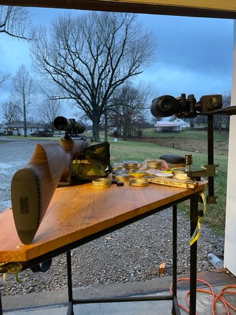

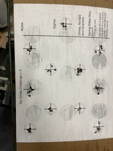

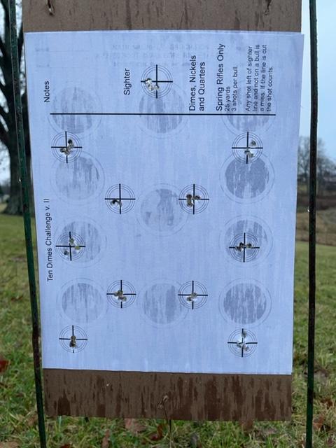

Having the holidays behind and working off on long break Thursday afternoon I've spent a little time with the TX200. I changed the scope one night this week, removed a Hawke 3 or 4-12 and installed a Leupold VX3, 4.5-14 AO with a Varmint Hunter reticle. It's been unseasonably warm here for the last two weeks so yesterday I opened the shop and set up a target and zeroed the scope. It was pretty windy so I finished it today, a light drizzle was falling but virtually no wind. I feel I have broke over the top in the learning curve with this rifle. The last piece of the puzzle has been trigger control, if I concentrate and break it clean the rifle will almost shoot hole in hole at 25 yards, if my little mind drifts the groups will open up as seen in the photos below. I am learning though!
This is one of the older ten dimes challenge targets. I started out shooting five shots but changed to three after the first scoring target. After shooting it I went back and shot two more pellets into each target, all targets have five shots in them in the second photo. I purposely boogered the trigger pull on some targets, others I concentrated on a clean break.
lol that,s the 1st thing I noticed too,lol. And,what is that? a spotting scope?. Pls forgive me I don't get out much. I'm considering a high-end UL for my next purchase before I leave this world that is why looked at the post. So 1BadDart, how do u like your TX200? What pellets have you tried? AND,,have you noticed any difference in how tight your groups are between the 3 scopes. Have you left the TX200 stock? Do you think you'll make any changes to it? I'd really like hear your thoughts on the TX200.

I use this bench to practice for 10 meter indoor bench rest matches that I shoot in the winter. They are shot with aperture sights, hence the spotting scope.
