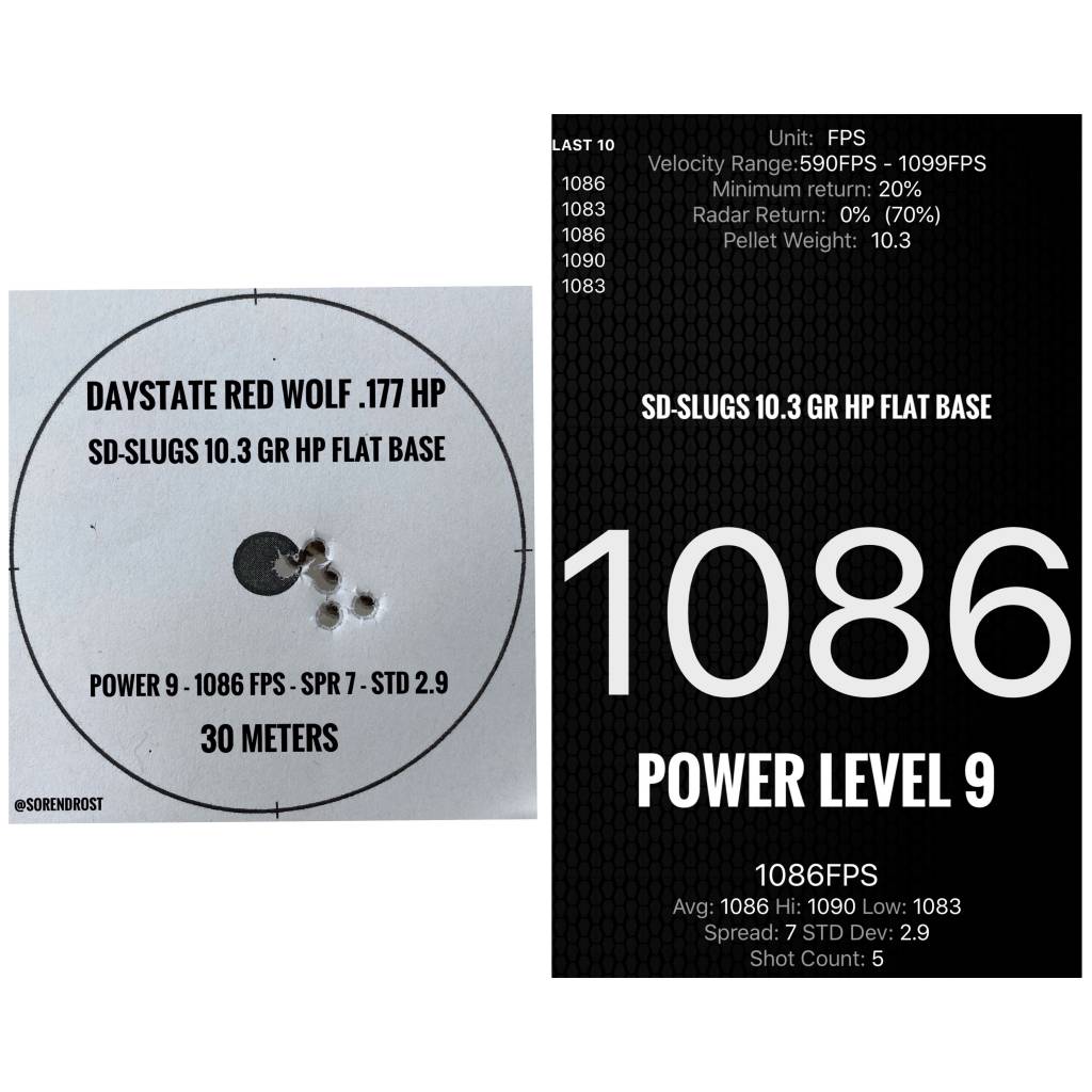

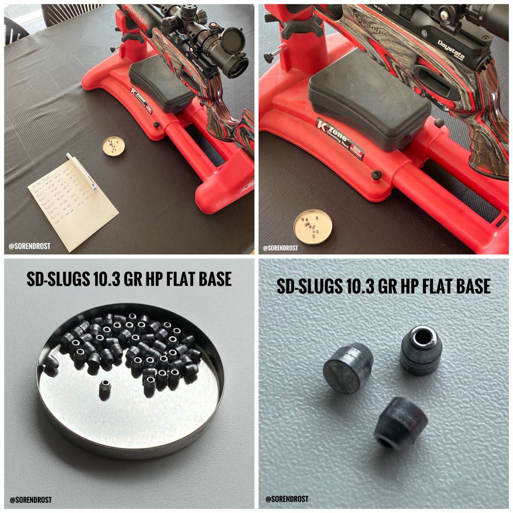

I tested 10.3 gr slugs with hollow point and a flat base in my Daystate Red Wolf .177 HP 😃
They did okey at 30 meters / 33 yards - Need to test them further out 👍
