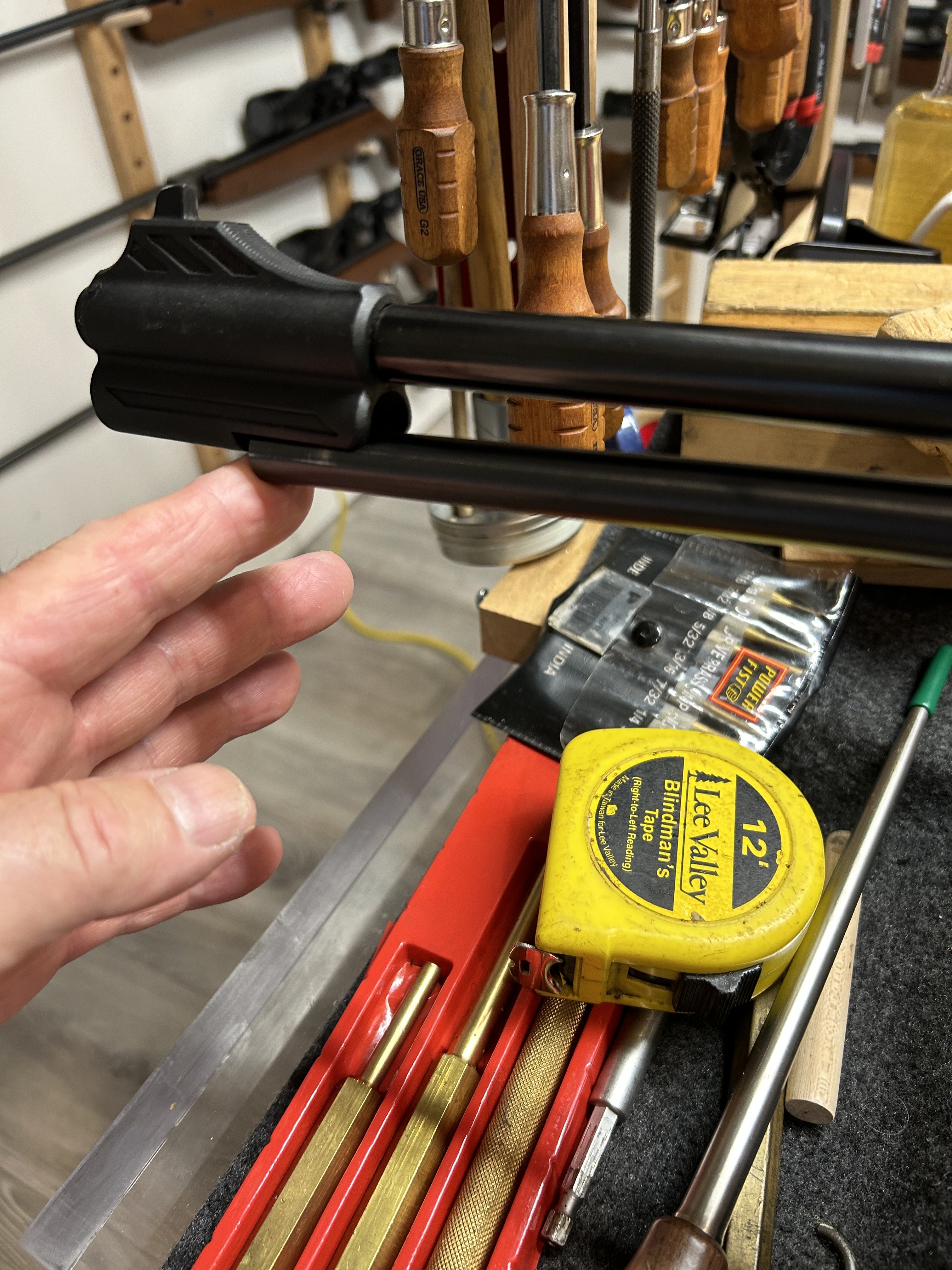

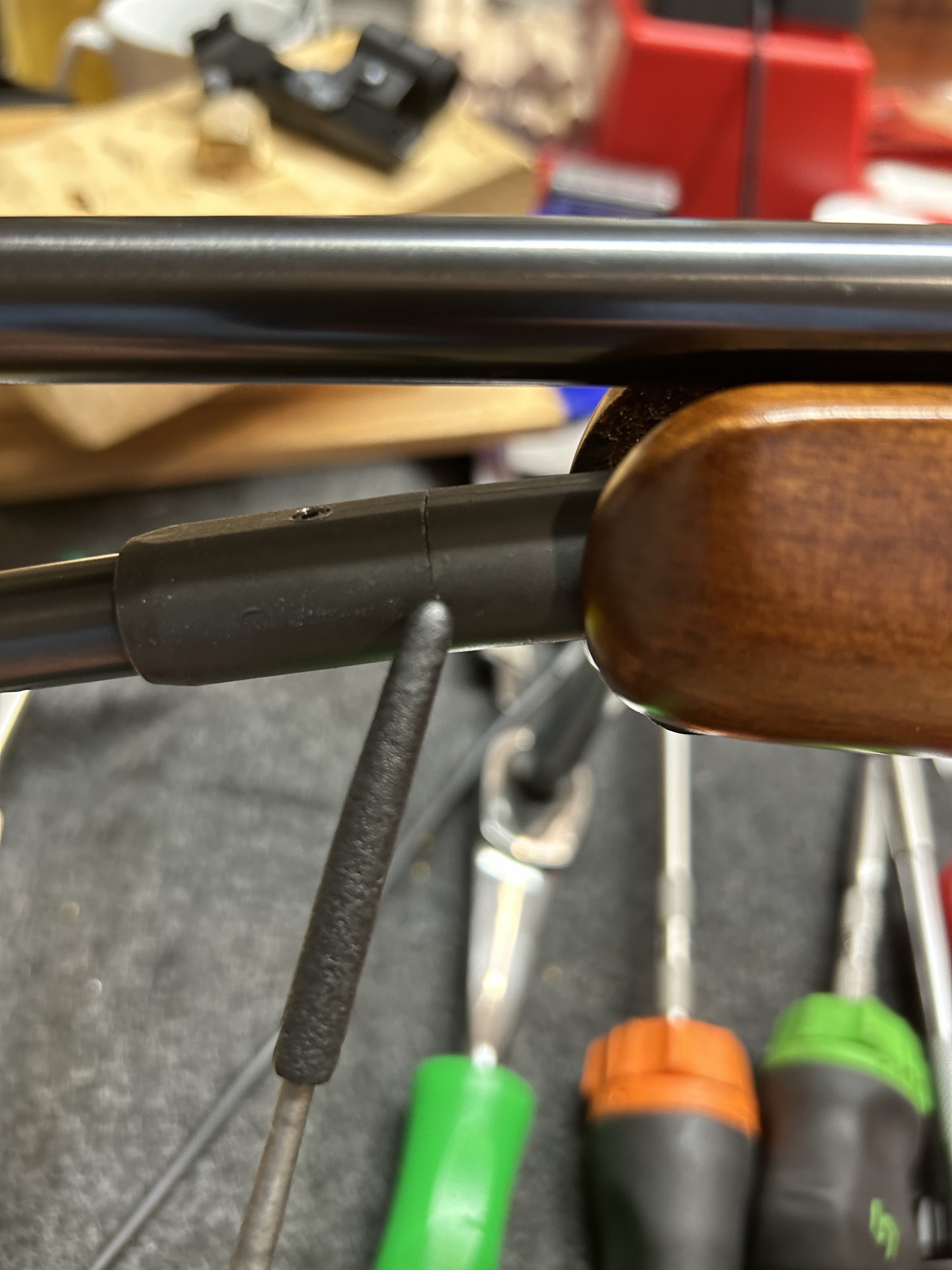

I bought a Diana 460 mag. .177 used a few months back. When I first got, it within 10 rounds I realized I had a broken spring. Replaced with a Vortek. Great. All’s well. Barely shoot it realizing the leaver arm won’t catch the ball joint.

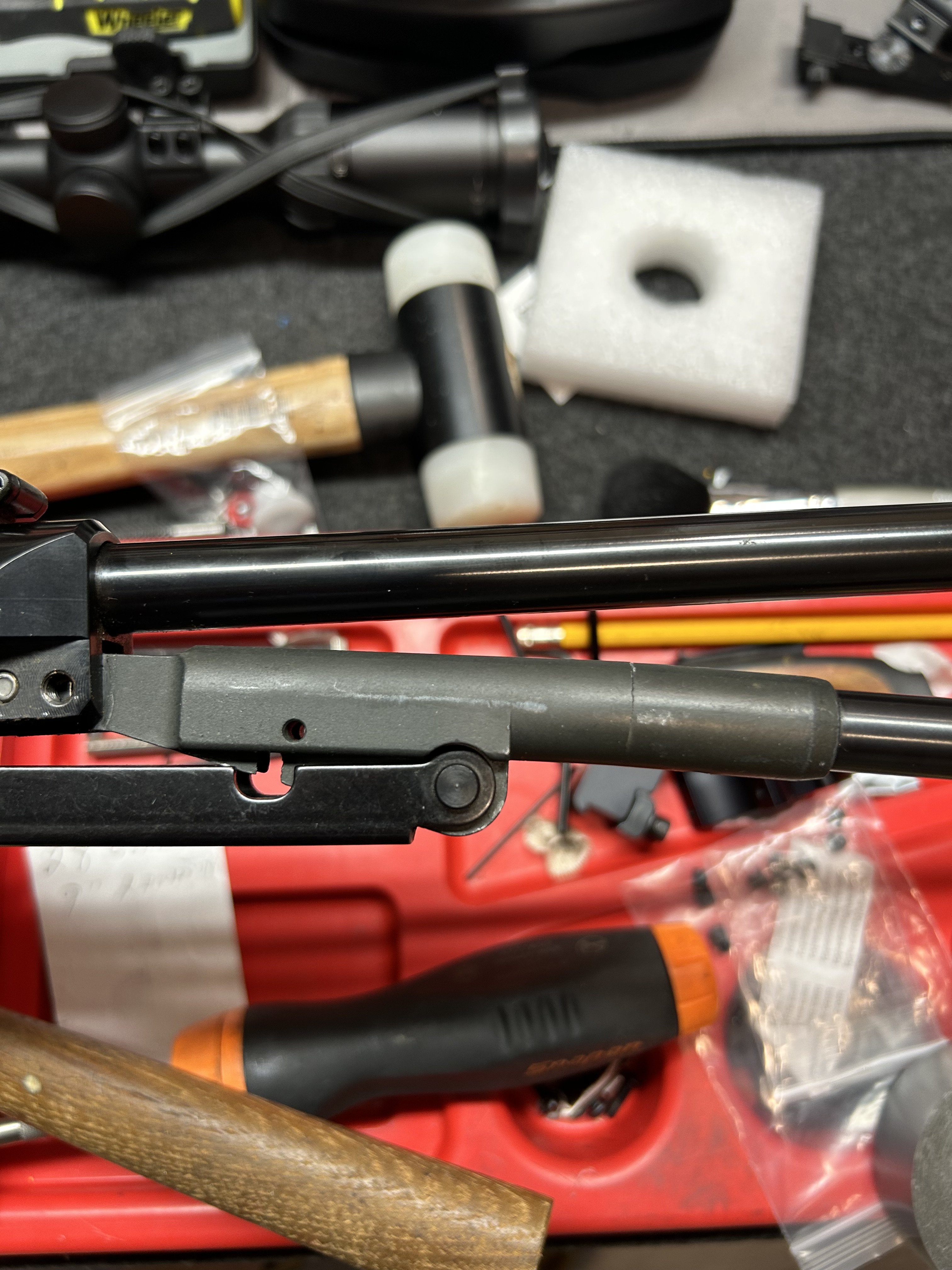

Up on inspection I catch a crack in leaver arm fitting.
I’m so glad I caught this before it broke off.

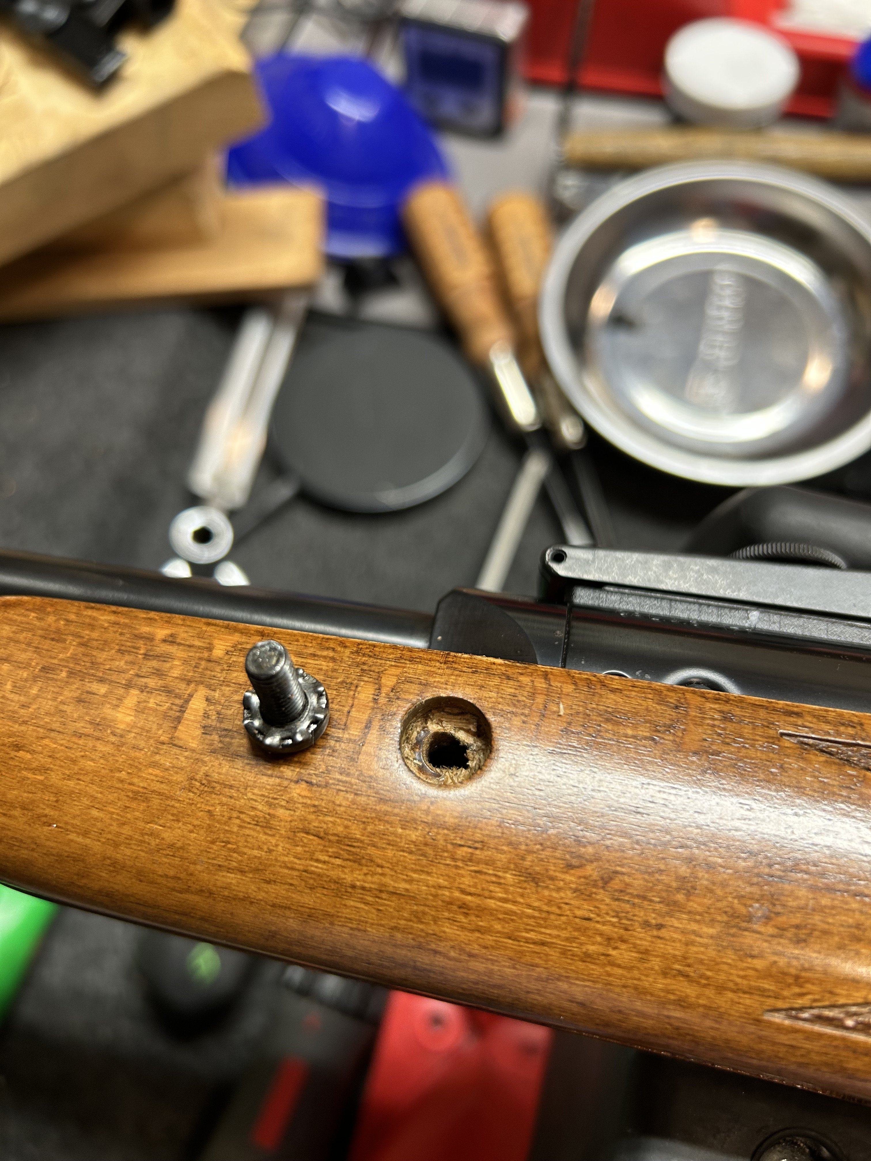

I go to take stock off and I notice the star washers against the wood. Don’t like this cutting the wood.
Will put a flat washer against the wood. I get to the culprit.

that was the problem with the 46 and the 460 was supposed to fix it and it has not

i thought i should look on Waffencenter and they have a picture of the part and you can see from the picture they have changed the part by adding a gusset under the arm right where yours broke

My K98 and other 460 both have the gusset, whew.
