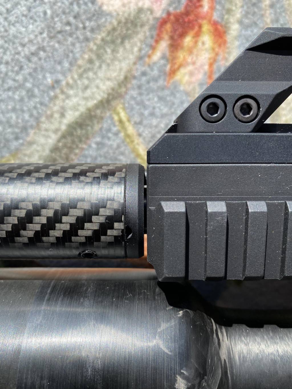

I ran into that also with the shroud. Easiest way is to leave a small gap business card thickness between the shroud and frame. When it’s butt up tight against the frame the barrel can’t “free float” and won’t return to normal position when bumped or moved. Mine keeps zero pretty much all the time and I haven’t had to re-zero in months.
CC has it right. The contacts are spring loaded and can tolerate a fair gap. I measured a 0.010" gap in mine at 85 degrees and put it in the sun for 20 minutes. At 112 degrees the gap measured 0.004 ". A business card is roughly 0.020" and should cover the different expansion rate of the barrel and frame. Aluminum has a much higher coefficient of expansion than steel and if the collar doesn't have enough gap, will cause a very high stress on the barrel. I'm sure this is known at the engineering level, but was not communicated to us through any channel.
(Edit) All that's really required is to remove the 2 grub screws on the shroud and slide it off the collar, then loosen the 2 grub screws on the collar, stick a business card between the collar and frame, and tighten the screws up. Pull the card out and put the shroud back in place w grub screws and you're set.
Hope this helps.
Bob
Yes, but its not the shroud, its the collar that is under the shroud that has the contacts and wiring which goes towards the end of the barrel where the chrony sensor is located. So remove the two set screws that hold the shroud on and pull off the shroud. Then loosen the two set screws that hold the collar in position and do what Bob @arzrover says above in his second paragraph. The contactors are spring loaded, just make sure they are aligned and are making good contact when you "set the gap". Easy way to see is make sure your gun is turned on, the red LED light on the chrony will be lit "on" when the contacts are properly aligned and making good contact.
