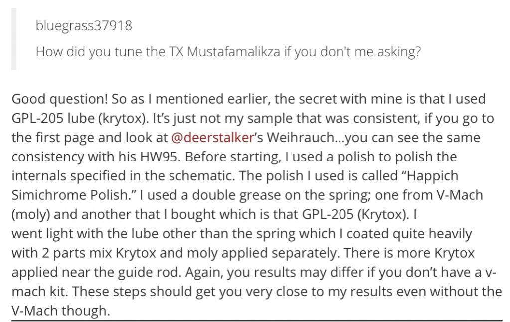

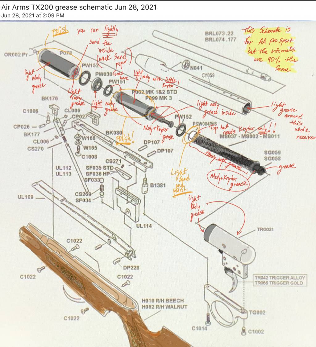

Hello there. I got a question regarding my tune and I thought I should share.
Edit: I only polish the outside of those indicated parts.
This tune got me these results for my Air Arms TX200 .177:
If you found it useful, give me a + for good advice! Cheers!
