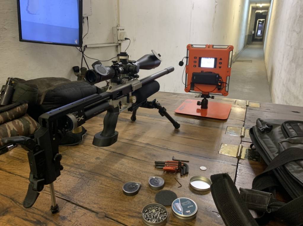

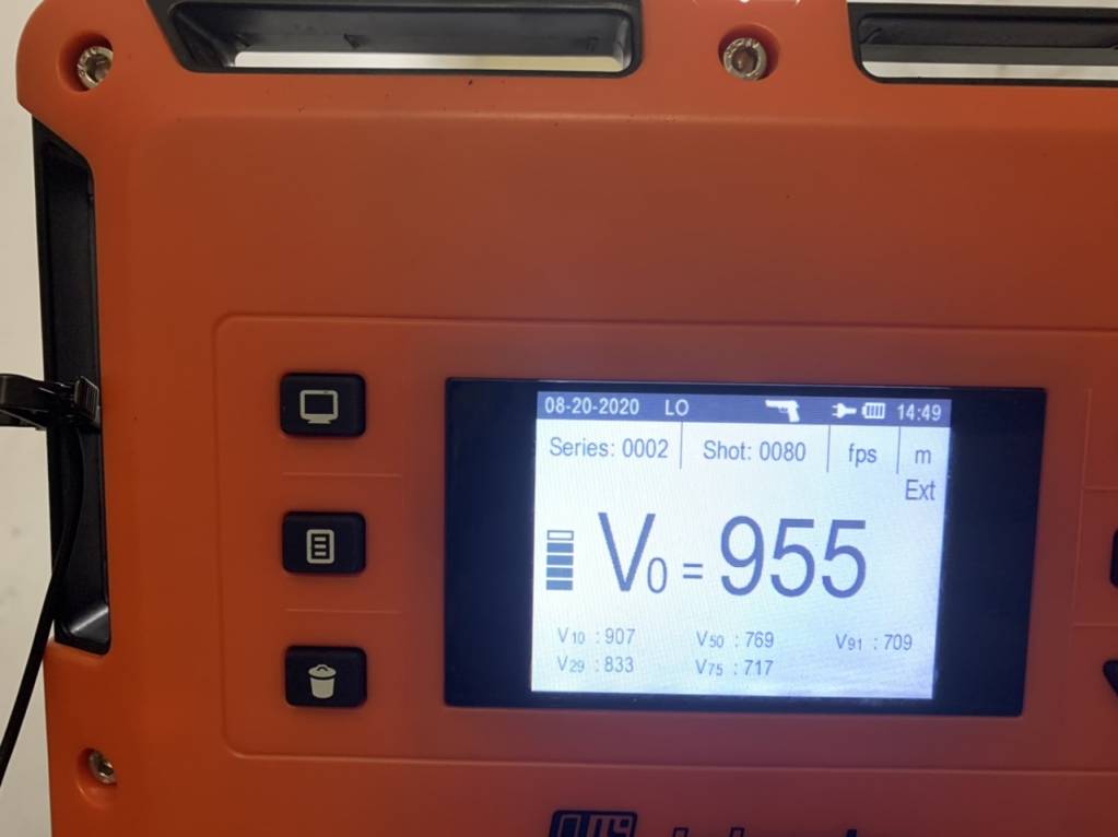

I know you guys are over in the US, but the offer is open to all! I am allowed one visitor in that lane per visit, so if you bring the air, I will bring the measuring toys, the range has no limits on fresh targets and if you want to get really anal we are allowed to turn off the fans and shoot with 0 breeze! if you are familiar with golf jargon then I can arrange for a few "Members Bounces" while at the range!!!
