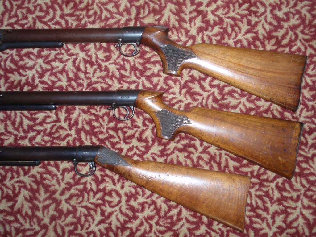

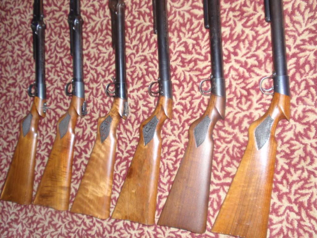

A few nice prewar BSA

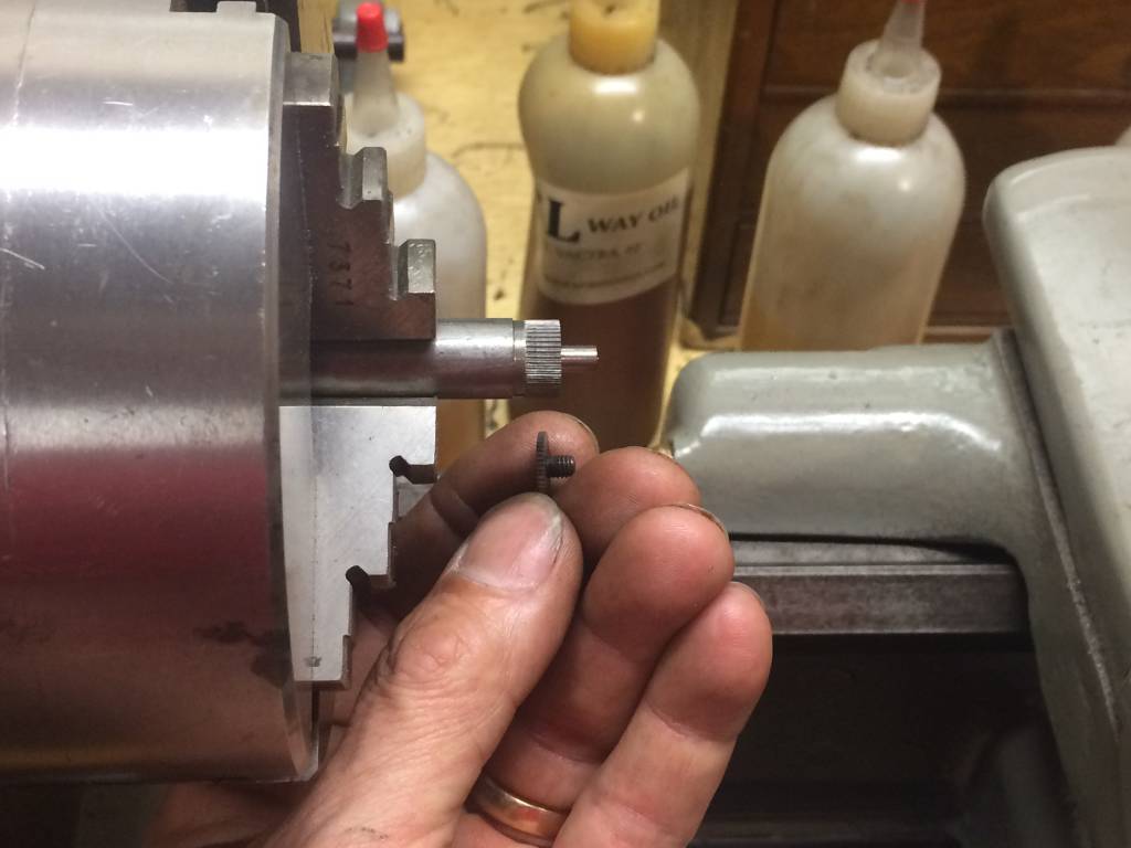

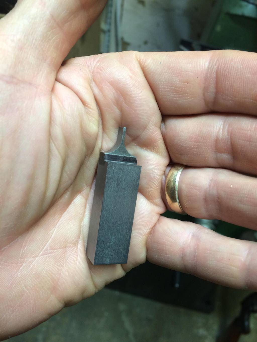

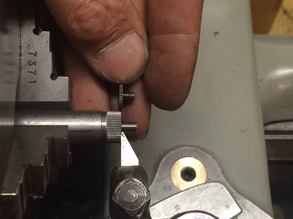

I never use dies. Or very rarely. Only takes a few minutes to single point and get the class fit I want. Additionally there are no taps or dies for Prewar BSA proprietary threads. Chasing threads takes some practice to be able to run at a speed that keeps it entertaining and doesn't take so long to complete. Confidence in your ability is important. Practice on some scrap to develop the skills.You have to get into a rhythm. If you (anybody) need help by all means PM me.

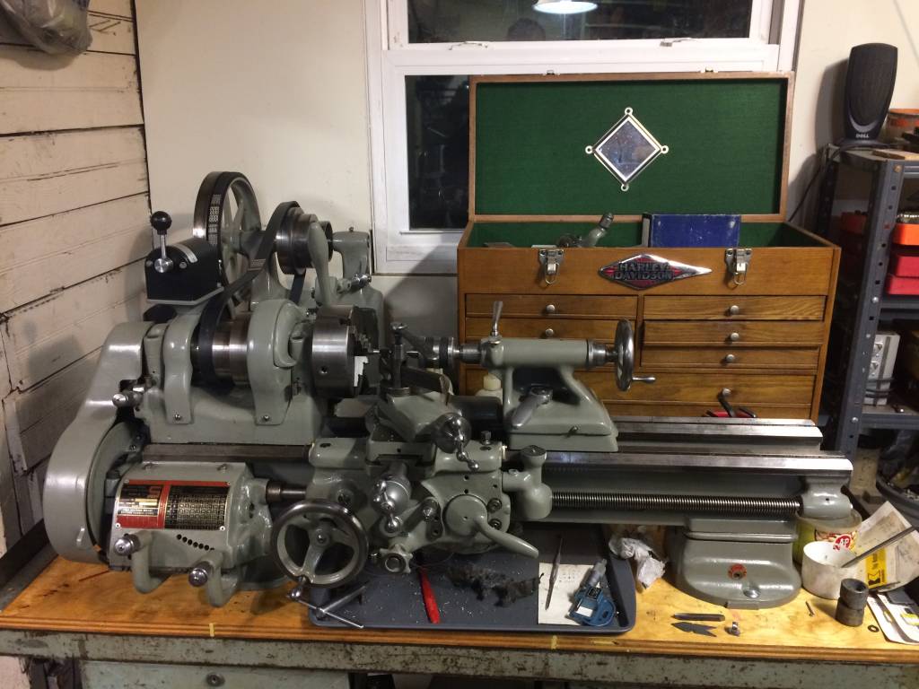

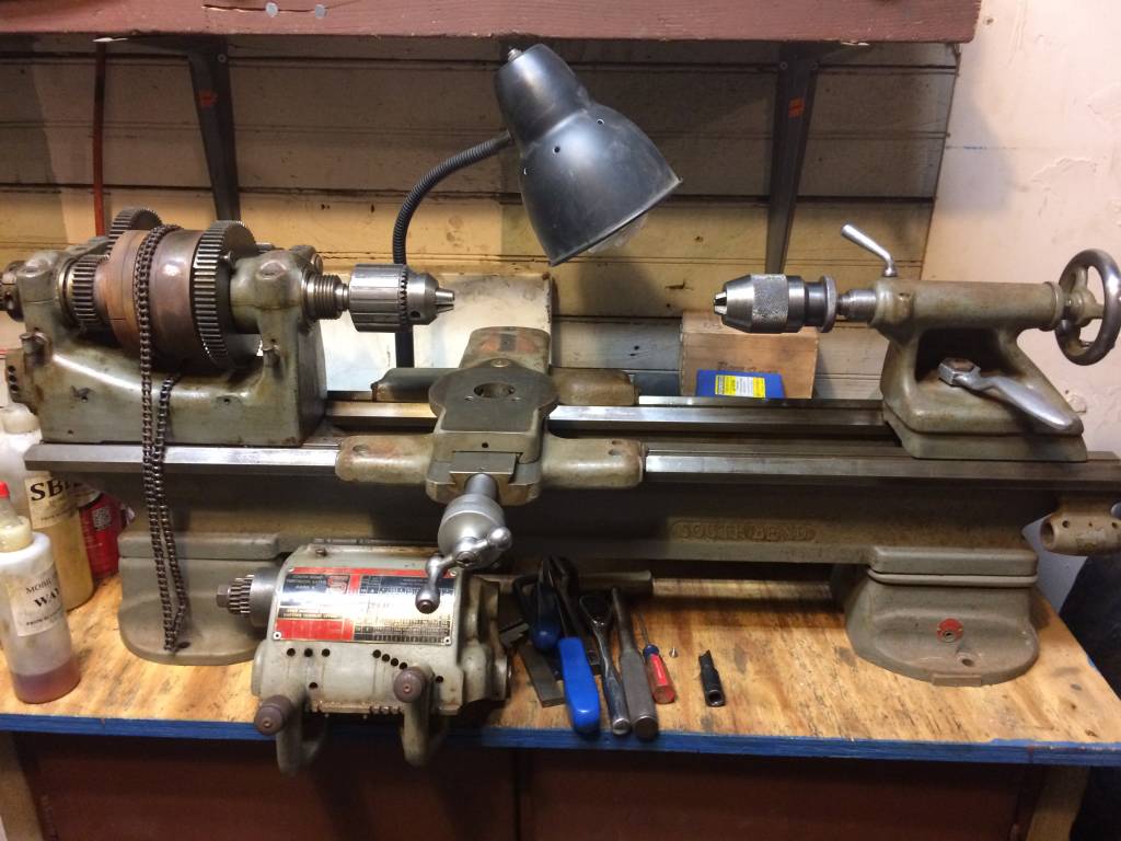

Thank you. Yeah I've been playing with machines about 45 years. See one of my lathes I rebuilt on Airgun Warriors Metal Shop. I have to finish the series of posts but been really busy lately. You can see some other posts I did there too . Hopefully some useful information in there somewhere.
