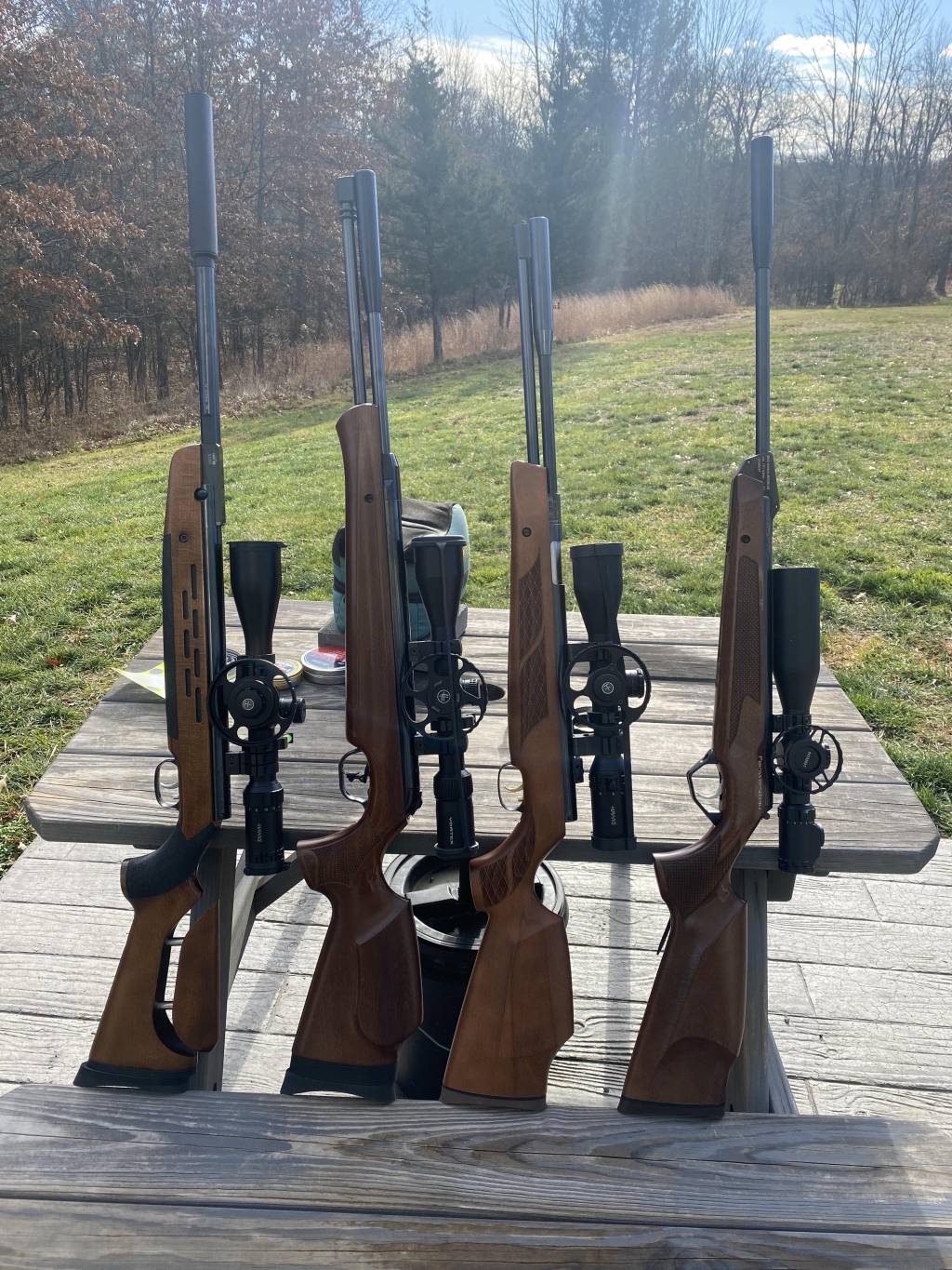

A little fun with a few of the ladies today. 10-20mph tail wind pushed them around a little bit but overall happy with the results. The FWB Sport pushing FX 8.4’s to 870fps was more affected than the larger calibers. 5 shot groups at 30 yards
Wow that FWB is shooting hot at 870... You have some pretty nice groups there !!
She’s at about 14.2fpe. Played around with the insides a bit. Put an HW80 vac seal on the piston, took a coil and redressed the end, and made a sleeve for the rear spring guide to take up some of the slop in the shot cycle. Cocks and shoots really smooth right now.
