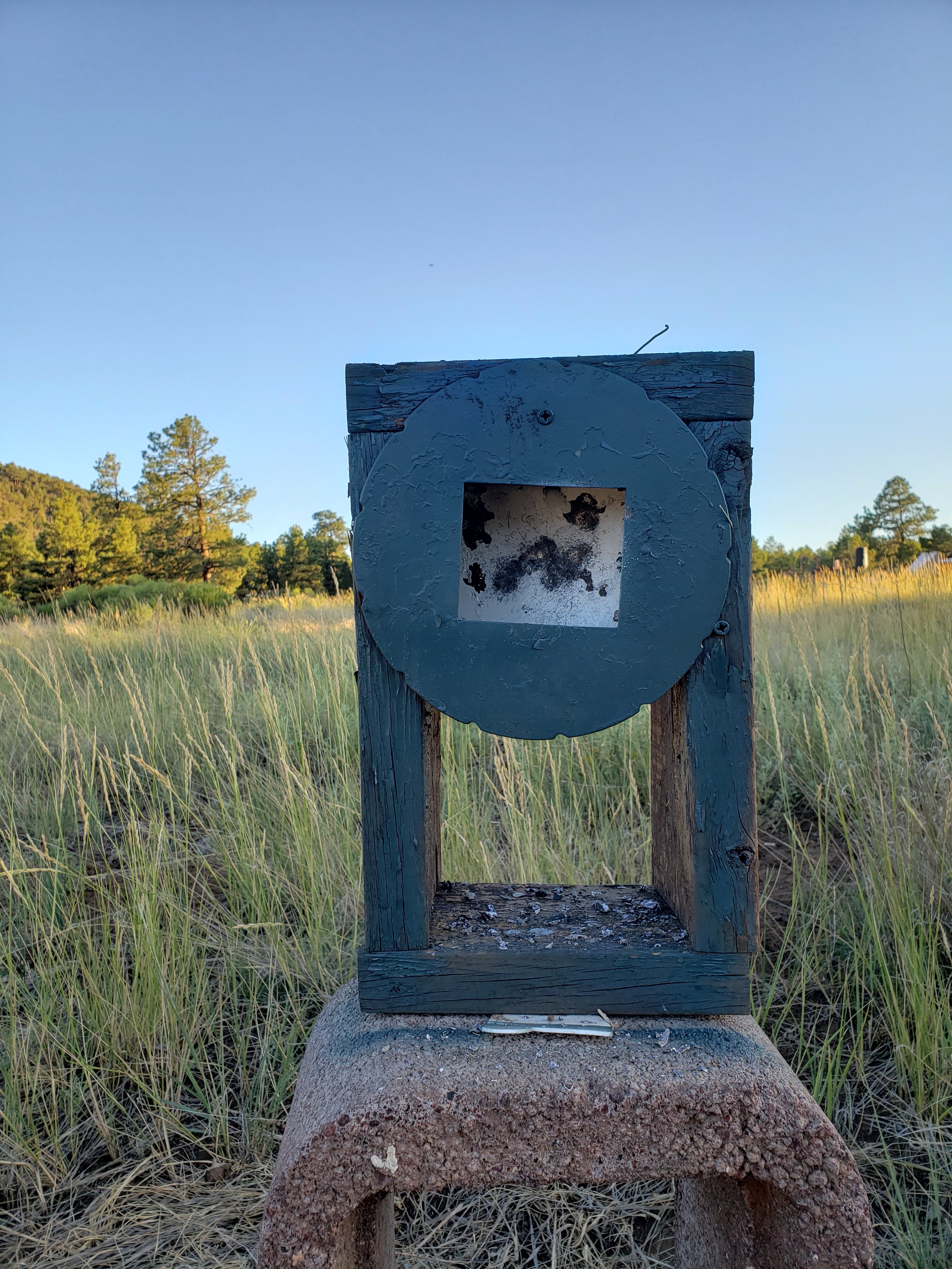

I was checking my dope this morning on my steel in the usual switchy windy conditions I have at my plece which were 6-11 mph. This was from my 25Y zero and "BTW no POI shift" had occurred from when I shot 3 days ago. Then shot at 65, 80Y, 92 and 105Y. I didn't miss in the 20 slugs I shot. I did need to hold off .3-.4 mil at times but I'm guessing I would have missed at least a few times if using my 22rf or 22 cal 42gr swaged slugs.
The only problem there was was me being blown back and forth due to shooting off bucket and sticks so I had to take heed to timing my trigger pulls so not all hits were centered.
I didn't take pics of the steel today but this is one from the last time at 101Y. The KZ is 3" tall and 3.6" wide.
