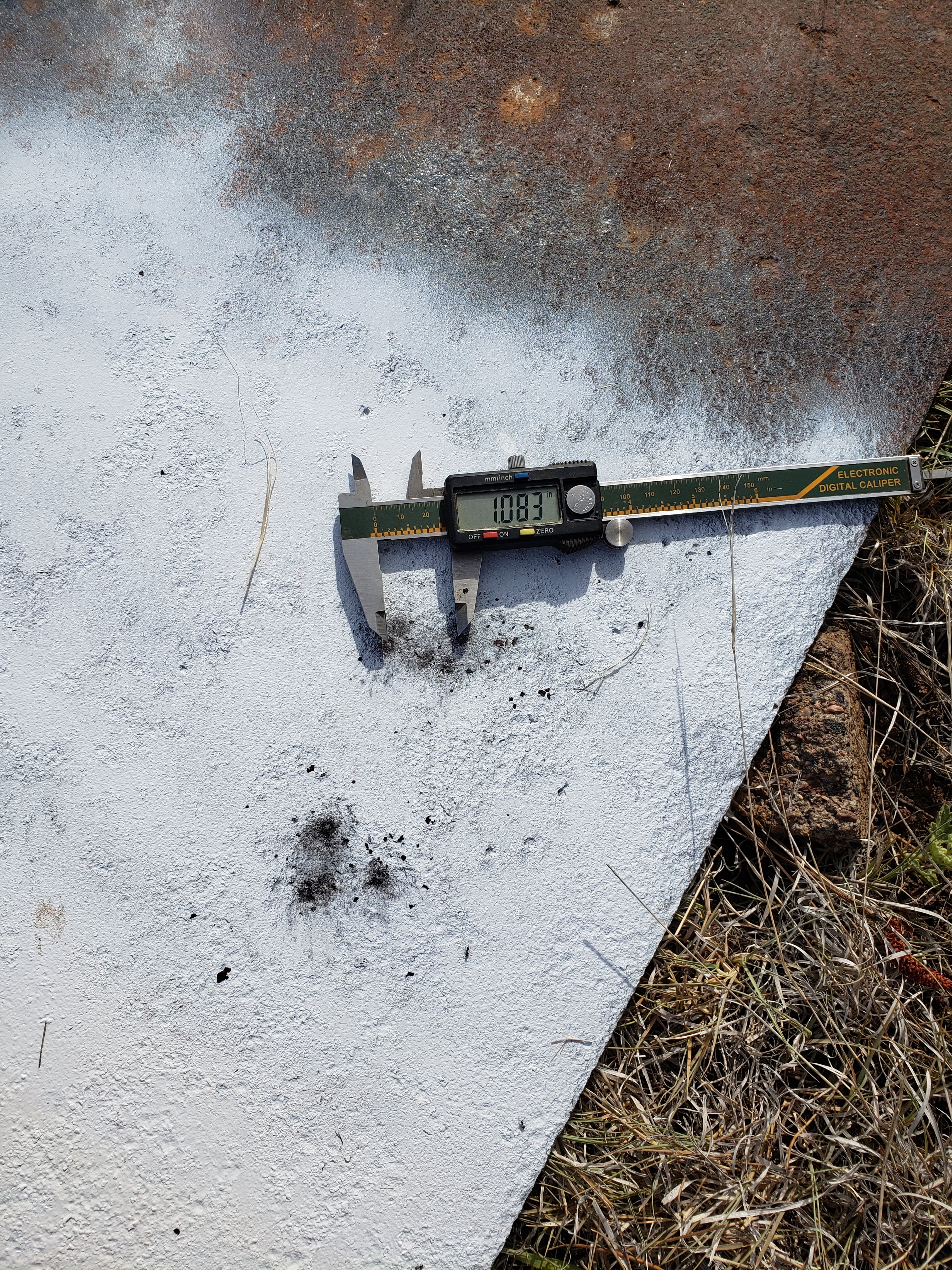

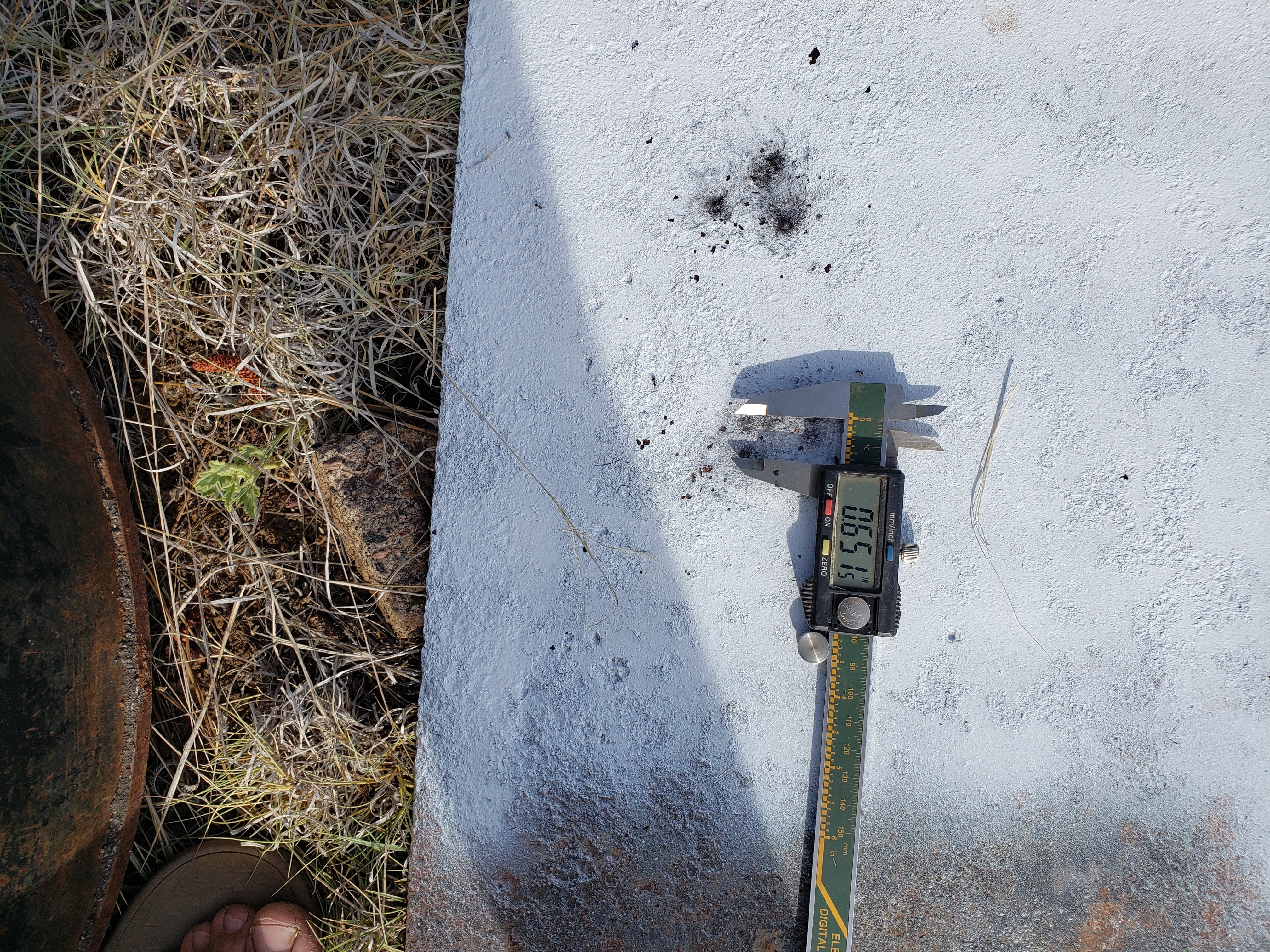

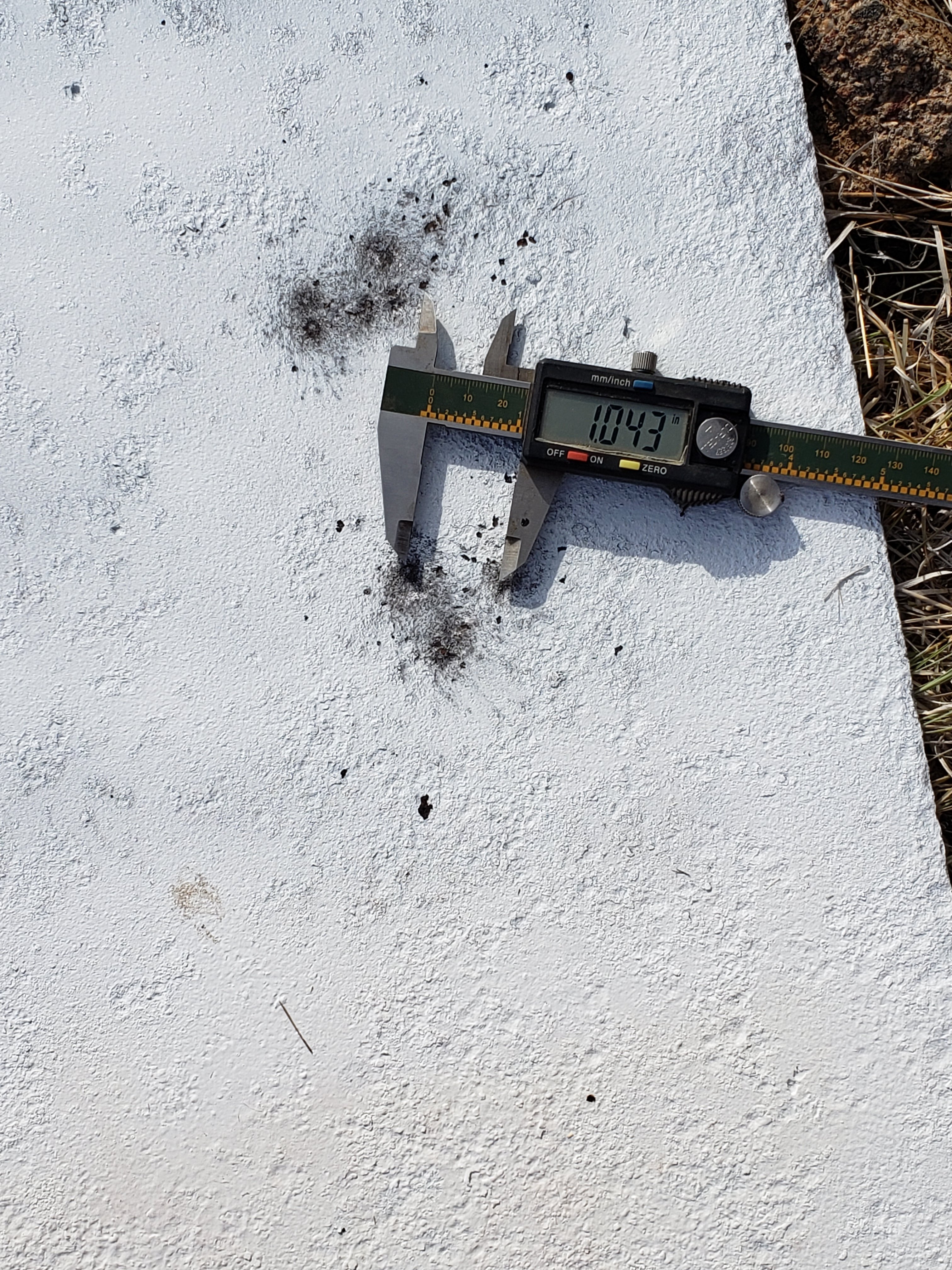

As of yesterday I have a little over 100 slugs through the V3 which have been mostly Altaros 49.5gr. Those shoot the same as the 60gr Queens as far as I can tell with the little shooting I've done.
This one group on the cardboard is 7 shots at 57 yards. The shot on the right I wasn't ready for when it went off because I was still getting used to the 3-4oz trigger.
The other two 5 shot groups on the steel were at 101 yards.
I haven't chrono'd the 60gr Queens yet.
Queens = .245 G1 BC Wow . The gun combo should do well for XFT matches, especially when windy.
Just a quick preliminary test...All the groups were shot off a Harris bipod down prone off a Triad squeeze bag. Small vertical on the one group and considering the poor choice I made(uncomfortable) where I shot from I'm pretty happy with the results.

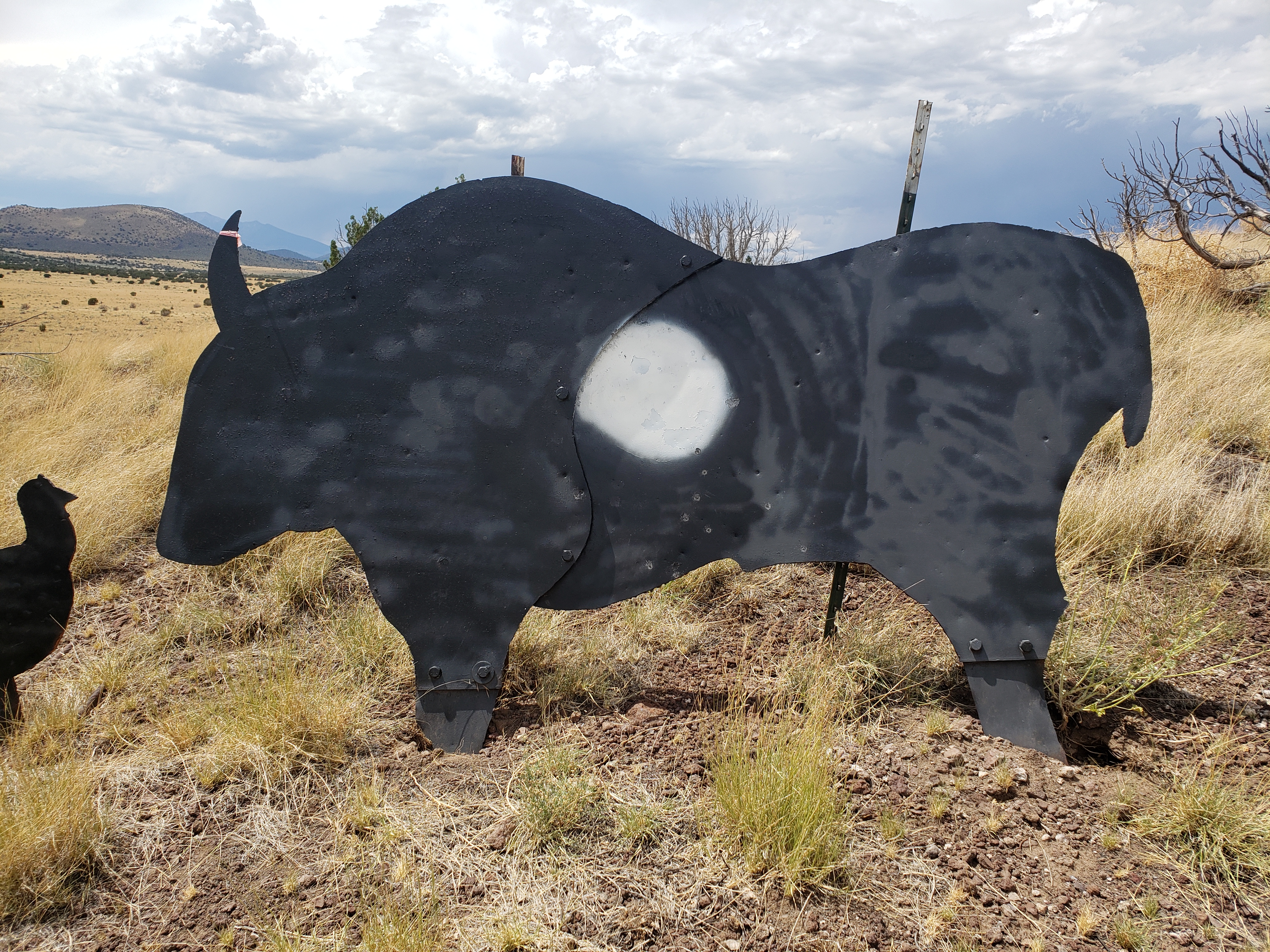

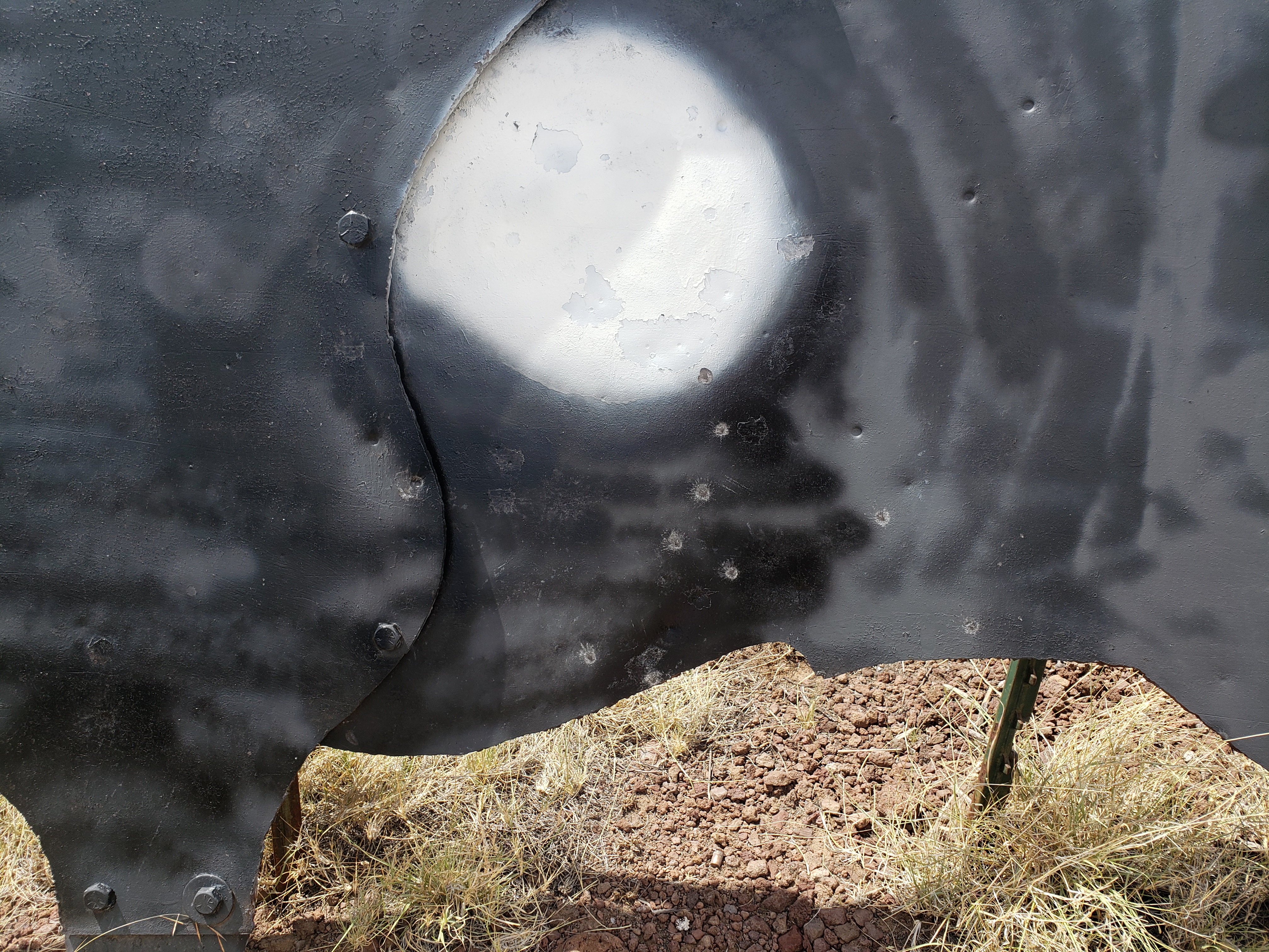

Long range report.
Yesterday when I went to shoot at my friends shooting range the wind was low so I immediately set up my V3 to shoot at this 421Y Buffalo with the Queens. By the time we got in the side by side and went to it, repainted it, came back, etc, the wind had kicked up a lot, OF COURSE IT WOULD, RIGHT??!! Then I had to figure out where the heck I was missing with 26.8 Mils elelvation dialed on and finally saw the dust kick up out of the grass way left. It also looked low so I dialed a few more clicks up and held 3 Mils to the right for the rest of the shots. We could hear the faint clanks as the 60 grainers hit the steel but we couldn't see where exactly I was hitting which as you can see were low.
I drove back down to see what was up. Here's the pics I took. The white circle is around a foot in size. I was pretty happy with these results! I think it was 12 for 12 because although we didn't hear one of the shots make a clank it appears that upon further examination I nicked the end of the ole peepee, lol. I meant to do that JK :LOL:
A while back my friends and I shot our iron sighted lever action 357's and 30-30's at this same Buff with much less precision. Well I know at least for my 357 lever rifle it only does 4 MOA at best at 100Y but its more so my/our older eyes seeing the sights correctly that come standard on these guns which were the main reasons we didn't do better at the Buff but its at least some kind of a comparison although very apples to oranges.
