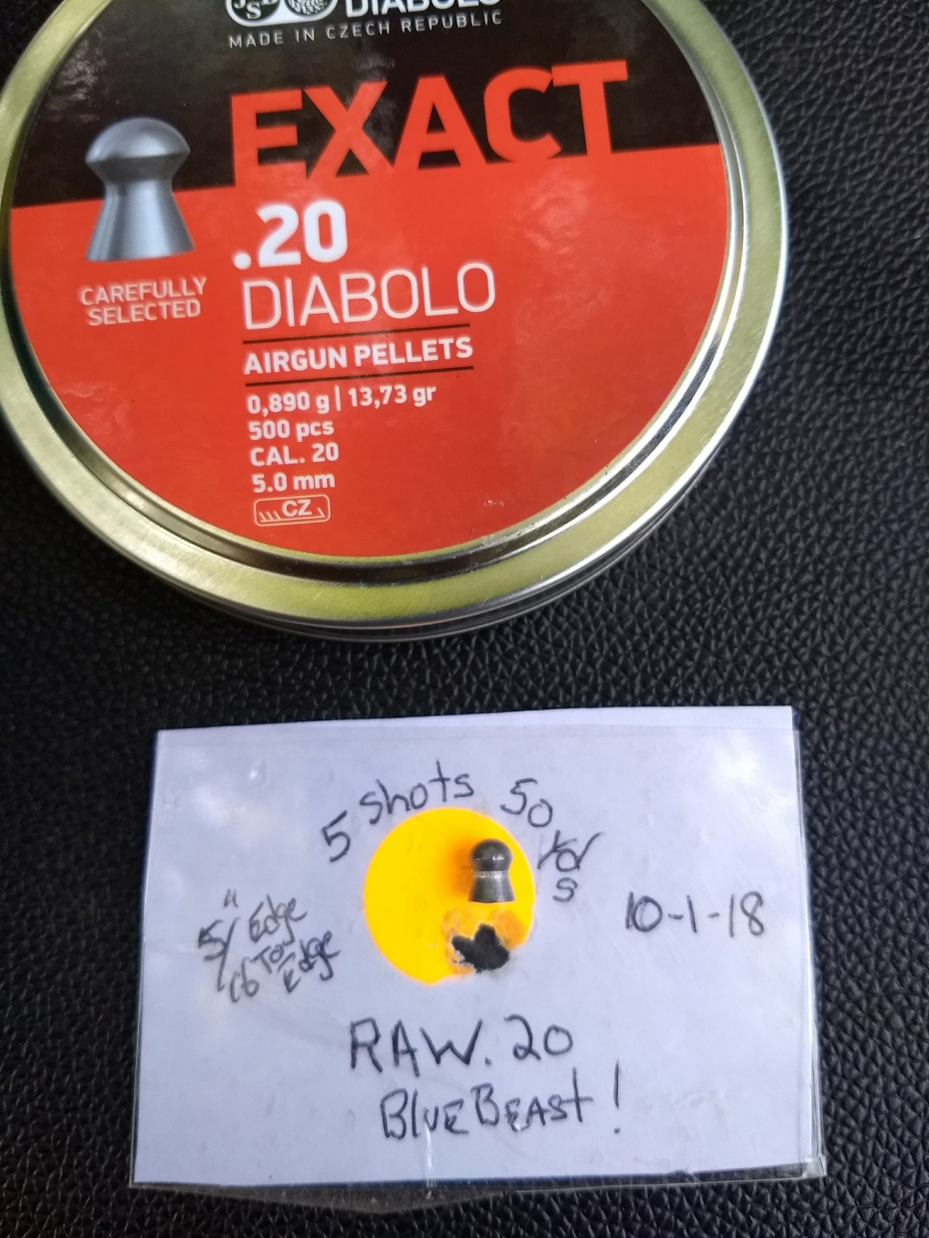

Here is a pic of a 5 shot 50yd group I shot with it off a bench in some wind believe it or not when I first got the rifle. This rifle has a ever growing list of people that have told me that they want to buy it lol. 2 guys from our club shot their first 250 bench rest cards with it within the last 2 weeks so it shoots well no matter whose behind the trigger. I think Martin Rutherford would make you one with these same specs if you called him at Airguns -USA and told him what you wanted. As you know .20 is that odd ball caliber but in my experience it certainly is a very capable caliber.
Sincerely, Kdog

Thanks Keith.
I've got a .20 on my Raptor. I wanted a poly but the guys at JSAR told me the same thing you did, no polys in that caliber. None listed in LW website either. I even tried to see if Tim McMurray at MAC1 could somehow get one, nope. Mine is choked. It has shot some quite impressive groups too, but nothing quite at the level of your blue beast.
