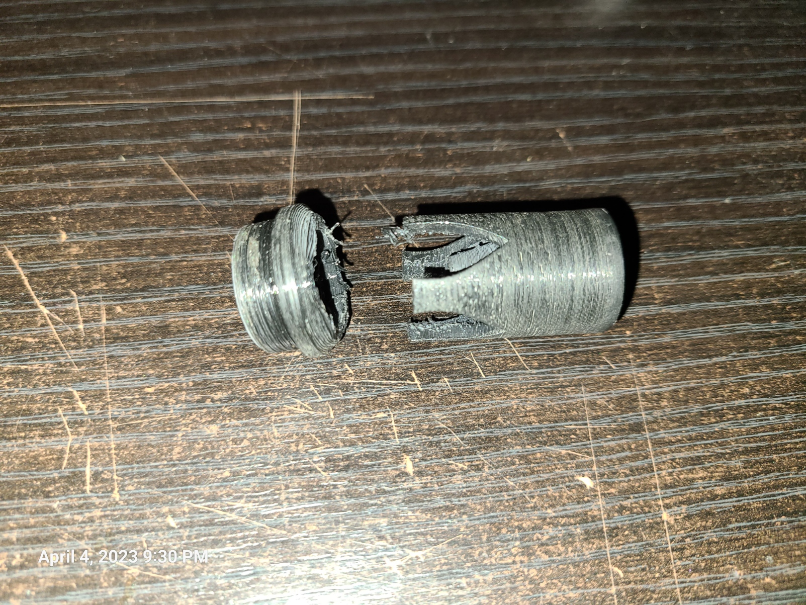

I was getting ready for the Cajuns Classic and I wanted to use the new vented moderator design but the dope was off on the closer yardages and I didn't have time to re-dope. I decided to go with the tried and true stripper, since my dope was pretty solid for it.
I got out to the bayou, had a slow start and then I got into my groove. Then, with four lanes left, I went into shotgun mode. Really struggled. Checked the scope mounts, stock screws, smoked crack, nuthin!
I was sighting in for day 2 and I reached out to make sure the stripper was tight. That's when I realized it had broken 3/4 of the way through and was hanging on by a thread!
Well, mystery solved. I thought I had packed a spare, but all I could find was the vented moderator. I had about 10 minutes to get re-zeroed and get the dope figured out. I think 20 more minutes would have been great. Surprisingly, I only did 3 shots worse than day 1, but it was not a good feeling having no idea where the pellet was going.

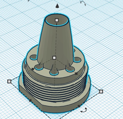

The vented moderator is also susceptible to snapping in half, so I went back to the drawing board. I was thinking I could print some baffles to go inside the HW97 muzzle tube, and maybe print a new end cap with some vent holes in it. I wasn't really feeling this, and as I printed the 3rd of 5 baffles, I had an idea. I really like the cone concept of the air stripper, but I don't want anything that is going to hang on the outside of the end cap. So why not make a vented endcap with a cone on the inside? So that's what I did.
When it prints, the cone is a little narrower and the air holes are a little smaller, but I'll test this out tomorrow and see if the concept works.

I'm going to call the vented cone cap a qualified success. I shot it today at 50 yards in ridiculous wind and it did as well as the other strippers in ridiculous wind. And the pellet holes were perfectly round. I checked it with the chrony and it's right on.
Interestingly, I had to click down 25 clicks at 50 yards to get it zeroed. I was worried about what that would do at 10 yards, but the 10 yard clicks are the same, just 25 clicks off. The vented moderator had about a 7 click POI change compared to the stripper, and the short yardage clicks were off by a yard. So I had to shoot a 10 yard target with the 11 yard clicks, etc. So the new vented cone cap appears to line up with the clicks for the stripper, with a 25 click offset.
I'll be testing and comparing all three next time there is less wind. If I think the vented cone cap needs improvement, the next thing to try is to make the cone longer/deeper so that it gives me about a 6mm gap from the crown to the cone. Right now the gap is about 50 mm because the muzzle brake is about 75mm deep. Might be worth printing a cap with a 45mm longer cone to try it, but I don't think it will be a massive improvement.

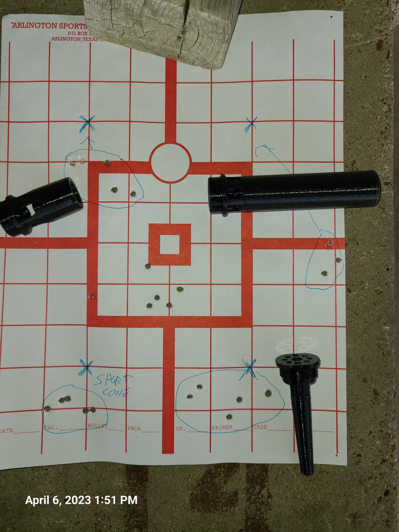

I made it out to shoot some groups at 50 yards today. The wind was still pretty strong, but fairly consistent.
In order from worst to best for group size, here's what I wound up with:
Worst - Vented cap with long cone
Next - Air stripper
Next - Vented moderator
Best - Vented cap with short cone
Since I've shot a few matches with the air stripper and it's fine, I was just hoping the one of the vented cone caps would be as good or better. And the short one is, so I'll plan to use this going forward. The vented moderator had a couple of shots go off the paper, but it was a decent group. Not a fan of the POI change for it, both the drop and the 2 inches to the right. I was surprised that the long cone cap shot so much worse than the short cone cap, but the paper doesn't lie. On the target, the air stripper is top left, the vented moderator is top right, the short cone cap is bottom left and the long vented cone cap is bottom right. The Xs are point of aim. The shots in the middle were warm up shots.

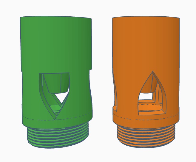

So I've gone back to the drawing board on the air stripper and designed a new version that it thicker. I'm also going to try flipping the triangular cut-outs. The reason for the shape of the cut outs was because printing circular holes in structural walls causes sagging. However, when I first designed the stripper I didn't realize that I would be printing it upside down, so the triangles are actually facing the wrong direction. Here are the two designs I'm talking about. I may play around with the shape of the air holes if I feel like I can get better dirty air flow. Possibly go higher with the air holes on the green one with more of a bevel at the top. Either way, the tube wall is twice as thick as the original, so it should be stronger.
