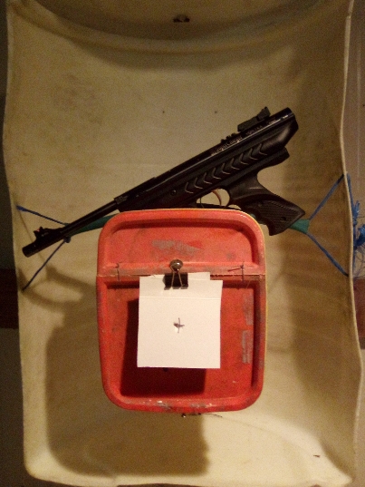

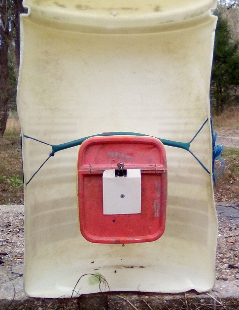

I use a bucket trap at 32' indoor .
I got pillow stuffing fiber backfill with old folded blue jeans up front . Been working well at 500fps gun power.
For extra flier protection I used a cut plastic 55 gallon drum .
With that it's been just hang it and bang it

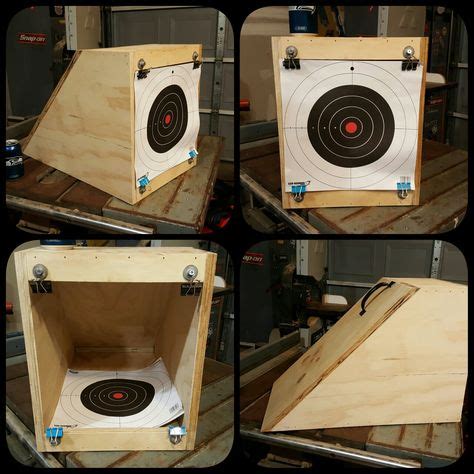

Now this type is what I was going to build but that above worked so well I put it off for a later date 🤤

At our club, we made boxes 22x22 from 1x4 and cut a slot near the front edge to accept a piece of cardboard for easy changeout. The back was some scrap steel plate 1/8 thick followed by some hardboard (Masonite) to stop the ping. Worked just fine the pellets flattened out on the steel with no bounce back.
