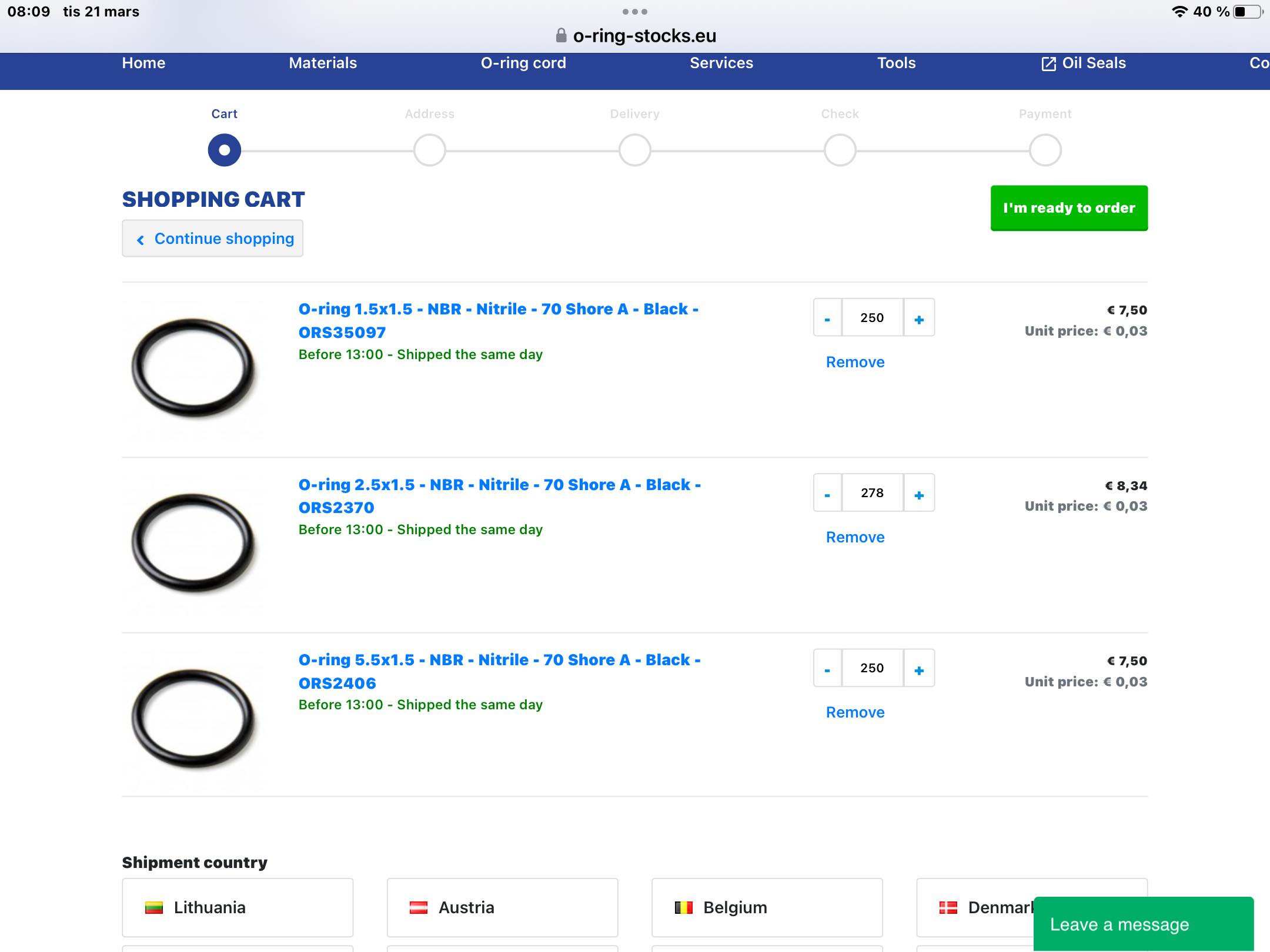

- Where do people source O rings?
- The O Ring Store
- O rings and More

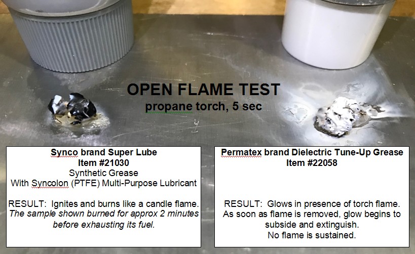

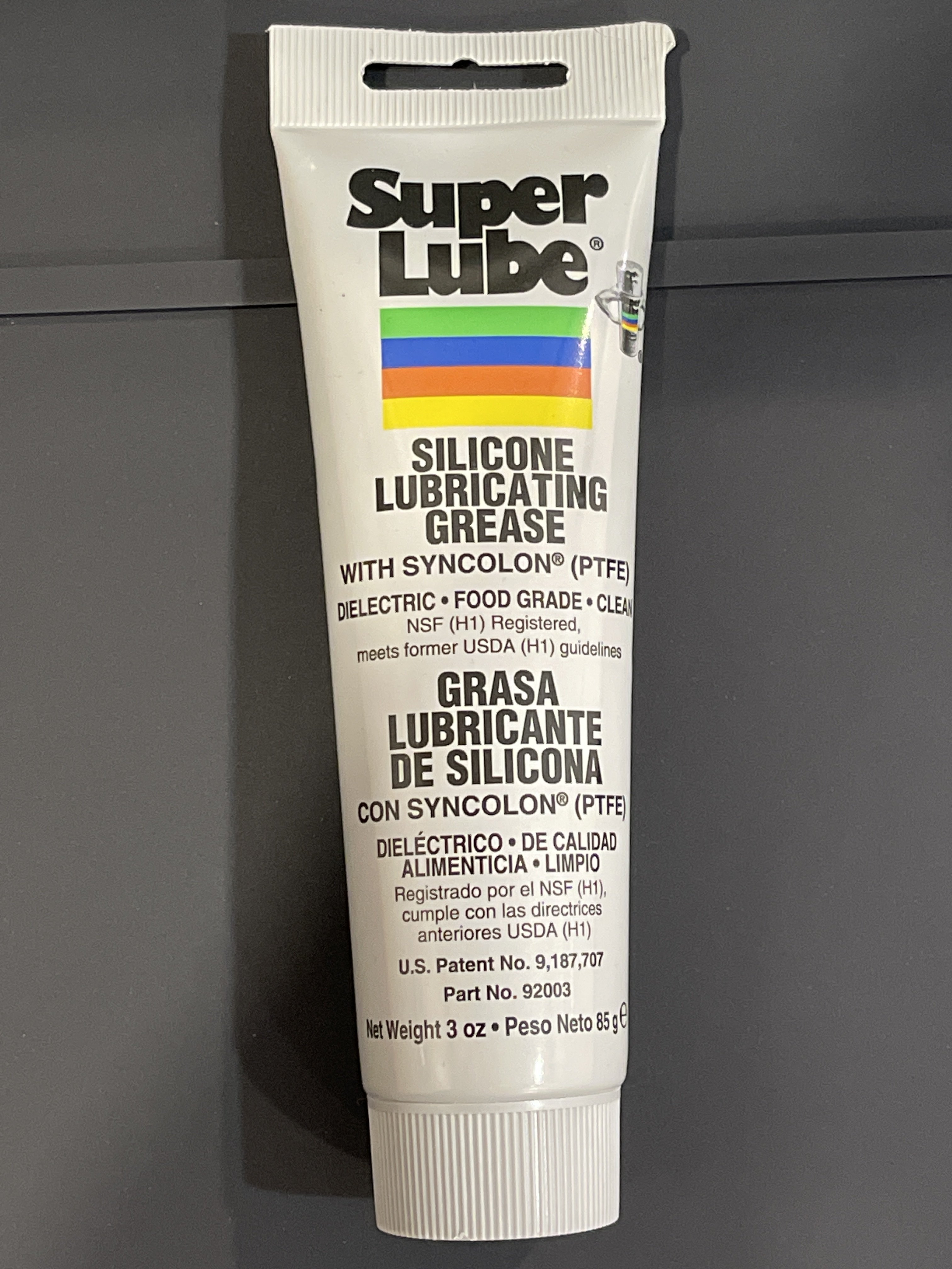

- NOTE- dynamic seals should use silicone OIL (30 weight, search for silicone shock oil to not get ripped off, it’s the same active material but marketed to RC car hobby), static should use GREASE. Light application is preferred. Alternatively poly o rings can use PFPE/PTFE lubricant such as Krytox GPL-205.
- Where do people source o rings
- The O Ring Store
- O rings and More
- Mcmaster-Carr
- Captain O Rings (their naming convention seems to be atypical so buyers should pay attention when placing orders, they use IDxODxThickness)
