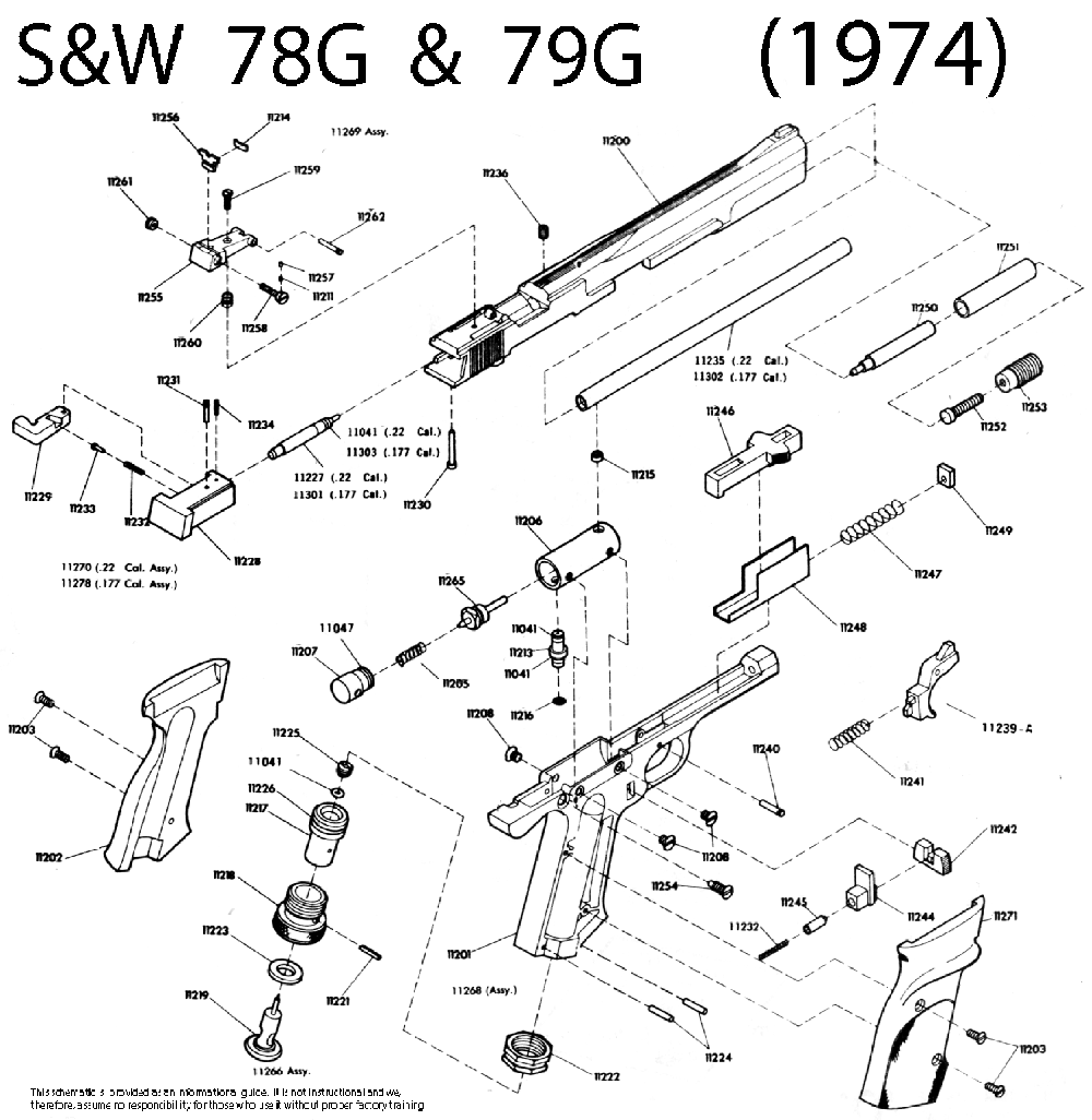

Orings all Urethane
11041 #006
11047 #012
11226 #113
probe buna can be used either 70 or 90 Dura
.177 #004 can be buna 004 in urethane
.22 #006 can be buna 003 in urethane
stem seal is 3mm or 1/8 thick has to be urethane but material is hard to find and not cheap use a 5/16 leather punch for the OD and 5/32 for the ID
stem has to be pressed apart and not pounded apart with a hammer
block of wood with a hole for the stem and a vice will work
the tube that holds the top and bottom together is a bitch to get out but take a drill bit the ID size and catch the metal a twist and pull and out it comes an easy out would do the same

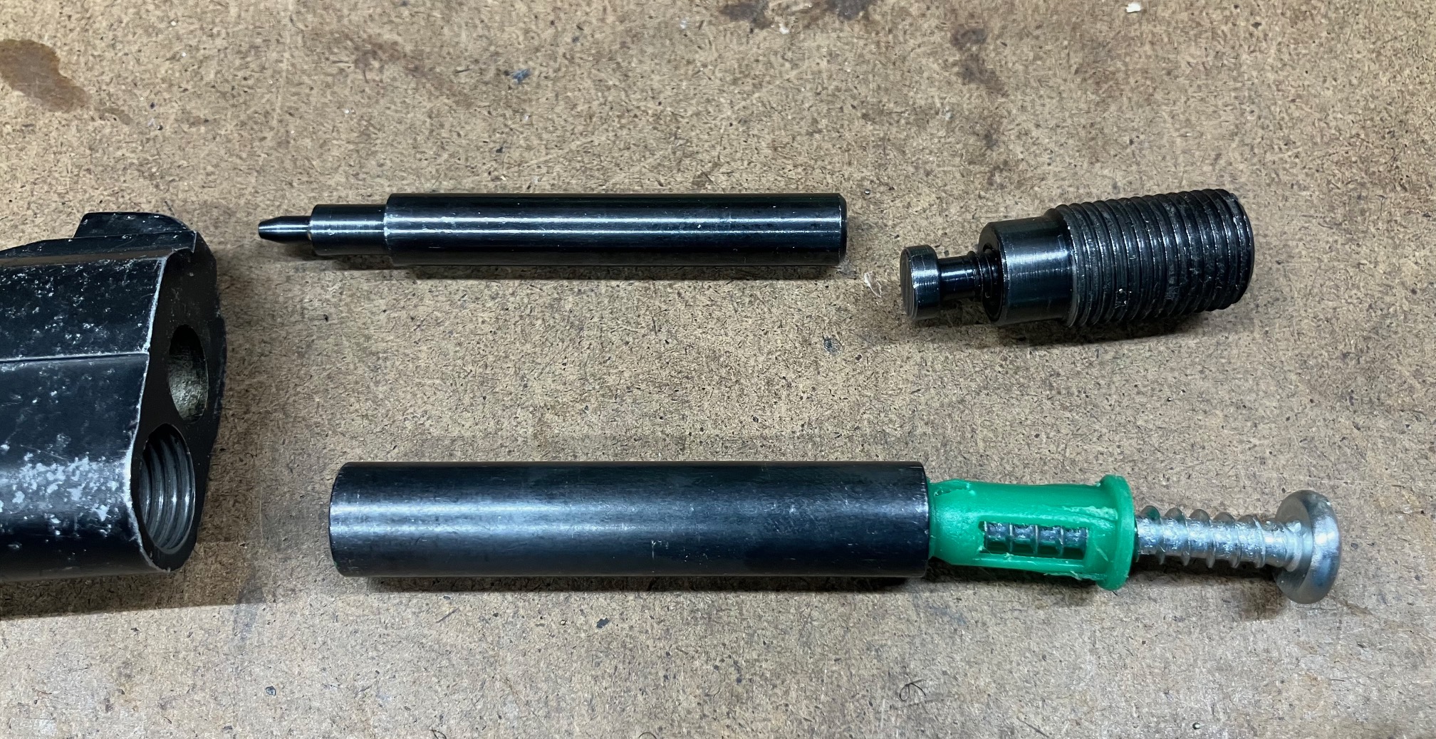

As for doing the re-sealing, I’ve found it to be quite straightforward. Only difficulty I had was getting the upper and lower halves separated … there’s a hollow tube that needs to slide out the front after removing the screw, and sometimes it needs a bit of coaxing to budge
Getting that extension sleeve out can be the hardest part of the rebuild. A wall anchor can help with the removal, and the plastic won't mar the metal:

Thanks Mike. Have you used Phil's service's before?
Mine is sitting partially apart for more than a year as I could not get the extension sleeve out and I pushed the project aside. I will be trying the drywall anchor hack.
I tried out different sizes before finding green ones at Home Depot that work well. The trick is to adjust the screw in the anchor to the point it needs to be lightly tapped into the sleeve with a hammer. Then tighten up the screw, which may require holding the end of the anchor so it doesn't just spin in the extension tube.

i think if i were doing these pistols all the time the extractor would be my go-to tool to remove the tube
it is easy to use but the again you would have to own one
