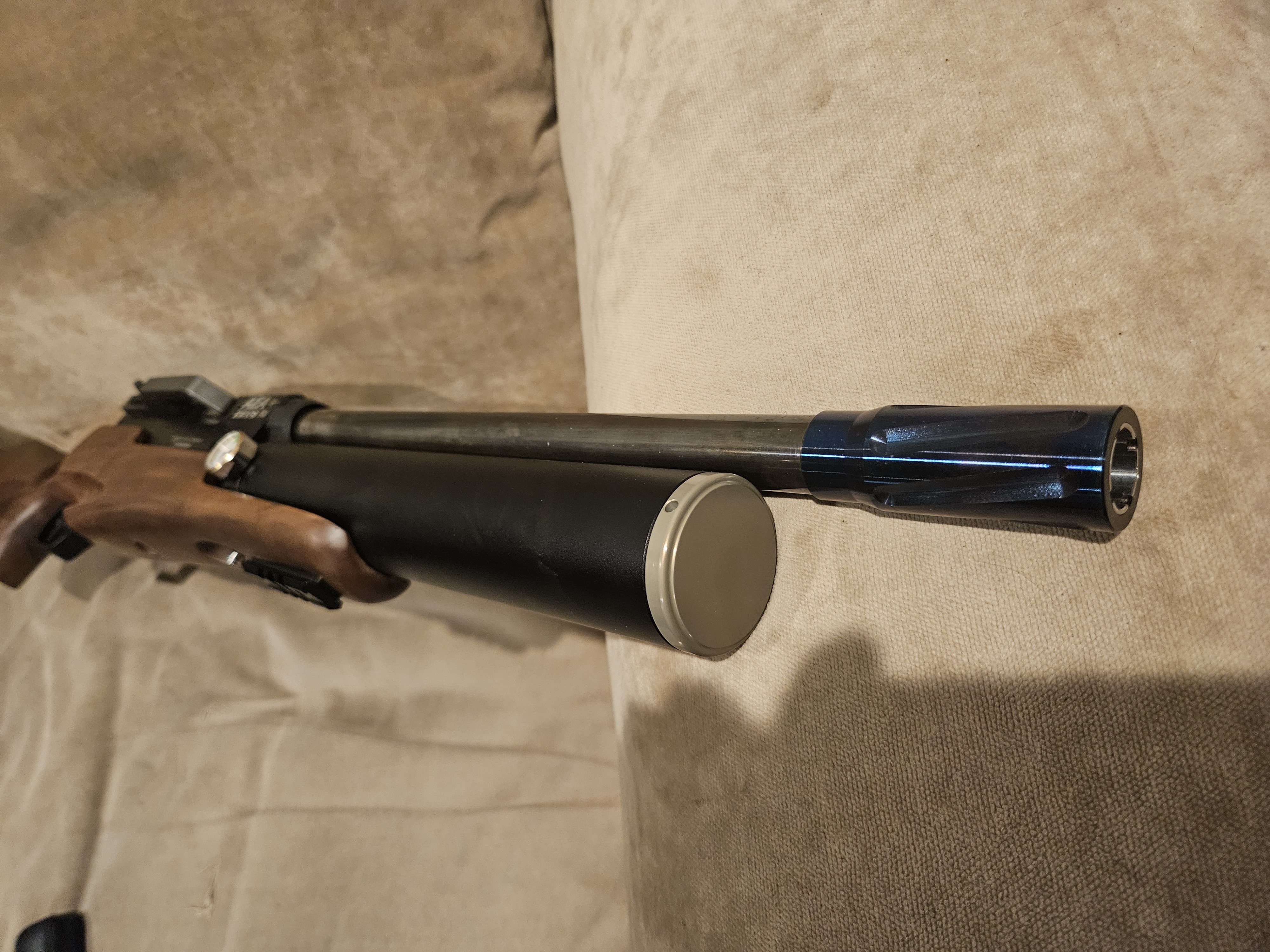

I just bought a 16" zeus 72 and had a texoma smooth bore I just finished putting on it. Haven't shot it yet, just making sure it holds air and it's all put together correctly before I try it. I have a few different chokes to try out also.
the texoma barrel fit like a glove, no info on how it performs yet though.

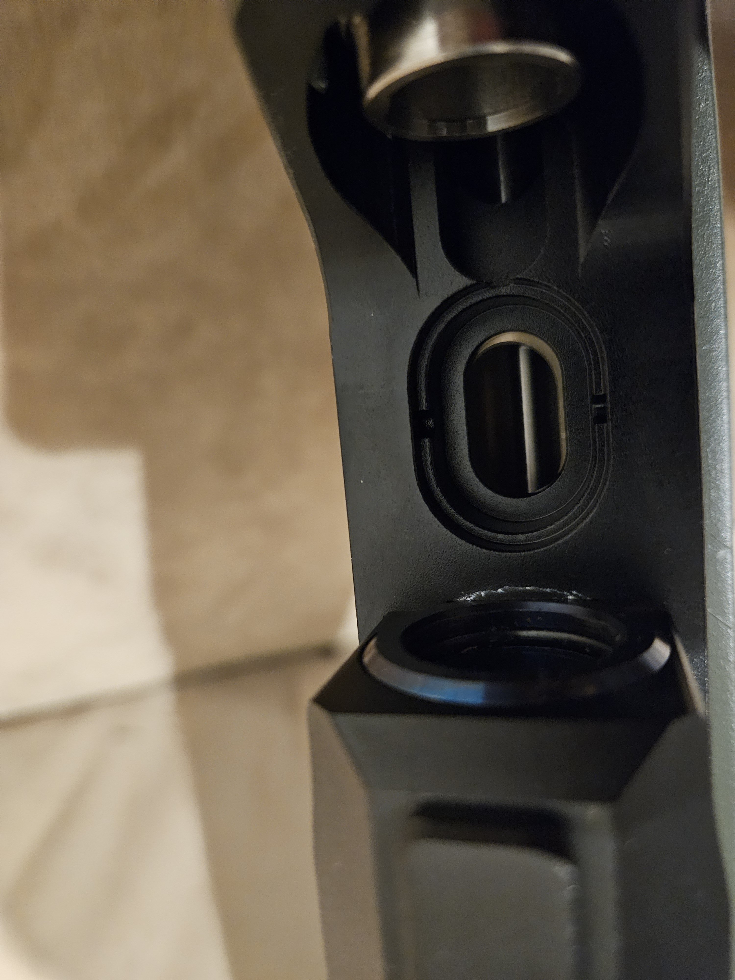

this is what's under the broken piece. You can see the gold colored material isn't centered. I'm guessing that when the air is blowing through its going through at an angle which is causing stress unevenly on the plastic piece which is why half of it crumpled in. Time to take it apart and see if I can make those holes line up lol.
Seems like something the person putting it together should have done...

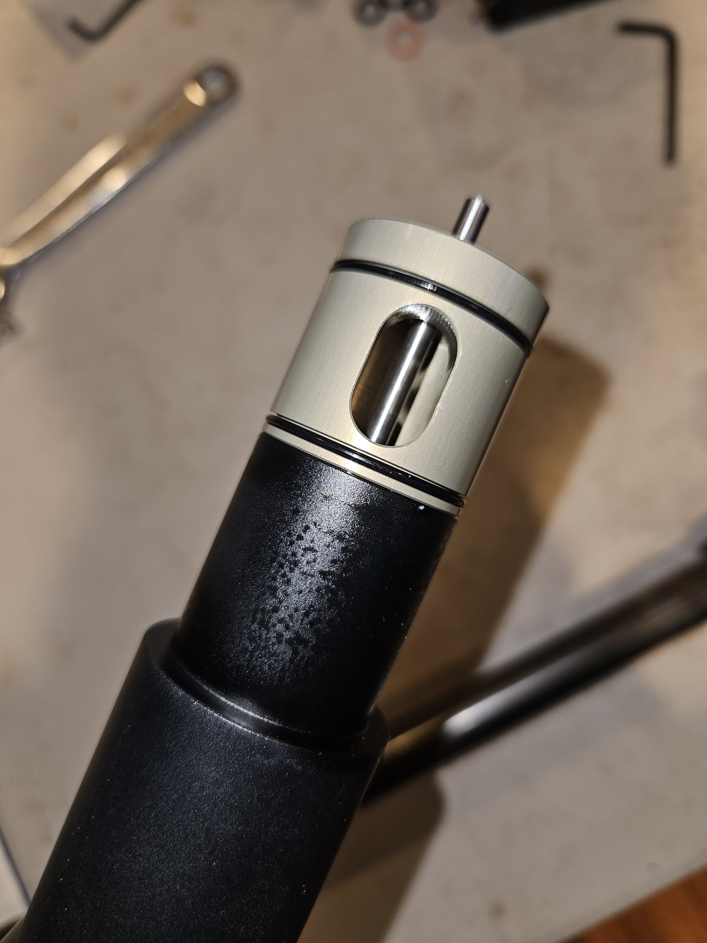

this is the air bottle for the zeus. A couple of the screws that hold it in place had come lose, it let the bottle turn a little out of place so that oval wasn't in line like it should have been. And after putting it back together now the rifle won't cock. LOL....
