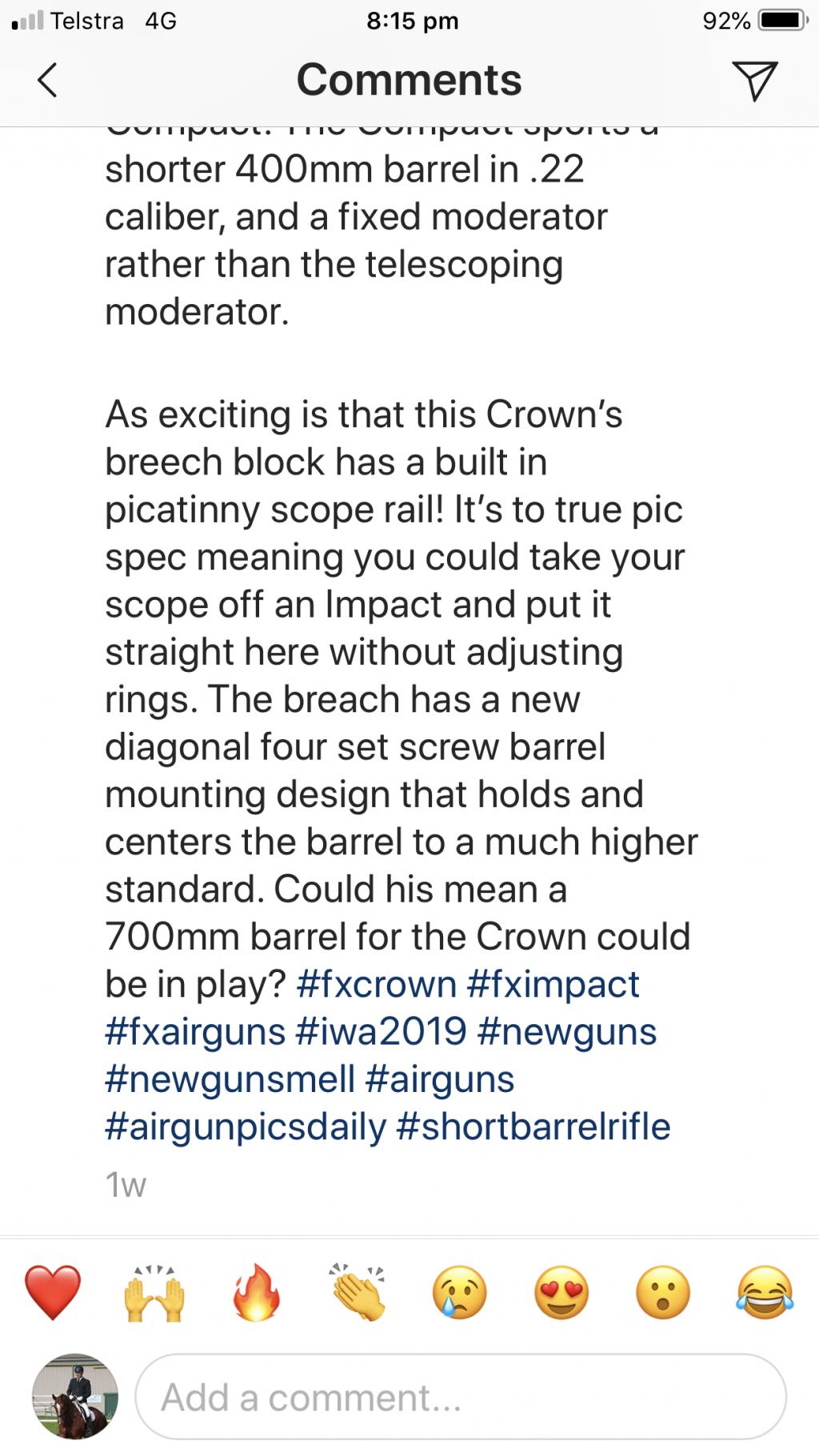

I think it is going to happen. Fx USA posted this on instagram.
Has anyone heard if this new barrel fastening system/breach block is going to be on all Crowns?
I’ve watched all the IWA videos and they only showed it on the new compact. I’m ready to buy a new Crown in .25 and then the IWA show throws this wrench in the works. First it was the new AMP regs so I held off buying.

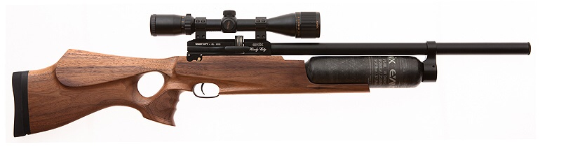

I do recall the Evanix windy city rifle has some sort of barrel band/support attached to the very end of the carbon fiber cylinder - don't know how it's attached (?epoxy) though and if it's really doing anything or for show?

1553238995_19018524285c948bd3ac4af4.87802850_D12EECBA-AFC2-49C3-9945-C6D6ED052931.png
for accuracy and consistency you shouldn't want a barrel band of some sort, for rigidity you could say it works. Barrel bands in almost all cases cause trouble in consistency over wider temperature ranges if there is contact with the barrel. Attaching it to the very end of the cylinder is indeed an option but during (de)pressurizing the end of the cylinder also moves around because the sidewalls expand and contract differently.
At the IWA show they said they were working on something to make the barrel with the shroud a more rigid system and it will arrive soon. Just wait and see because something is coming ;)
Their new breeches most probably will end up in the new crowns after some time but as far as I know there is no date announced yet. For now it is used in the super lite version of the crown (a light woods walker version basically). I like the new picatinny rails on top, only downside for me is there is still no 20 MOA cant included yet. Makes the use of most scopes a lot easier and you don't have to use adjustable mounts anymore :)
