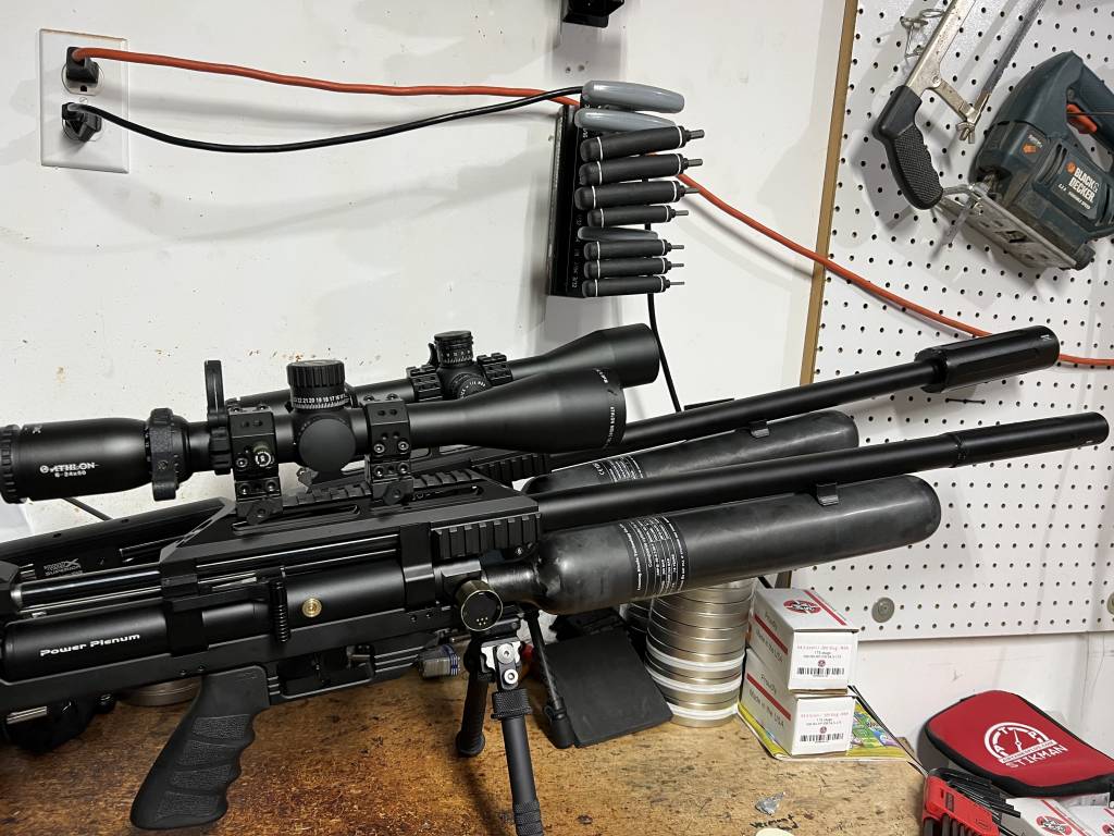

Got the bottle valve adapters from Talon Tunes and they are the fully threaded 300bar ones for the M3. Holy smokes on the first fill; take it slow and let the bottle cool down some even with the slow fill. After the bottles fully cooled down then I hooked them up to the Hill and filled up to 300bar. Can't wait to start shooting with them tomorrow.
The bottles are a tad more narrow and still don't look weird with the 700mm or 800mm in .35. Will post back with shot count after a few fills. I don't let my bottles drop below 155bar so I should have a pretty nice shot string. I am coming from using 580cc 300bar bottles and have a few 580cc 250bar as well. The plan is to try each one and report back with the numbers...

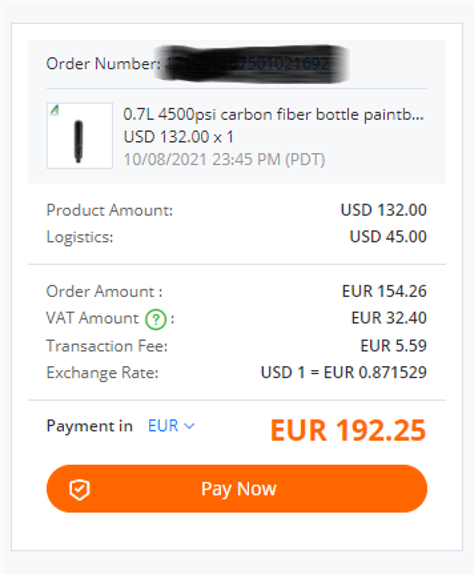

They indeed ship it with a fast shipping service, therefore the price.
Shipping fee in my case was USD 45 and i got mine delivered in 7 days.
Btw : 192,25 € is about 220 $

Mine has just arrived. Impressive looker to say the least. Still waiting on my valve from EuropeAirguns Spain.

ram2jeep

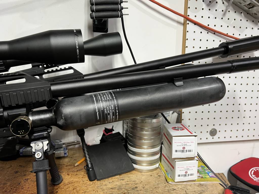

About those barrel-bottle supports you ve mounted : Any disadvantages ?
Ex.Magnum, those wedges are for barrel support to help with harmonics. Since I've installed them my accuracy has increased. I have carbon fiber barrel sleeves as well but the wedge holds the shroud and doesn't allow it to bounce/move; stiffens everything thing a bit more.
I have been using the wedges on my Maverick and both the Impacts 2 and 3. The wedge helped greatly on the M3 as it is in .35 and with the Ronin on the end there was a slight drop in POI vs POA. The 700cc bottle is more narrow than the 580cc so after I changed the bottles I needed to adjust my zero again due to the extra room.
So i guess you ve put those wedges in place moving them up and down until you found the right spot for what you wanted at the energy-level you were shooting? Something like that?
What are they made of ? Some kind of hard rubber? Or carbon fiber? or some 3D printing plastic material ?
Exactly correct! I moved it back or forward to find the proper placement as dictated by groups at 75yards. I purchased them off of EBAY and once i found the best placement I installed some tape on either side to make sure they stay and if I move the wedges I have a fairly close idea of where they should be. I use them and man do they stiffen things up even more than the liner sleeves; even installed with the FX barrel tuner and my groups were good without the tuner but even better when I installed the tuner…
