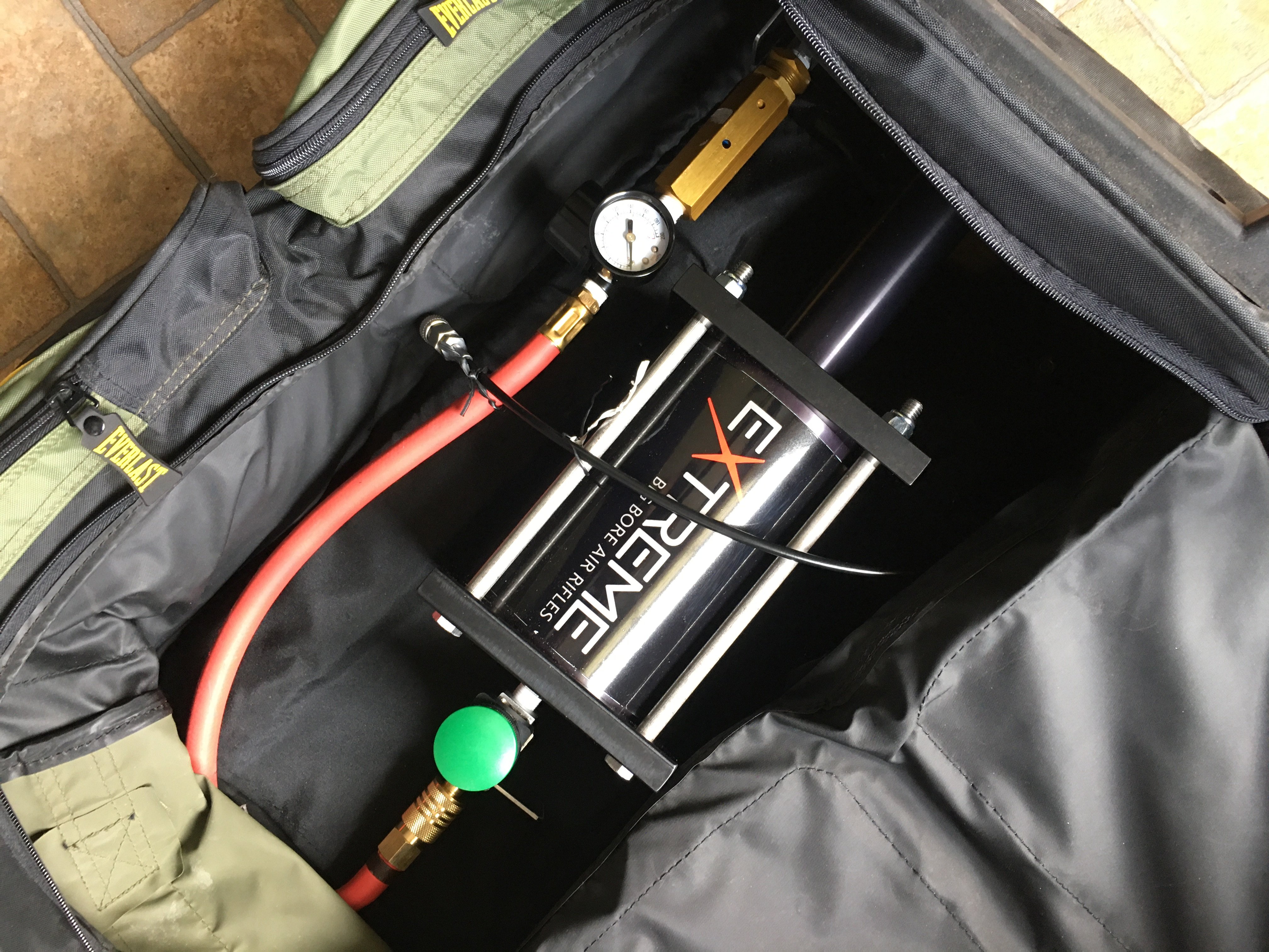

Same here.I use a 494 cu ft steel Nitrogen cylinder,and I also utilize (2) 97 cu ft 4500 psi Great White carbon fiber.I have a booster pump from Extreme Big Bore to help me run that steel down low before its time for a swap

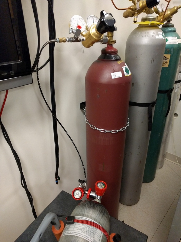

Agreed on the regulator being optional for many, especially if one is filling anything in excess of 300cc or so. I direct fill my guns and prefer to use a reg whenever the tank is above 3000-3500psi. The reg has a DIN300 connector so I can also connect it to my portable tanks for tethering.

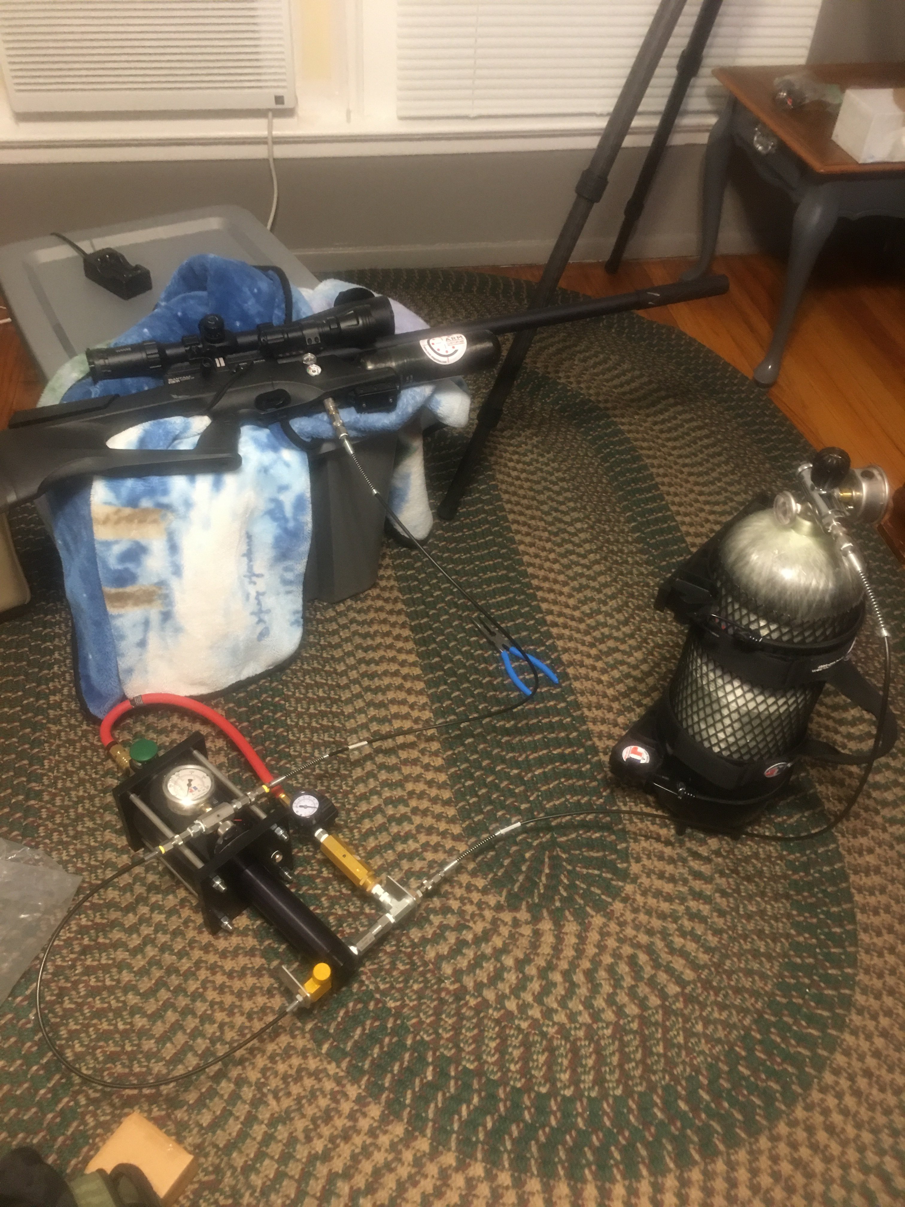

My cylinders are currently near the lower end of usefulness, one is 3200psi, the other is 2400psi. I was planning to exchange a cylinder this week, but today received word that my booster would ship either Friday or Monday. I plan to wait on the cylinder exchange and stretch these as far as I can. Typically I am filling 200-300cc tube guns from 1800psi back to 3500psi. If the booster enables me to wait until 2024 to exchange a cylinder I'll call that a win. Once I get to the point where I have to exchange a cylinder I'll be sure to update the thread.

Definitely wait on swapping or filling your cylinders until after you get the booster pump.My booster can make Nitrogen last much,much longer .My steel tank still has 4000 psi in it.With the booster,I get so many fills its scary

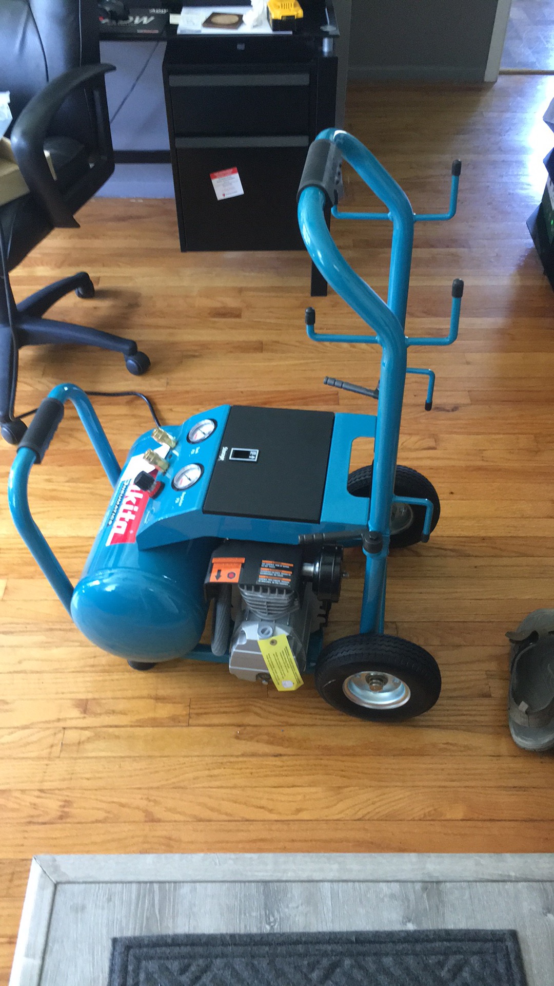

I am using this to drive the piston of the booster pump,so I save way more of my Nitrogen this way

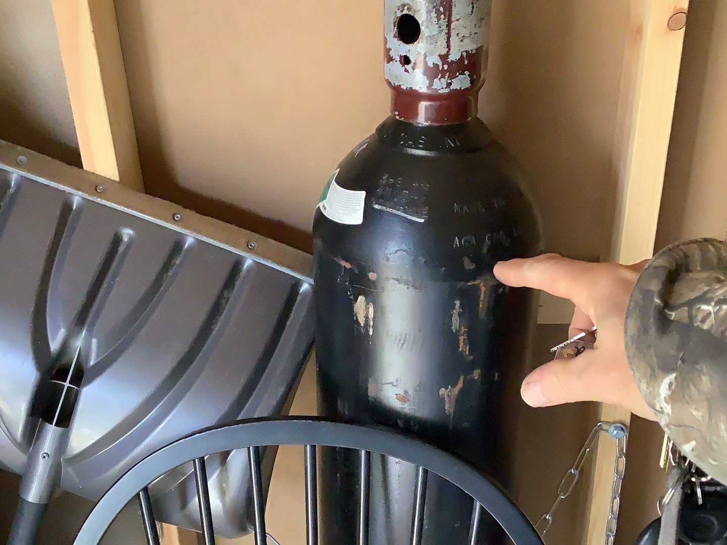

Thanks for sharing those details. In this area all of our 6KN2 cylinders are green, I have never seen a black one over here. Initially plans are to both feed and drive the booster with nitrogen. Depending on how much nitrogen this consumes will dictate if I change over to my shop compressor driving the booster.

I wish i would have gone aryytek too,I’m thinking , being that Extreme Big Bore and the warranty to my booster are dying,although ,this thing will most likely work fine for a long time especially given how little I have to work it.They tell me if you dont use a shop compressor and just use your N2 to drive booster,it eats up ALOT MORE gas.I may order an Arrytek booster still just to have a back up.These things are amazing if you’re either shoooting big bores or else shooting small bores with N2 like me.The idea of ordering these pumps in the USA is appealing to me.But Extreme Big Bore was up for sale ,other than that their booster dies.Altaros has been around for a minute and they say have excellent service( but in Czech Republic) and are aboutnthe same price as the one you’re getting.The one I have cost about what the Maddogg stock pump costs by the time I bought extra whips and gages. Its a pain in the but to hook up shop compressor and booster just to fill rifles,but its soooo fast and efficient its crazy.Those Nitrogen cylinders are heavy when the time comesMan,those things are a ball bust.This 494 cu ft steel cylinder is a total ball bust

This is an interesting thread. I have a high dollar Bauer 4 cyl compressor, so I will not be doing this nitrogen thing, but I see the attractiveness of its use. I am also a user of industrial gasses like Helium, Argon, Oxygen, Acetylene and CO2. I used to lease my tanks, but I made a deal with my supplier that allowed me to buy new tanks and exchange them with him for full ones as if they were his leased tanks and I just pay for the refill and delivery cost. The supplier takes care of all the tank testing costs as if the tanks were his. Effectively, this one time purchase relieved me of the annual demurrage costs forever. I'm pretty sure other industrial gas houses will make a similar arrangement for you if you ask nicely.
