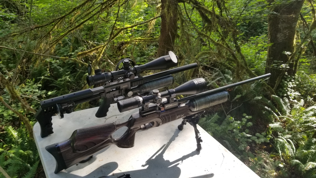

I have both the 25 and 30 caliber in 700 mm I enjoy the performance of both barrels. I find the 30 is better with the wind over 125 yards at 100 yards they are pretty close. I have the previous model Impact not the Mark ll. Other than the ammo costing less in 25 caliber and there is a slug liner in 25. The choice is yours you will have a nice gun either way.
