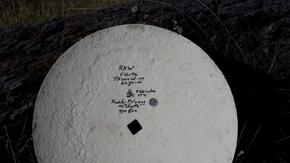

60 yd Benchmark group for .177 Polymag "Shorts" (JSB). Test posting method.
60 yards 0.60" ctc from RAW TM1000 at an overthetop 970 fps.

The little "short" .177 Polymags can do very well in reasonably stable air.

Hi Harry. Does that TM have a polygonal barrel or L&G's? Are those pellets shooting that good out of all of your .177's? I know you know your stuff, I'm just not sure if the magic is from the rifle, the pellets, or a needed combo of both to get that good of a group.
When you say reasonably stable air, were you shooting in dead calmness for this group? Holding off at all, or just squeezing them off when you see the flags drop, leaves stop moving, heat mirage rising straight up, and you don't feel a thing on your skin?
. Also, is 970fps the most accurate you've found these pellets to fly at?

The TM 1000 was an early rifle with standard LW barrel James, not polygonal.
The .177 Polymag shorts shoot extremely well from my three .177 rifles, the TM1000, the FWB 124 D and the FWB 300 S. Of interest they also do well from a 100 yr old vintage BSA bell target rifle!
Stable but not dead calm - some. small amount of hold off from memory - late afternoon at the farm the air is often quite predictable as it sinks down from higher country. Sometimes I prefer that to "dead calm" which is a seldom known state. Release some scotch thistle down or feather down and it seldom falls directly to the ground but will climb and swirl about and float off. Pellets have to negotiate all of that. But when the air is just streaming by to a lower pressure zone, whether gently or even quite strongly, it is easier to predict and the pellets can settle in to a stable flight attitude with heads slightly into the wind.
I find all the Polymag pellets seem to like a bit of speed. Though their bc is lower than our best round nose JSB pellets and they drop a little more at longer ranges, I find particularly these .177 shorts and the .25 Polymags are some of my most accurate pellets. ... I would not be without them for certain "purposes".
