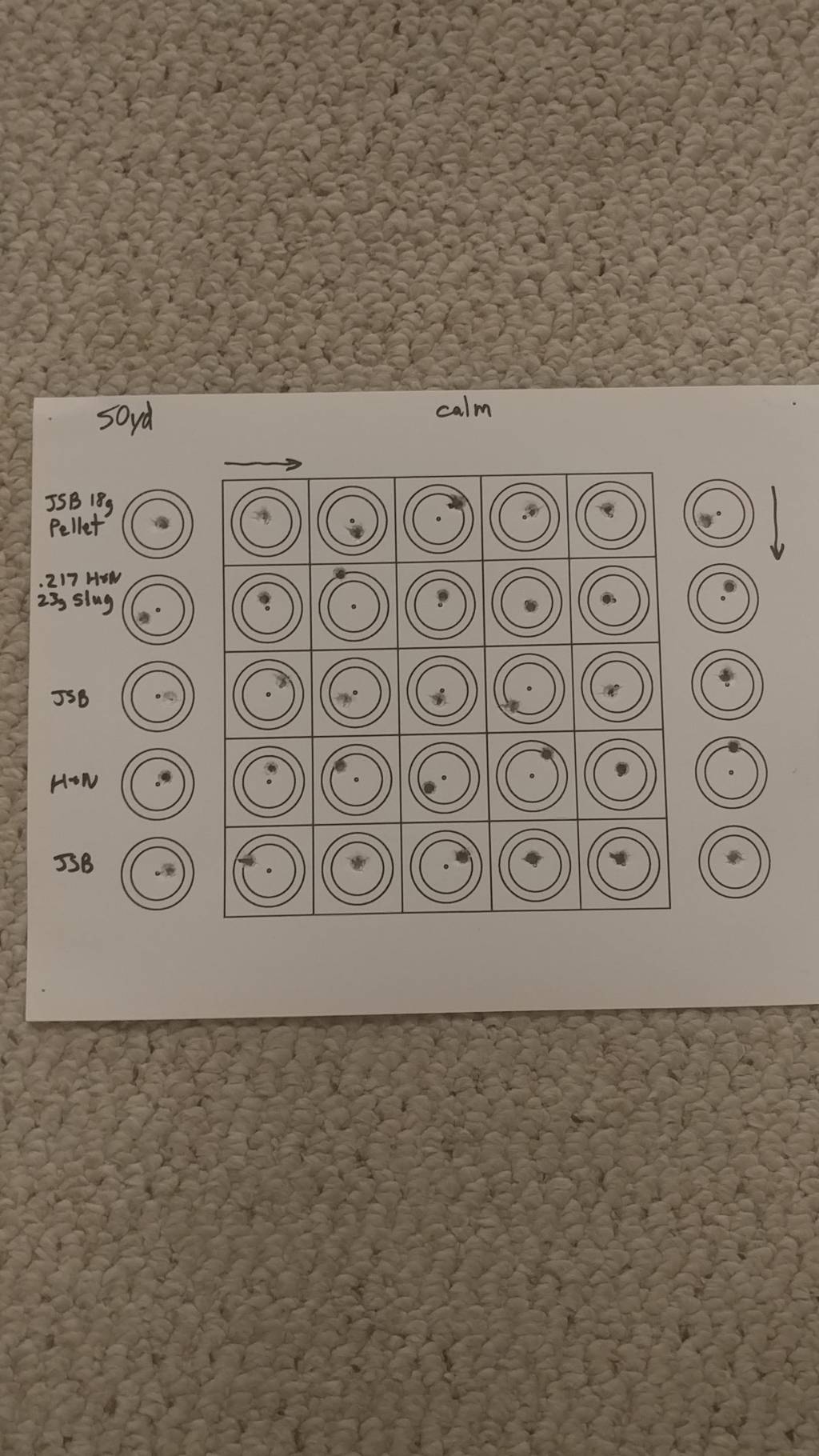

50 yard target alternating between pellet and slug

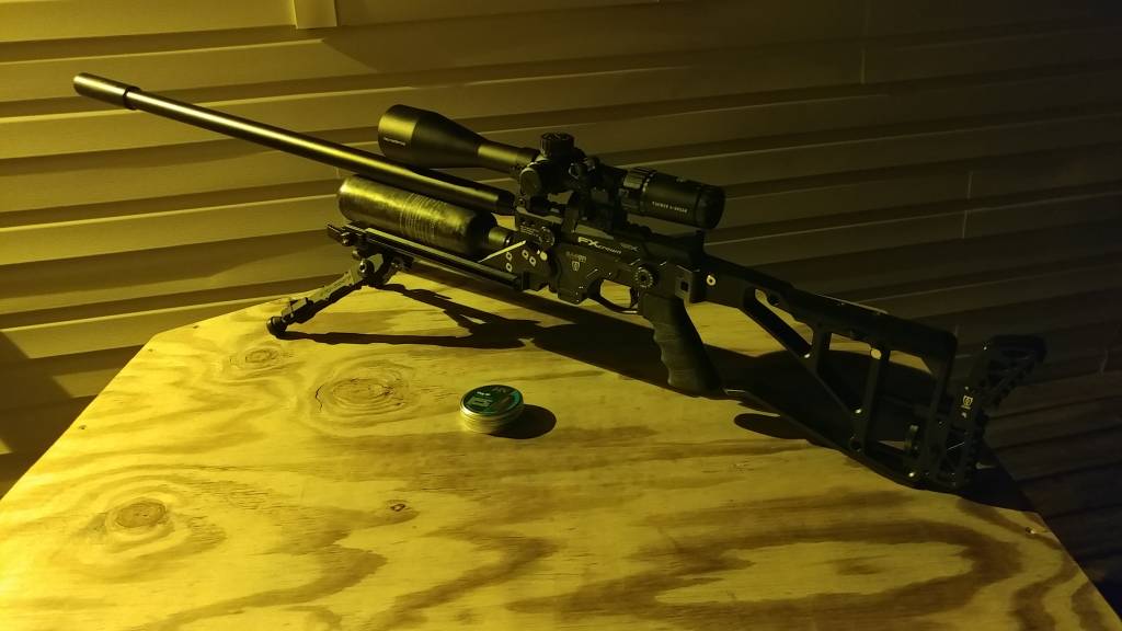

Crown MK1 in Chassis w/ 700mm Superior alternating shooting:
JSB 18g pellets @ 870fps and
.217 H&N 23g slugs @ 939 fps
I shot this target at 50 yards tonight in calm conditions:
I shot the target left to right and top to bottom beginning on the 1st row with pellets(Crown Power Wheel setting on "C"). Then changed the PW setting to "Max" and clicked scope to re-zero for slugs. Fired 5 shots to season barrel and shot the 2nd row. Then changed the PW setting back to "C", re-clicked the scope back to the zero for pellets, fired 5 pellets to season the barrel, and shot the 3rd row and so on back and forth until the target was complete.
I've had some inquiries about issues/problems shooting slugs and pellets out of the same barrel. I have shot different ammo out of the same barrel so many times comparing one to another and have never had any issues or problems.
