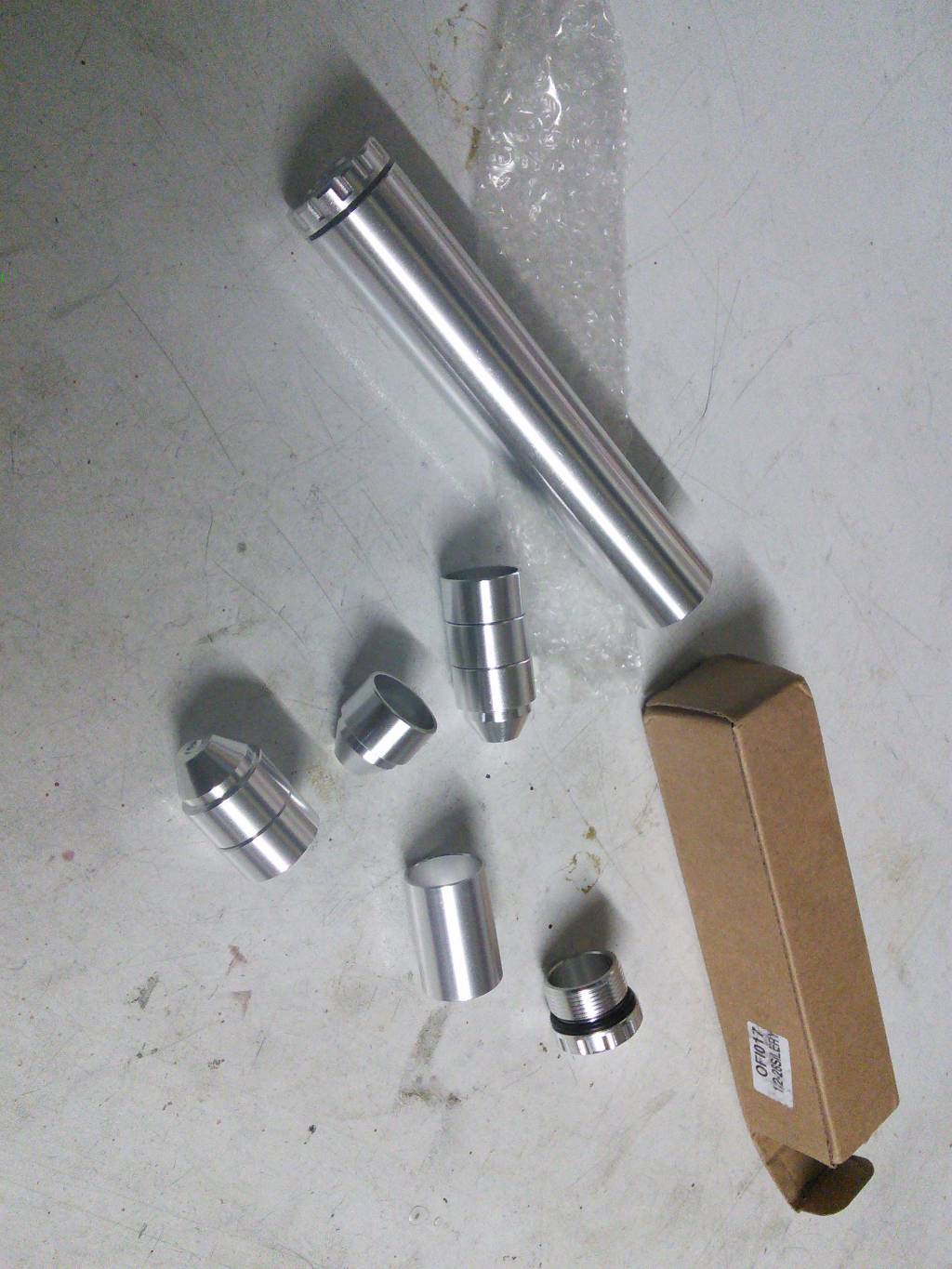

Also throwing in the best kept secret: aluminum conical baffles and spacer to silence an empty shroud. 7 baffles come as part of a Chinese oil filter from Aliexpress for around 8 usd. Need a table drill to make holes in function of your cal. I always manage to make them fit. Either as is, or by adding a piece of metal broomstick around them as a spacer if the shroud internal diameter is too large. (Pic only shows 6 baffles b/c one is already "on the job") 🐦

Briefly coming back to that Ali oil filter (which should be available Stateside for that same 8 bucks). Some on a low budget (or just being creative) have finagled it into a low-cost and rather effective silencer. The only trouble is the thread. It is not entirely the same as 1/2unf, but close. It worked on my Flashpup, parrots have expired at its hands. It also silences my Artemis pr900w quite effectively (attached with a plumbing connector).
I also saw recently that one Ali vendor is now selling this oil filter (powder coated in black) for around 10 bucks with an 1/2unf adapter included. 🐦
