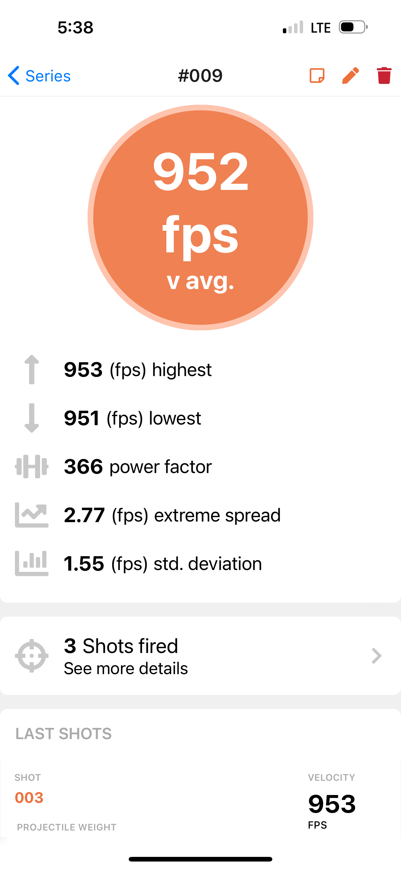

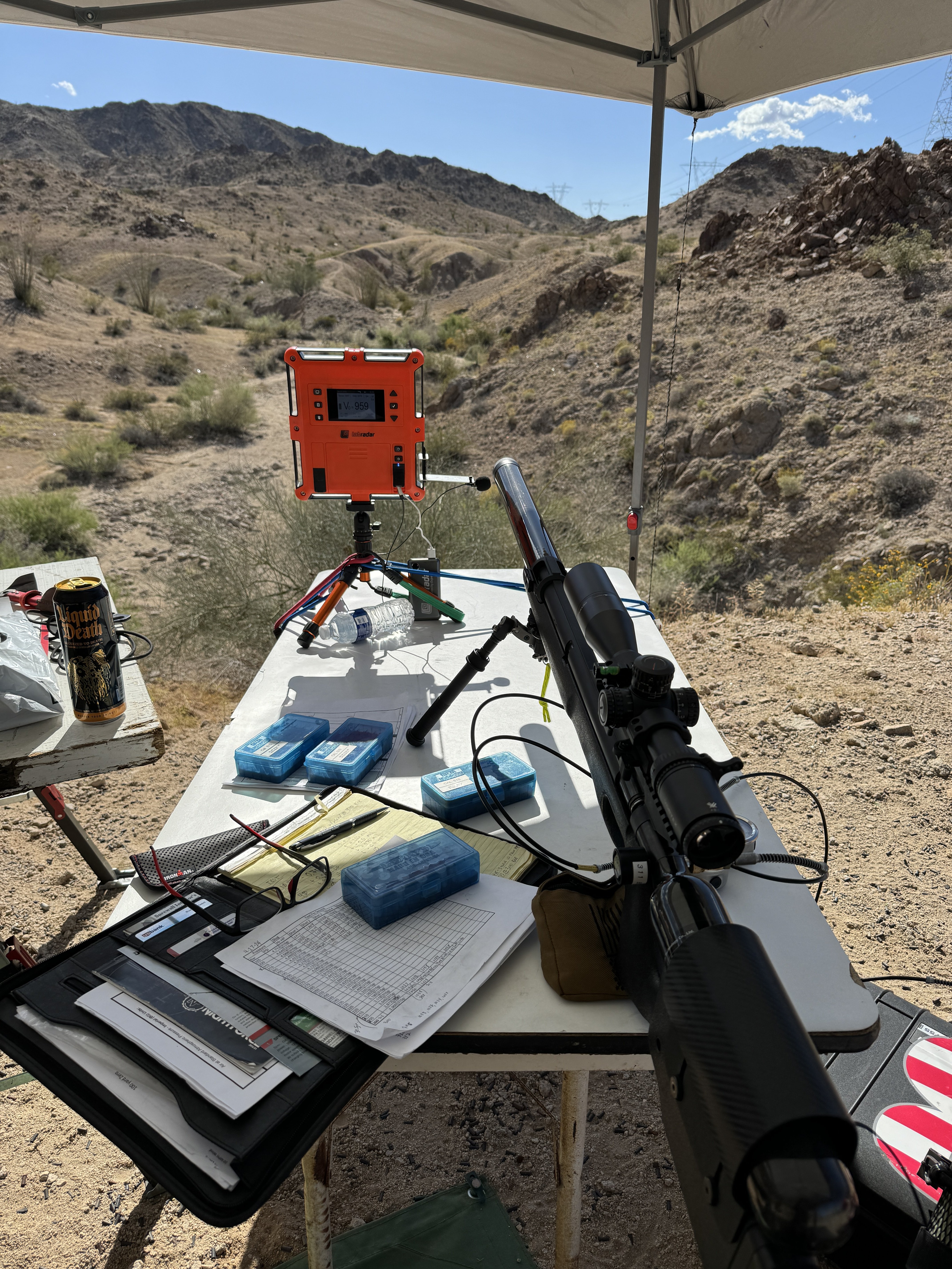

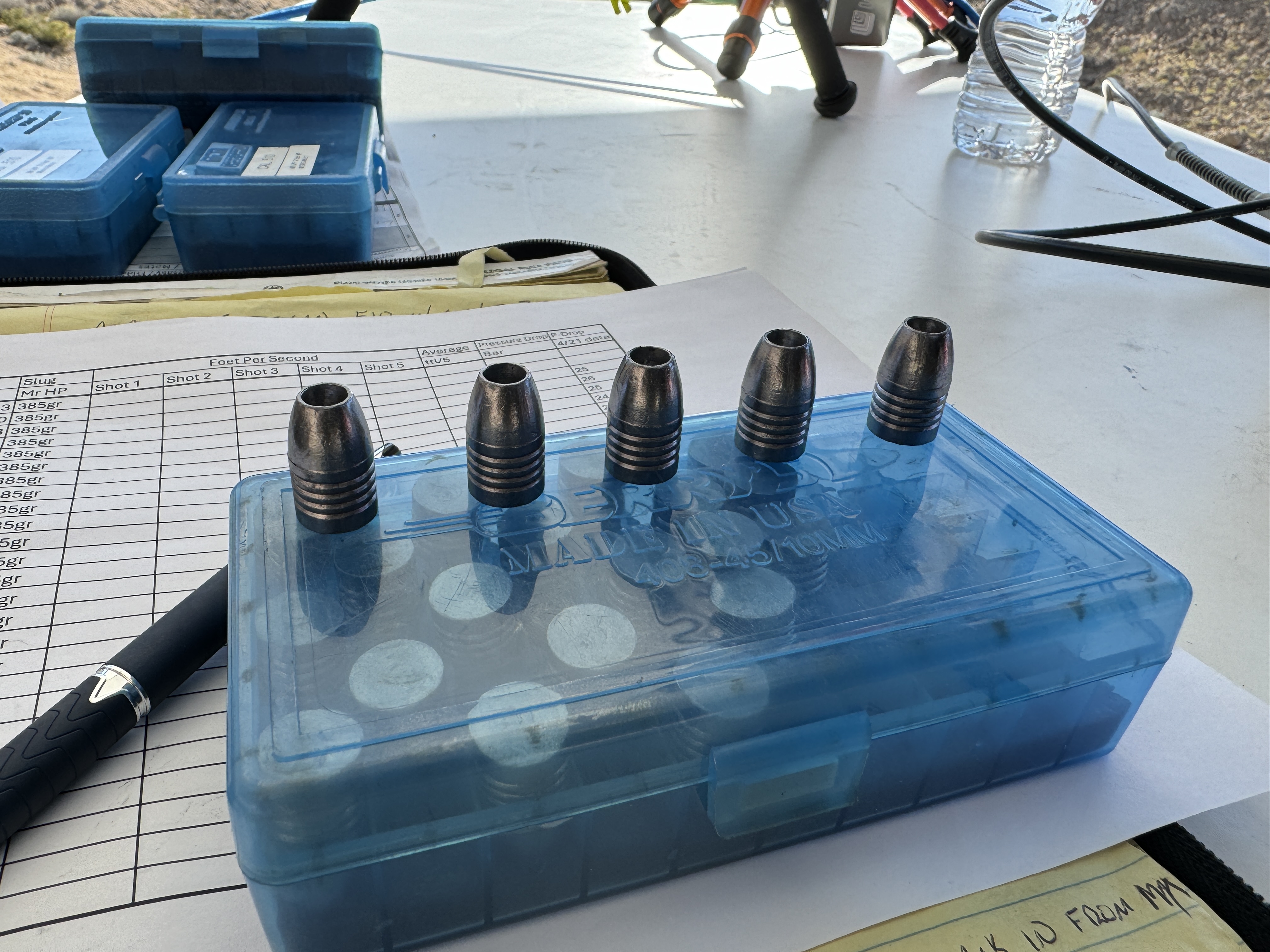

The Texan .510 will perform well with most any slug. I’ve personally found the neilsons fly straight, but the smallish hollow point and harder lead can cause the bullet to fail to expand. I personally use Mr. Hollow Point slugs and they are game stoppers. When your rifle is properly tuned, it will sling the 255gr Mr. H.P. at just over 1,000fps and easily stop a 400lb hog with no problem. Last time out hunting I used the Mr. H.P. 385gr micro as it bucks the wind better then the 255gr and I can personally vouch for just how deadly each of these slugs are. Now either of these slugs will shoot close to a 1” group at 100 yards, but at distances beyond 200 yards the 255’s will loose accuracy, and the 385’s will hold true out to 600yds. HOPE THIS HELPS!
If you have a good reliable chronograph, I can walk you through properly tuning your rifle, if you don’t have a good chrony, just shoot the thing and have fun!

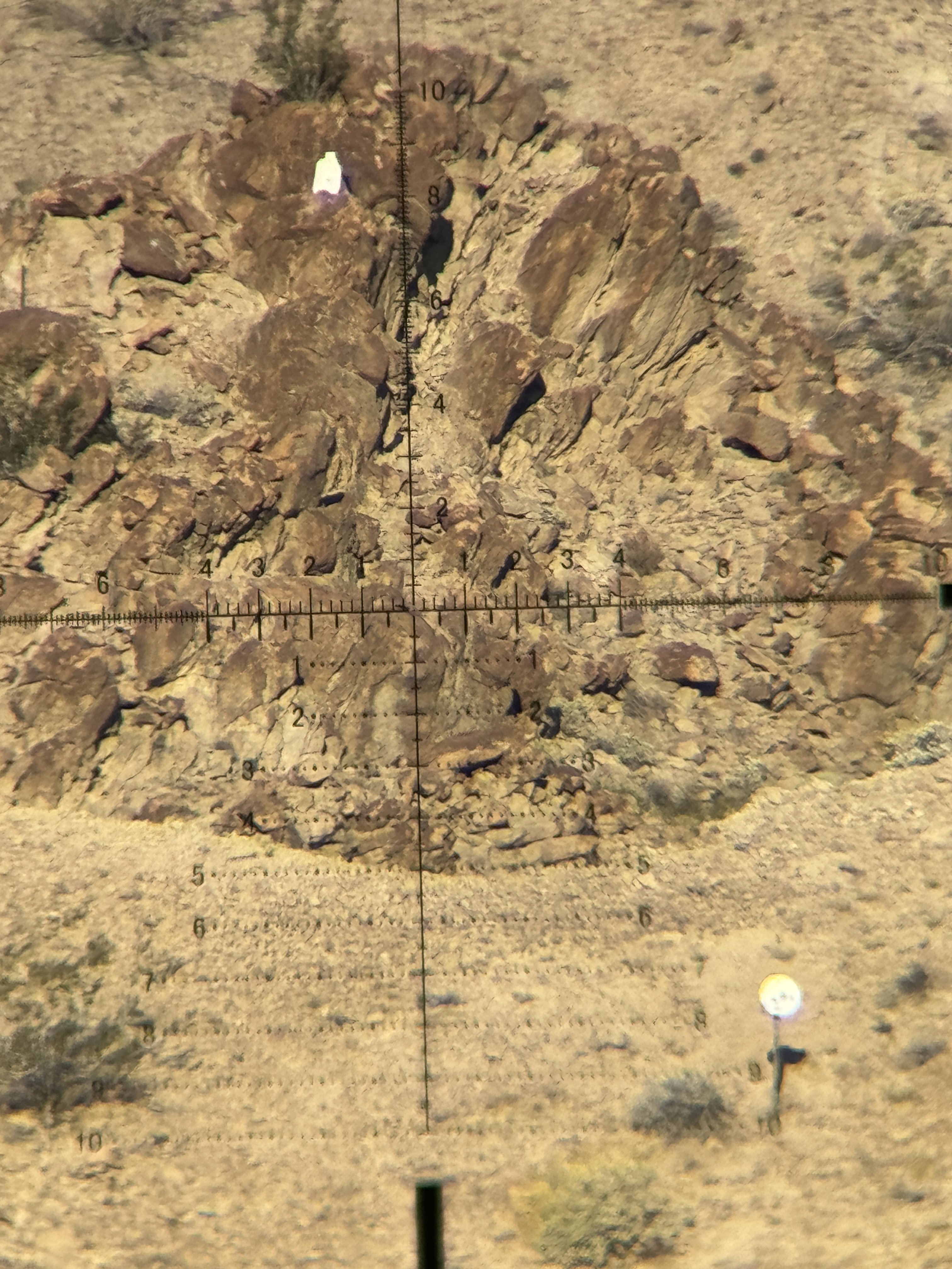

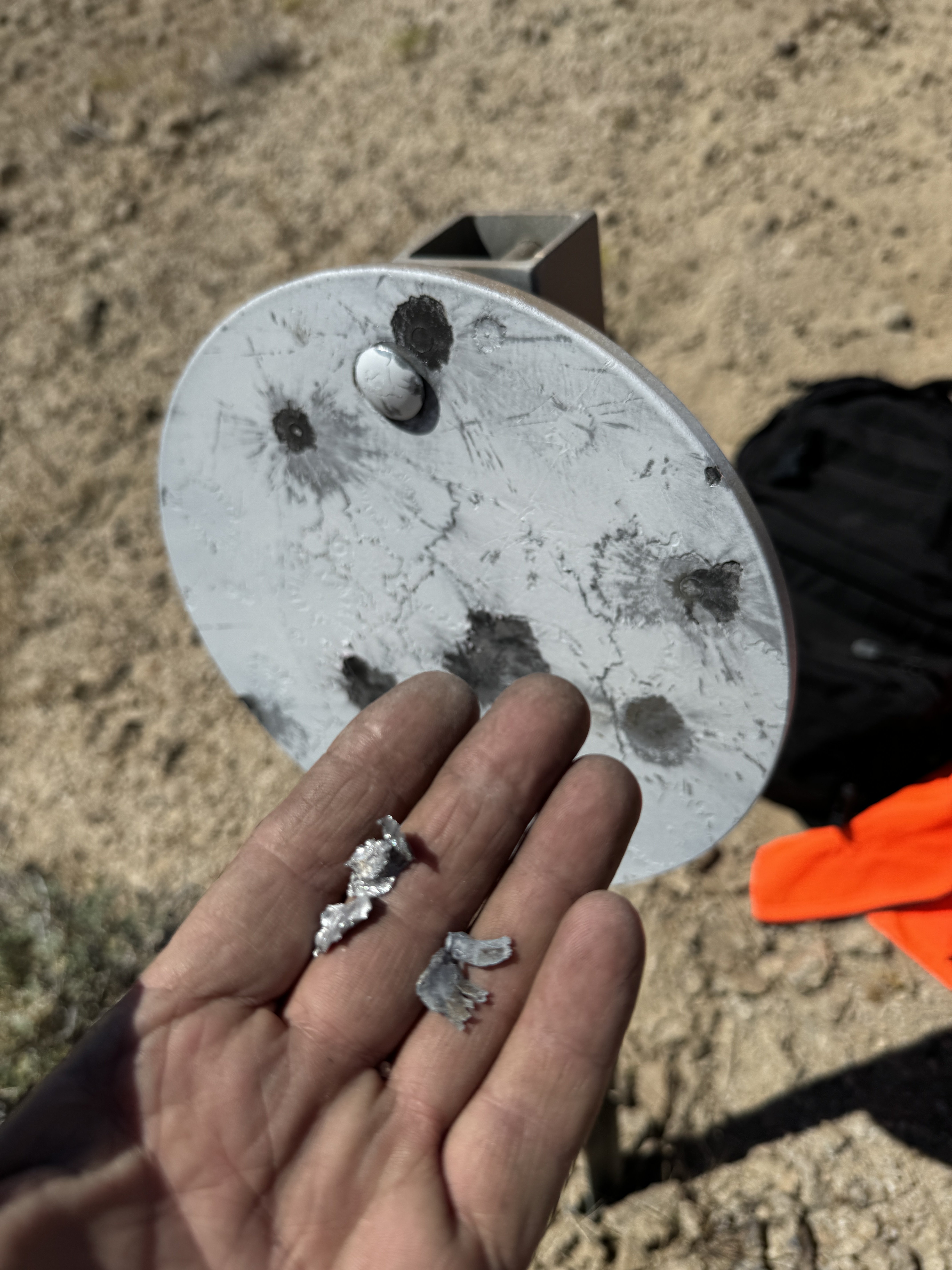

Below... The silhouette in the background is at 600 yards, and the circular 10’ gong in the lower right is at 400 yards, I was unable to reliably hit either target with the 255 gr slugs, the 385gr micro slugs by Mr. HP are a game changer and leave the barrel at just over 950fps, they will reach out and touch both the 400 and 600 with such authority that the lead bullets explode on the steel… undoubtedly very deadly at 400 and 600 yards. FYI; My AirForce Texan .510 is not stock, in its current configuration I’m tuning at just over 4,700 psi.
