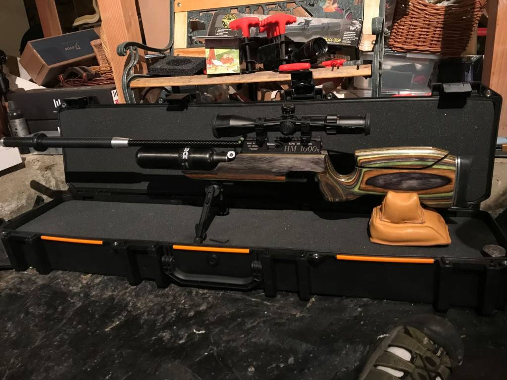

[/quote] ____________________________________________________________________________________________________________________________________________ Since I bought my two RAW HM1000x's, I've gotten more serious about long range shooting (specifically 100 yards). However, I really don't plan on entering any events or competitions per se .... or aspire to have a camera on my gun to watch pellets travel out to my target. I shoot to relax, have some fun and tinker with airguns - period. Unfortunately, my German heritage will not let me settle for anythings else but very, very close to MOA at 100 yards - we've gotta have goals.
I do subscribe to the
Motorhead philosophy of cleaning my barrel thoroughly, the Bob Sterne philosophy of getting my ES to 1%, increasing my gun's efficiency as much as possible, finding the optimal set-point for a given pellet, harmonic tuning of the barrel/pellet. These appear to be basic (supported) scientific ideas.
Mike has described above, his findings about bench rest shooting at its highest level. His proficiency cannot be disputed. He has said roughly, basic steps need to be taken to test and buy the best pellets possible for your barrel, and that's it. Now, I know his basic methodology is likely pretty comprehensive (by semi-amateurs), but short of doing any pellet sorting or sizing.
His findings
seem to be based on bench rest shooting out to 50 yards, not 100 yards (he may have test out further).
Unfortunately, were often shown videos of pellets spiraling when shot out to 100 yards. These are shown by many Big names (maybe marketing) in the air-guning business.
Question:
How do we avoid this when shooting PELLETS at 100 yards? Is this an area where pellet sorting does have some merit or do we just need to do a better job on the basics, ie Cleaning/refining the barrel, selecting better pellets or just eying pellets for gross, problematic issues?
