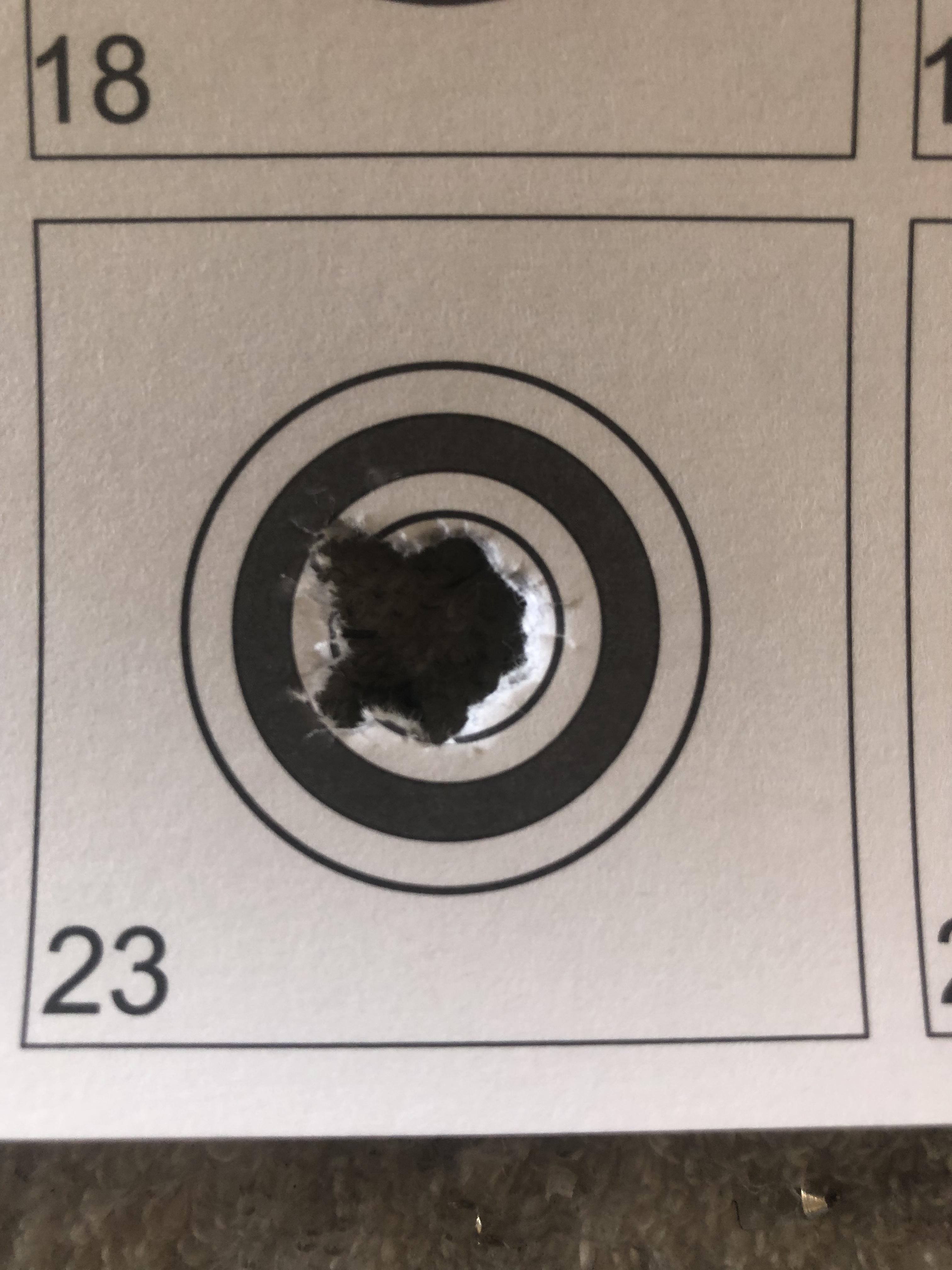

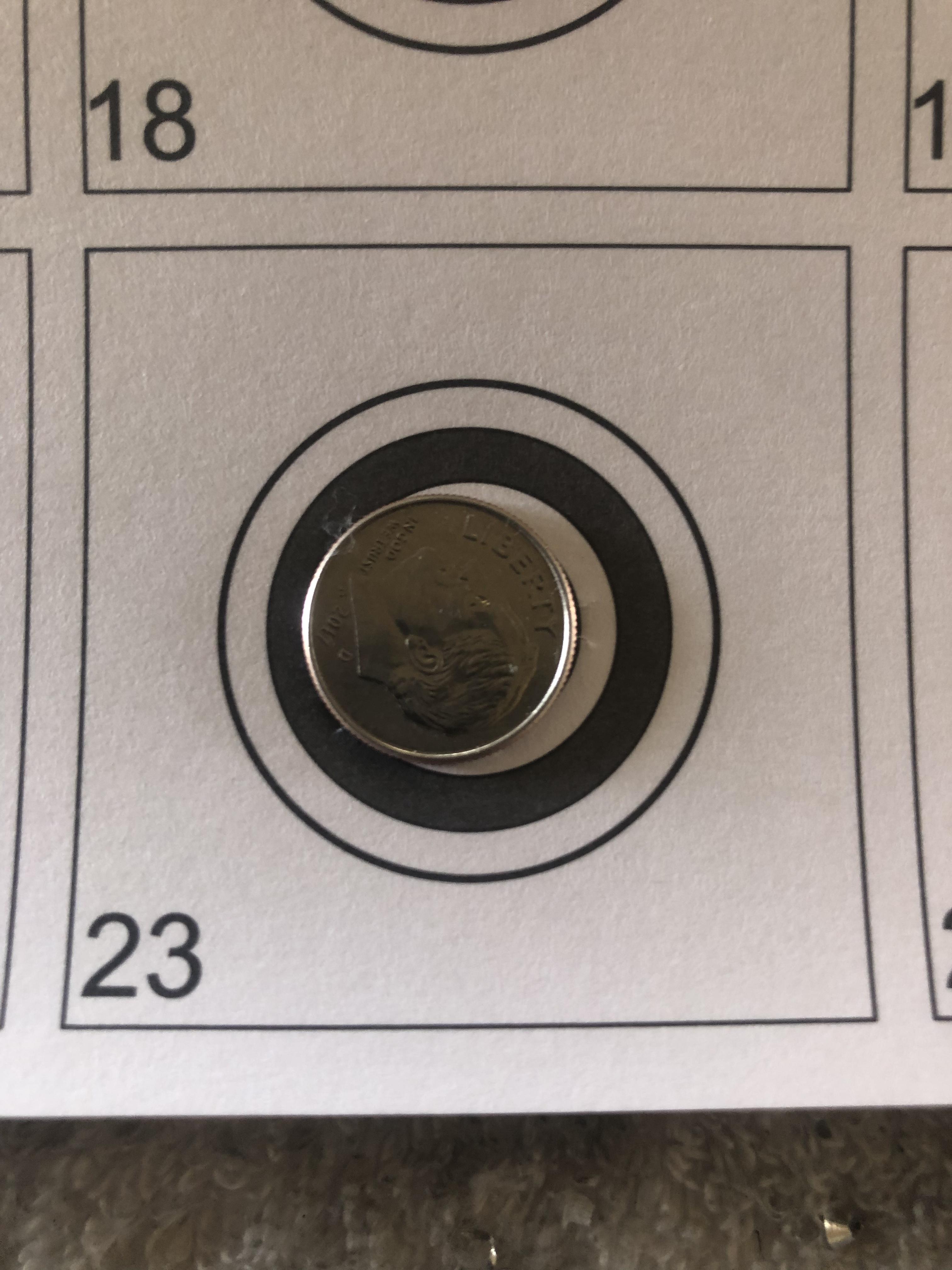

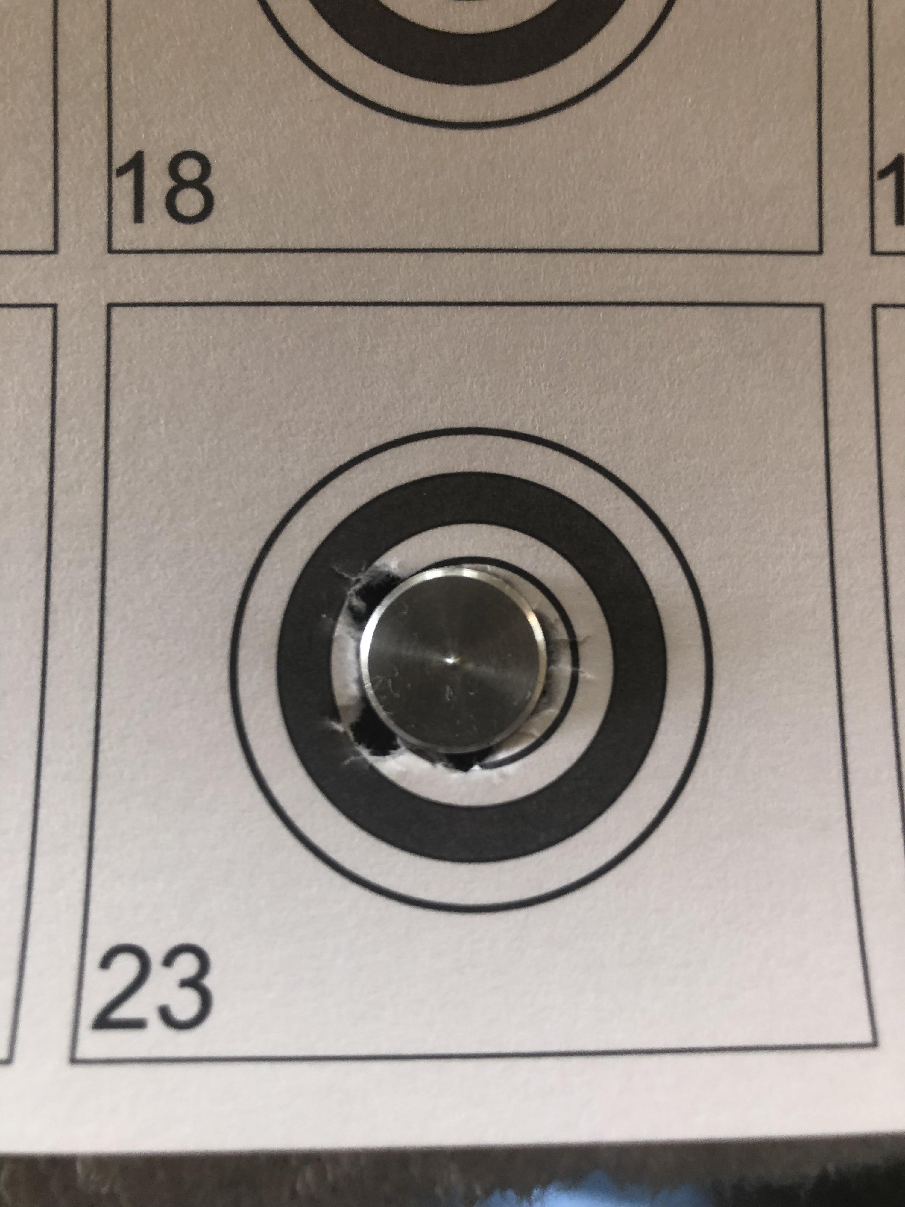

Got some new barrels and was testing them out. They were ok…but put the “old” one back in and shot this 50 shot group at 50y. I originally shot 25…then figured I would add another 25 to it. 25.4 RD monsters at about 970. Pic with a 1/2” disc and a dime. Shanked a couple….but happy. 😀. The core group that is under the 1/2” disc would all be x’s….but the couple strays could be nines.

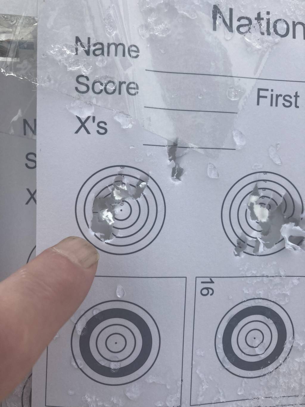

Amazing group Mike. I like how you can see the black line all the way around the group except for where the “pimples”wrecked it.

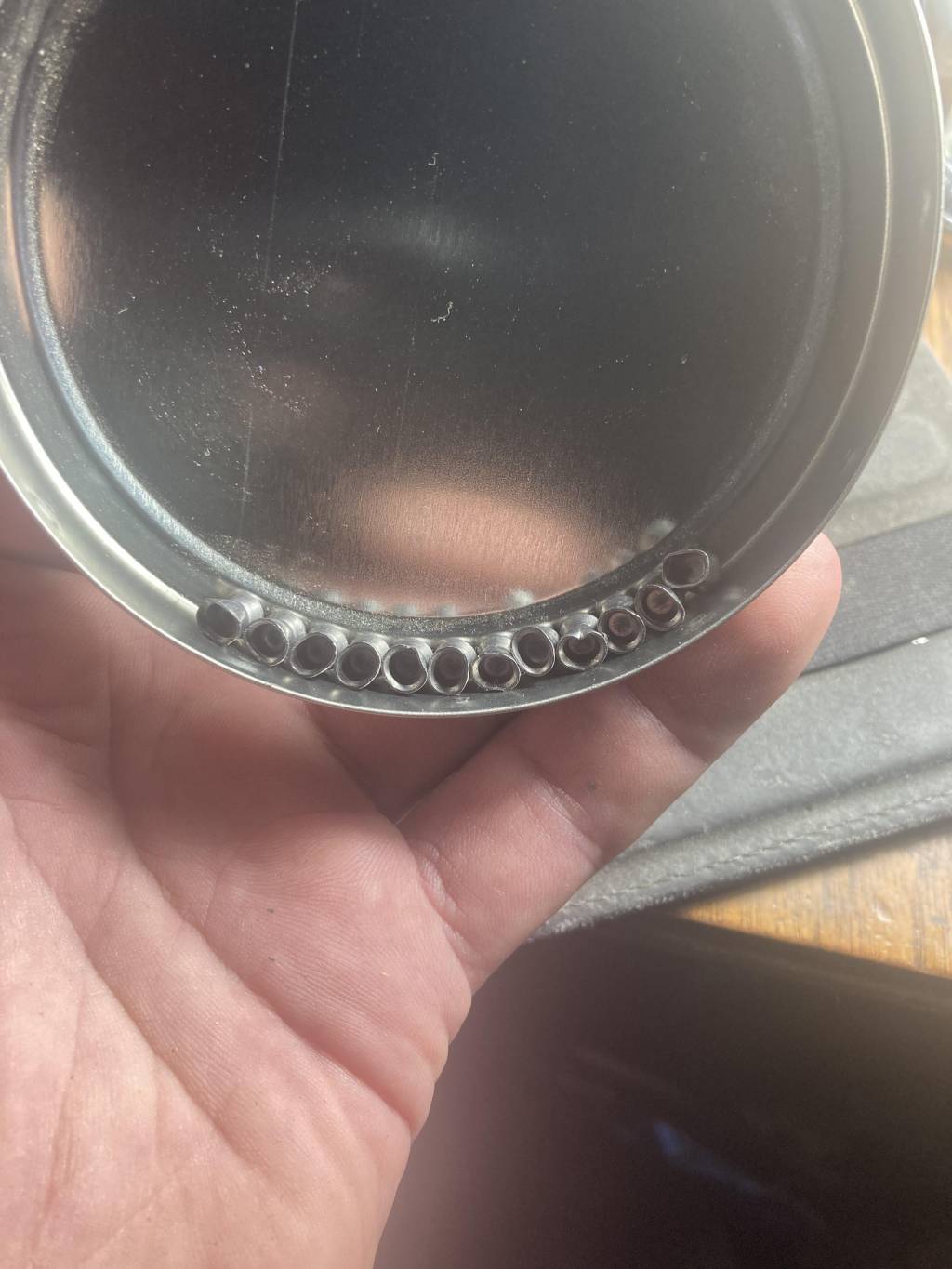

I remember your post about sorting pellets and did my own experiment by deforming some pellet skirts.
Then I shot them at 50 yards and was amazed that there were no bad flyers. I was shooting a .20 cal. You can see how badly deformed the skirts are.
The .20 pellet is very light with a soft skirt, I think the blast of air resizes it to the bore and they fly fairly true.
Edit: The two holes out of the target are not flyers, they are from a different session.

Dave, those pellets are absolutely mangled. The defects that are causing guys to discard pellets are only minute fractions of what you show. Good for you actually testing it out.
