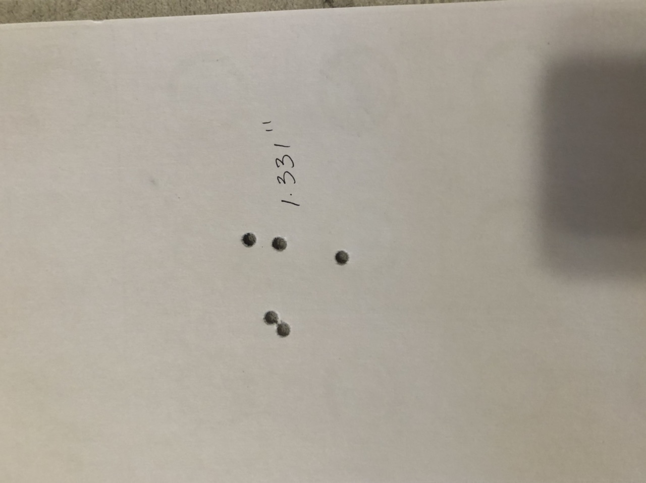

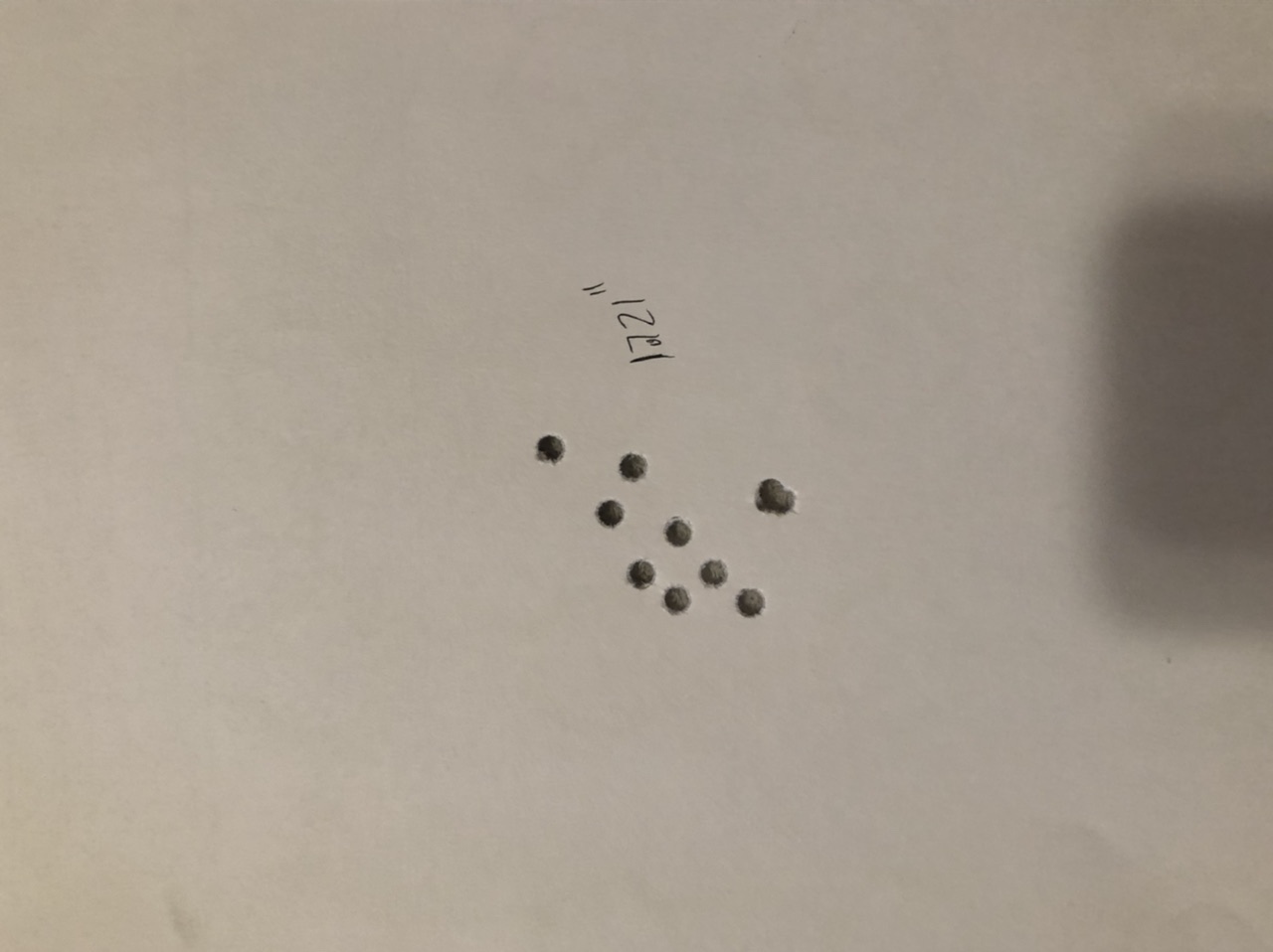

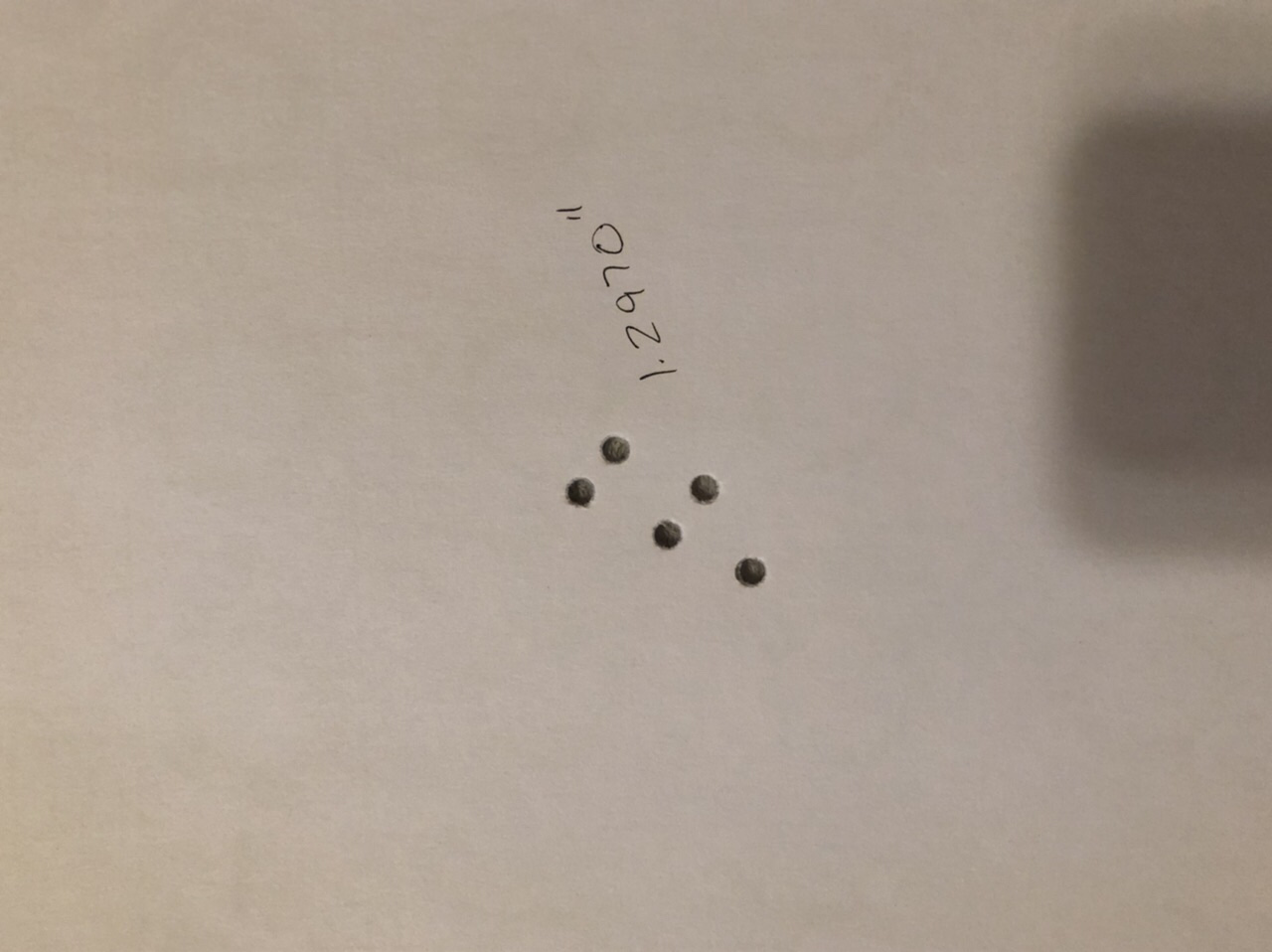

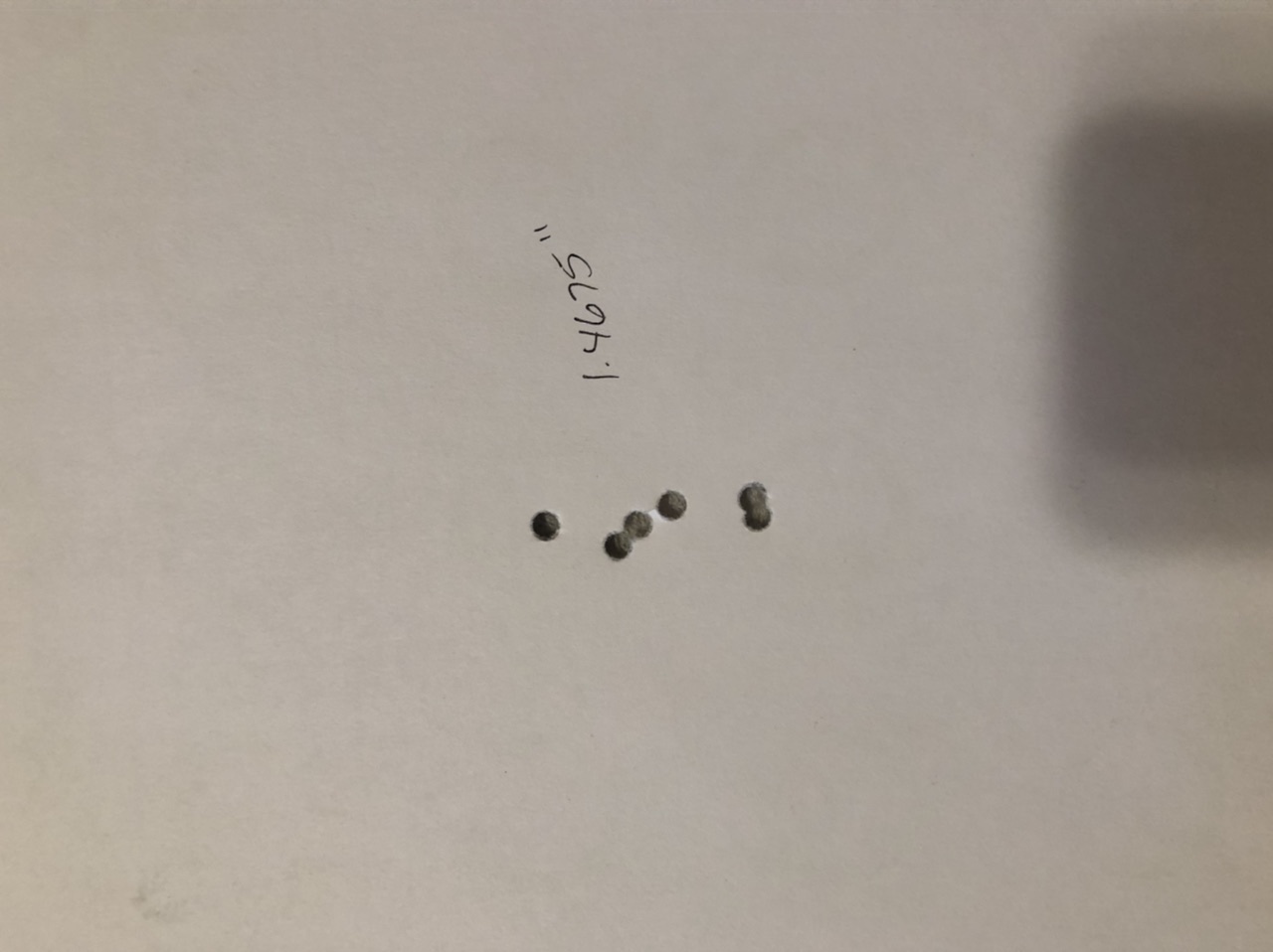

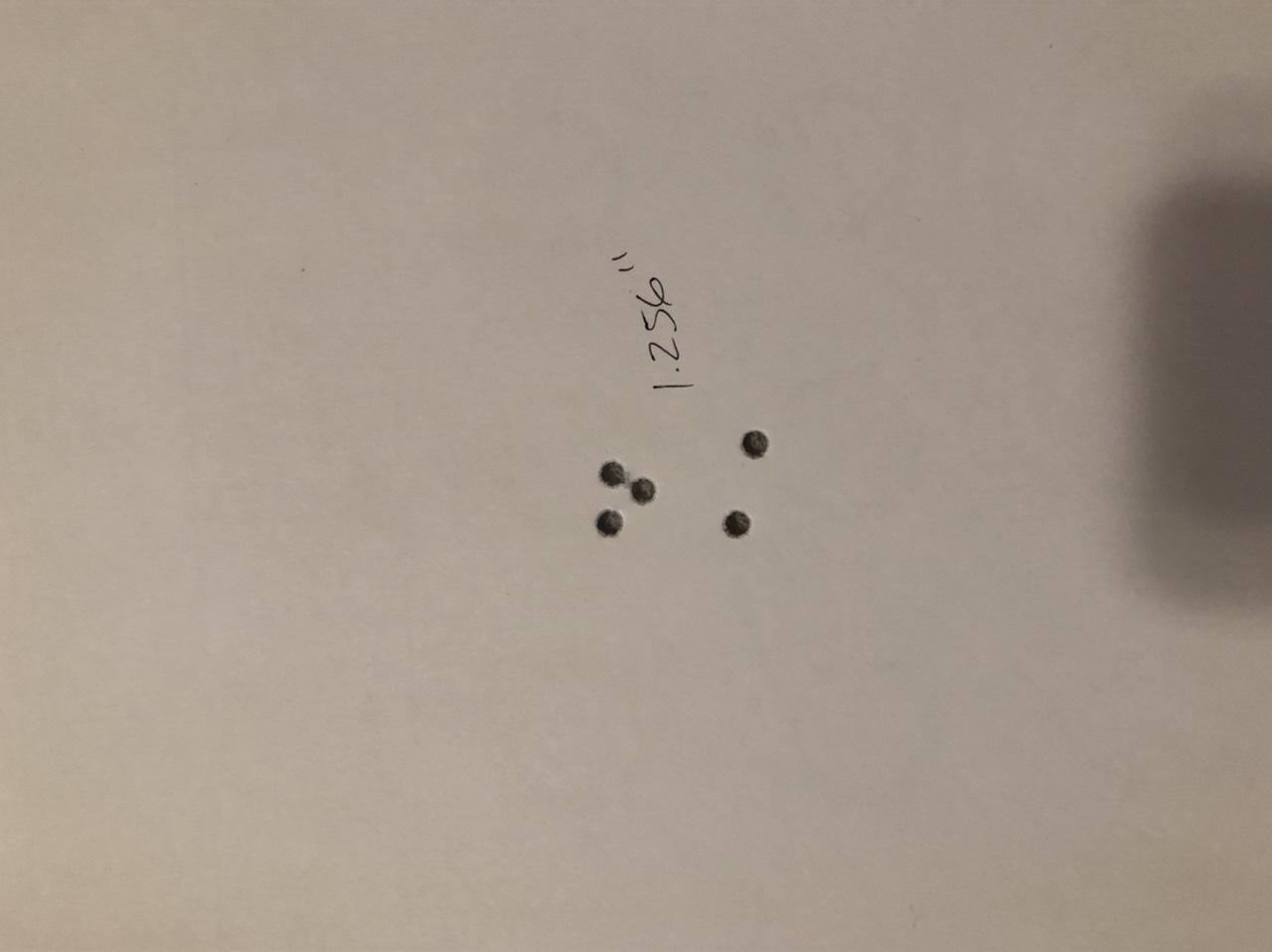

OK....I pressed 40 slugs and went outside as the sun was going down.
I set out 5 blank sheets of paper and intended to shoot 5 shots at each. I shot 6 on the first group because I apparently lost count...and I shot 5 for the next 3 ....then a 10 shot group on the last page at 200y cause I was liking where things were going. I shot each group in succession.
The ctc in inches is written next to the shots. The wind was fairly steady at 3-4 mph. My wind flag tails are at 45 degrees in 3.5 mph of wind.
The average ctc of all 5 groups is .67 MOA.
This is all of the shots I have taken at this distance except for the 7 I took earlier in the day when it was much windier....which were 1.045 MOA.
I feel like I can call this gun sub MOA at 200y. I still was unable to see the poi because it was slightly below scope view. I used the top of the fat part of the reticle below the dots to place on the top edge of the paper.
