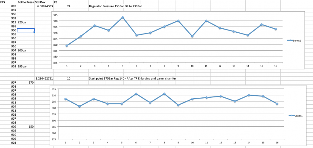

Hello Chuck,
Still working on consistency (I was trying with .22 now with a .25), and it has been improving, but not yet to the level you suggest. The chart below shows quite a nice improvement in consistency, when I did 3 things. I opened up the TP and lowered the working pressure down and weighed all the pellets (washing is coming :)) as you suggested. The accuracy at 50 yards is good from what I know - where I can get most shots inside a .5 inch circle. This may useful input for someone.
A couple of points still have me stymied.
  1. Is it 'normal' for a huma regulator's output pressure to vary by 10%? I run my bottle from 230bar down to about 150bar, it is over this range that I see 10bar difference. This is enough for me to start seeing valve lock at the higher end.
  2. The tests below were captured last Fri, shot a competition on Sunday, and now today, running a couple over the chrony, the velocity has dropped to about 860!? What could possibly cause that?

    1568773930_5532114605d81972abbf782.46528984_Screen Shot 2019-09-17 at 8.27.00 PM.png
    Would appreciate any input folks might have for me.
