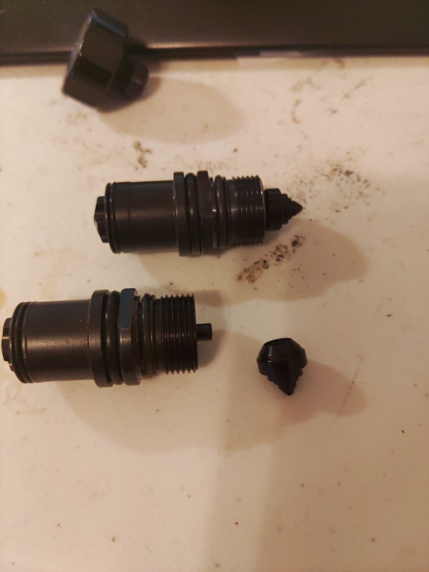

So here was the problem. The back part of the valve had fallen off the valve stem. That was what was rattling around in the air cylinder. Here's the valve with the broken piece with the new valve above it. Airforce sent me the new valve out under warranty, no problem. They even included a new pressure gauge since mine was not registering completely empty, though it obviously was. All back together now. Filled it back up, opened the back door (it's raining) and blew a big hole in the wet grass with a 350 grain NSA boat-tail. Good to go!.....here piggy piggy
