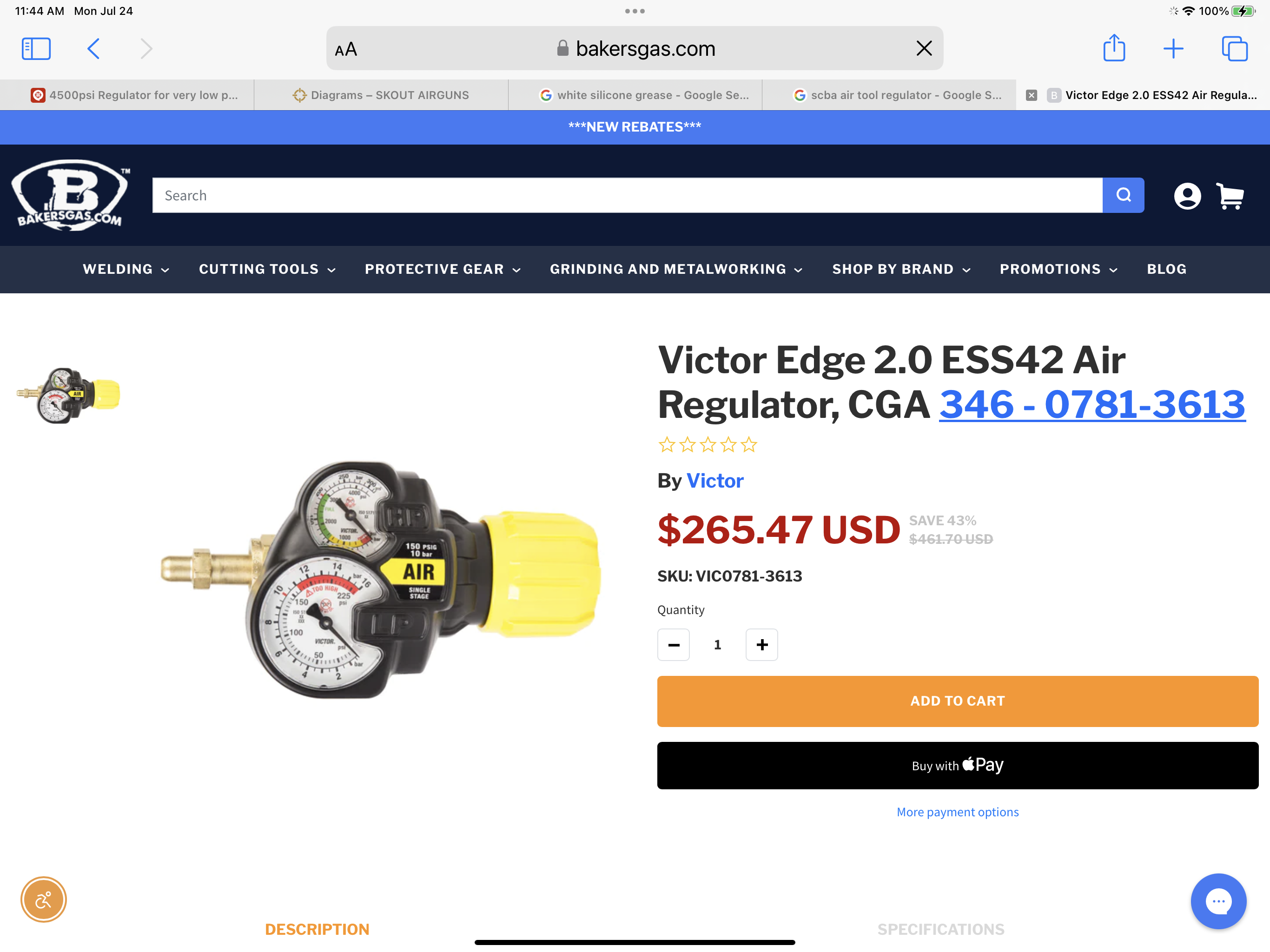

Aqua Environment makes the regulator you want. It ain’t cheap though.
