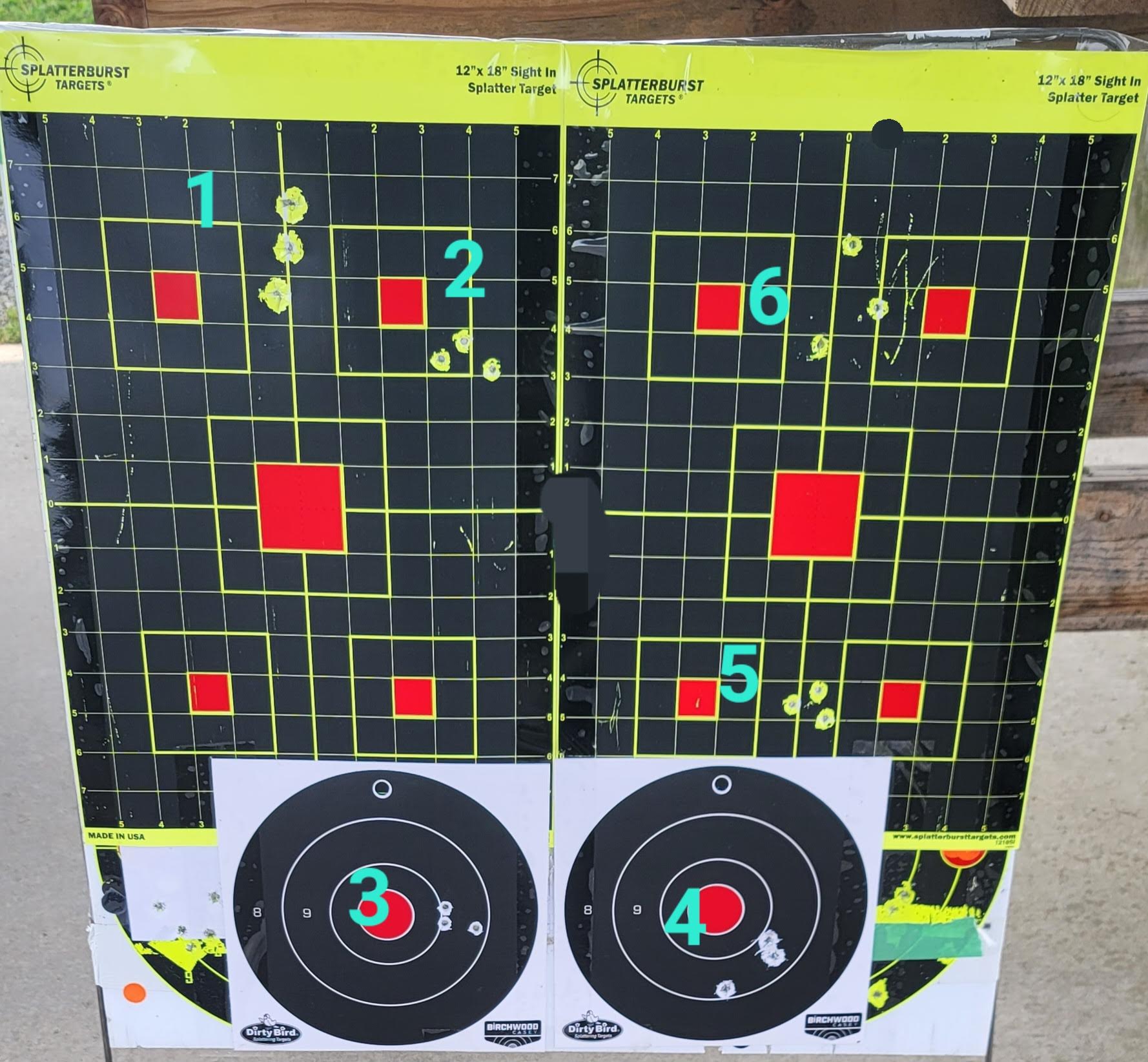

I been trying my hand at 100y bench with my Maverick VP .30cal, and I did so so with my second try at it, on a pretty windy day:
  1. JSB Hades
  2. JSB Knockouts
  3. FX Hybrid Slugs
  4. JSB Exacts 50.15gr
  5. FX Hybrids
  6. JSB Knockouts
