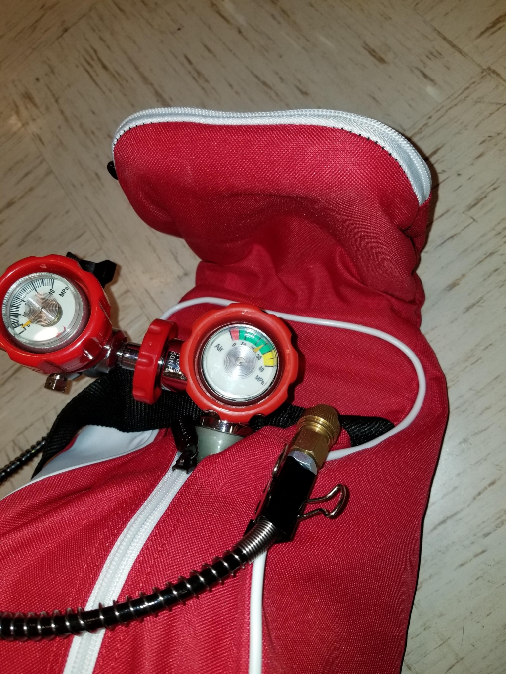

I purchased a 6.8L tank with dual gauge fill assembly from Acecare. No, it is not DOT certified but I have a YH to fill it. My tank is well constructed, the fill assembly works very well and the gauges are accurate. I am very happy with my purchase. Fill valve assembly and fill station set up.

Thanks, ctshooter. I have a Yong Heng compressor, so I should not need a dive shop.
