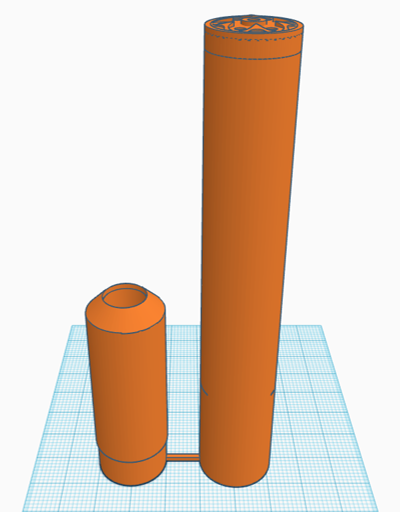

Do we have any 3D printing gurus around here? I have Tinkered up a design for a moderator that I really want to print. I usually solicit an online printing service, but the company I usually use is asking over $300 for this job and I'm not ready to drop that kind of coin on an experiment.
Like I said, this is just an experiment. I currently have a DonnyFL moderator and I have my eye on another DonnyFL moderator. But I really wanted to try this design before spending $185.
If someone is interested in printing this, I'd pay for materials and shipping.
It being what it is (a moderator), tolerances are going to be pretty critical, so would need to be a relatively good quality print.
I've attached a screenshot of basically what it looks like from the outside. The longer part is 13" long, so printer would have to be able to accommodate a part that large. (I was going for max volume)
Just thought I'd ask. You guys never disappoint.

whats the shorter bit?
It is large. Lol, I know, that's what she said, never.
I could probably segment the larger piece into 2 halves that sleeve into each other. OD is already at 2.1" so I don't think I want to go larger than that.
The shorter part is essentially a "blast chamber". It would sleeve over barrel shroud back to the air tank. The bottom of the short part sleeves into the bottom of the taller part to add volume.

Update: I ended up making some adjustments to my design.
I broke the long part in half and made it sleeve together. This reduced the print cost. I went to Treatstock as recommended above, and found somebody to print it out of ABS, 100% fill for less than $100.
So I guess we'll see how this thing works out. I think there is about a 13 day turnaround time on the print job, so might take a little bit before I have anything to show.
I still have to do some fabrication on the part that threads to the barrel itself. I bought a DonnyFL end cap that will go in between the front part (moderator) and the rear part (blast chamber). This part will have to undergo some machine work so that air can flow from the moderator to the blast chamber.
