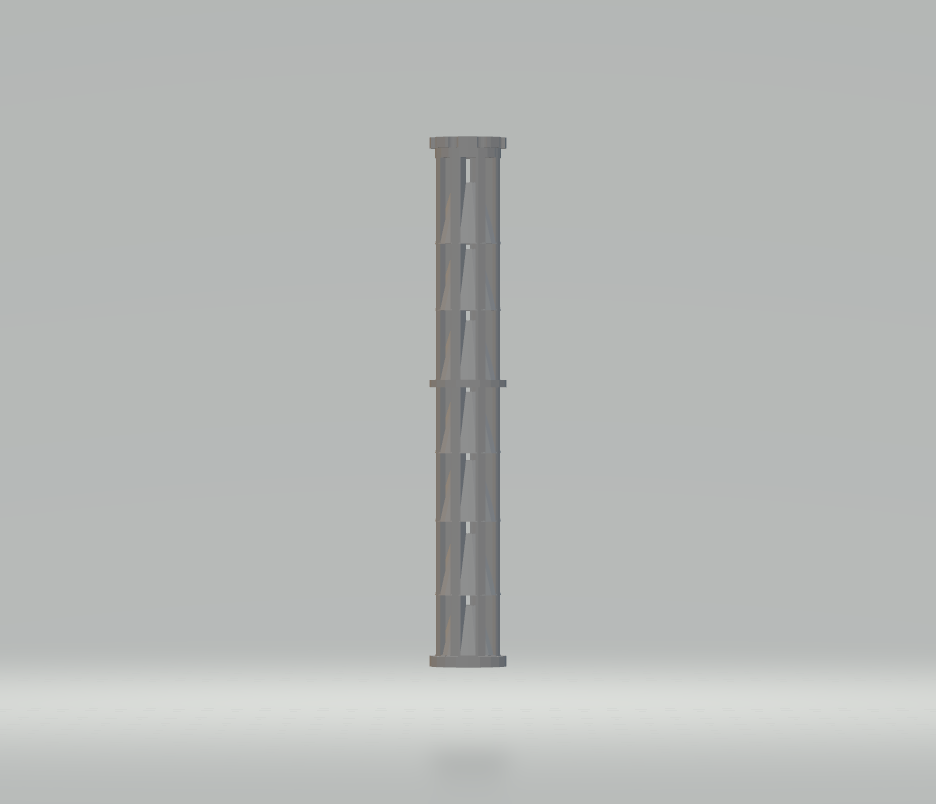

if you have a 3D printer you can modify this to fit
View attachment Flash Baffle ver.7.1624304540.1628640363.stl
Has anyone tried the 1 piece baffle pictured above
I use the one above in many of my guns, I designed it originally for a Hatsan QE gun, but modified it to work in some of my home made Moderators, have one on my Prod and it is whisper quiet, built one for a Sam Yang 909 .44 cal, it made it as loud as a Sheridan with 5 pumps, I do wrap the core with felt to help reduce sound even more, the Baffle is Proven and will work better than the Original as long as you size it correctly and wrap it with felt.
you can find them on Tinkercad in the Users Gallery
