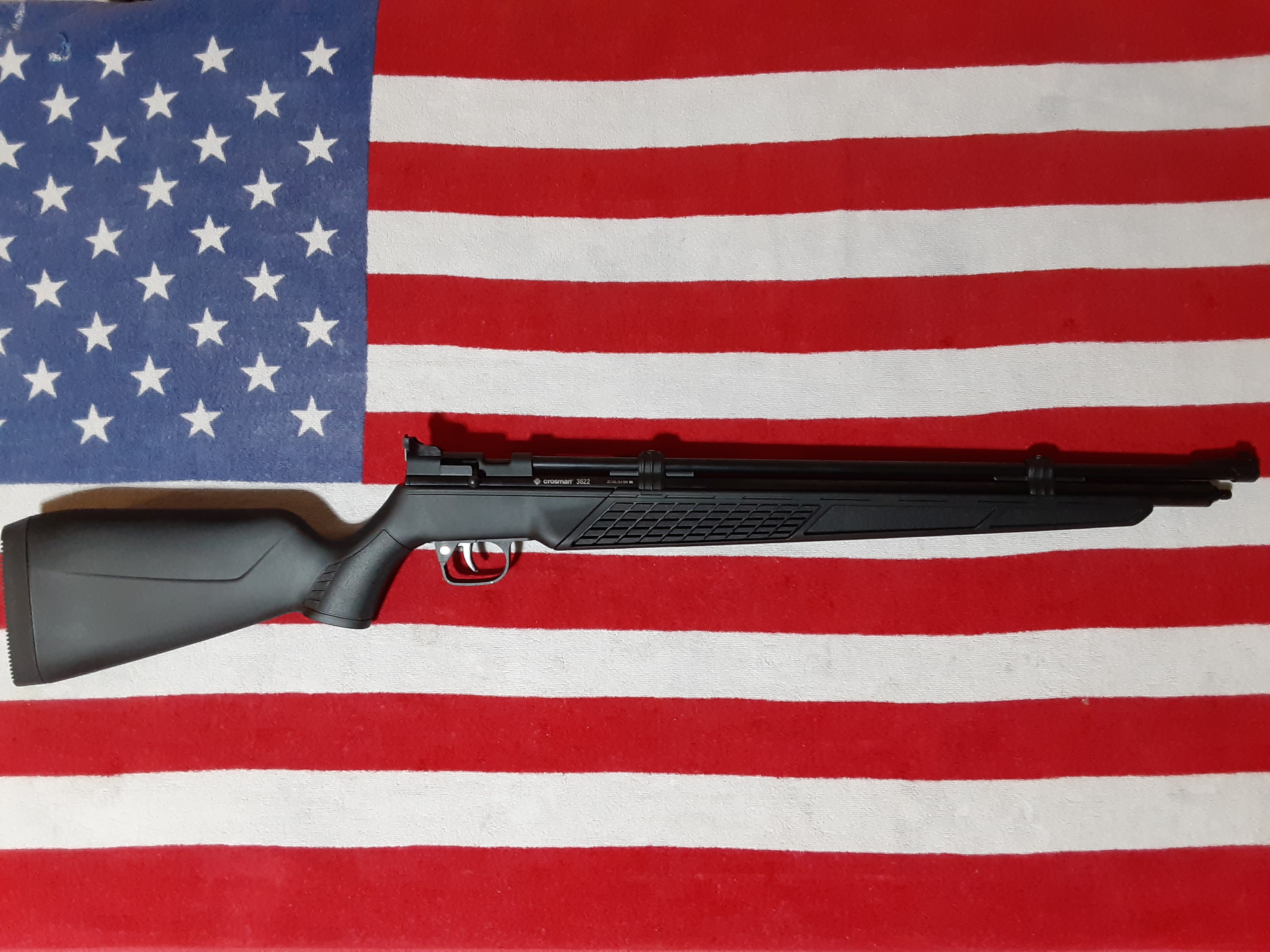

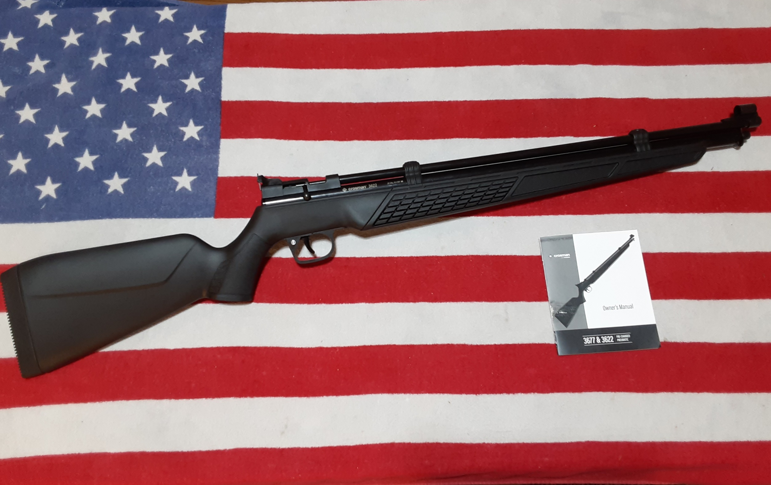

Things of note right off the bat in no particular order.
The barrel is not the same as the 362. It has a very smooth finish, not like the machined finish of the 362, 2240 etc. Much more like the Lothar barrels.
It has a hammer spring adjuster. It will have to be removed from the stock to adjust. I will be modifying the stock so I don't have to do that.
The trigger guard is plastic as opposed to the aluminum guard on the 362.
The manual says 3677 and 3622. There will be a .177.
The box says 3622 "Syn" for synthetic. This leads me to believe there will be a wood stock version.
It's super light. Can't be 4lbs. I don't have a scale that accurately measures under 5lbs, anymore 😁

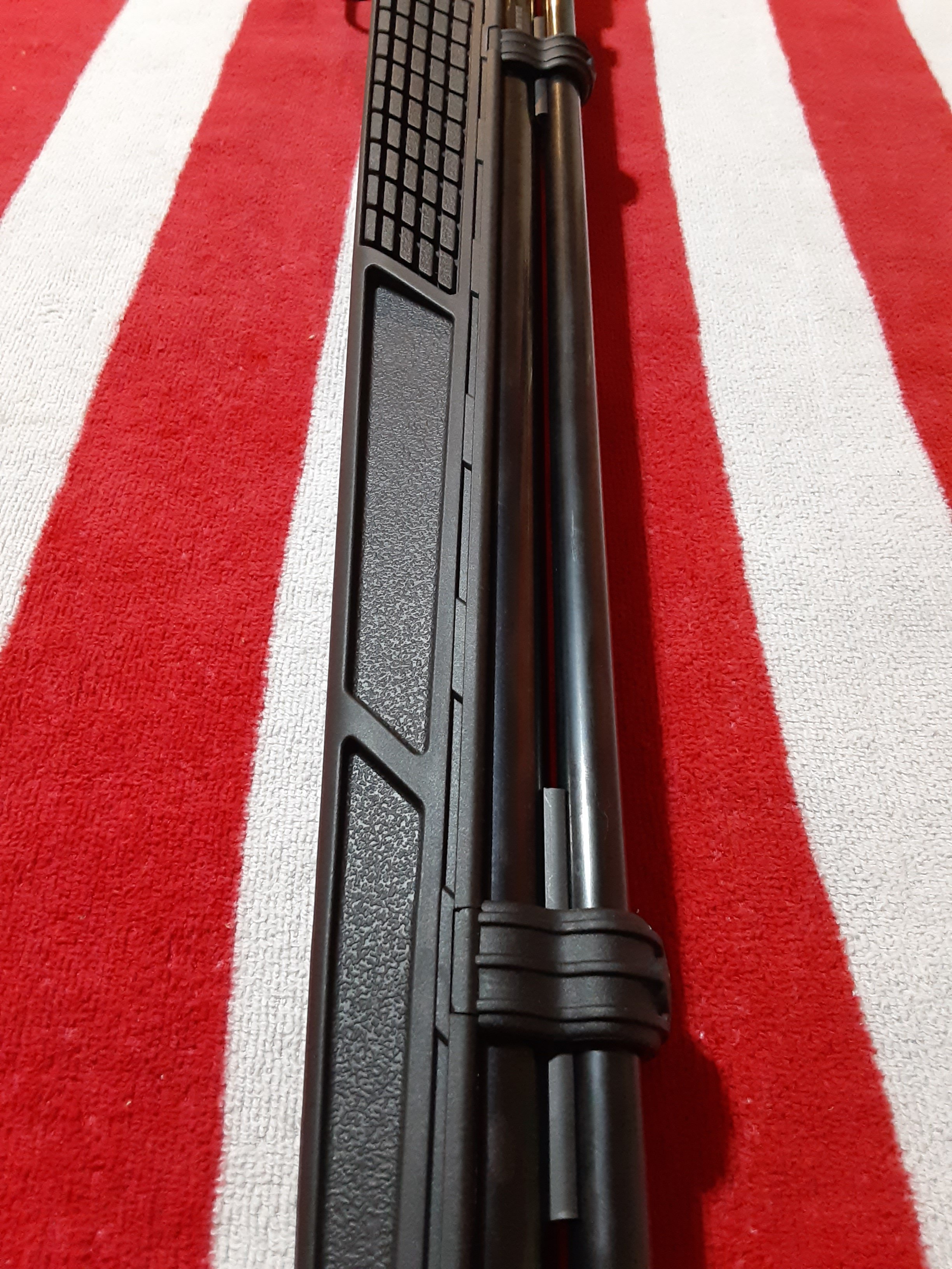

The barrel bands are 'locked' into the stock and the barrel is perfectly centered.
The bolt probe is longer and thinner than previous models.
The tube diameter matches the 13xx series, not the 2240 series. The valve will obviously be closer to the pumper valve. Interesting.
Pending accuracy testing, I love it. It appears to be worth every penny and then some.
It does have a 5 year warranty.

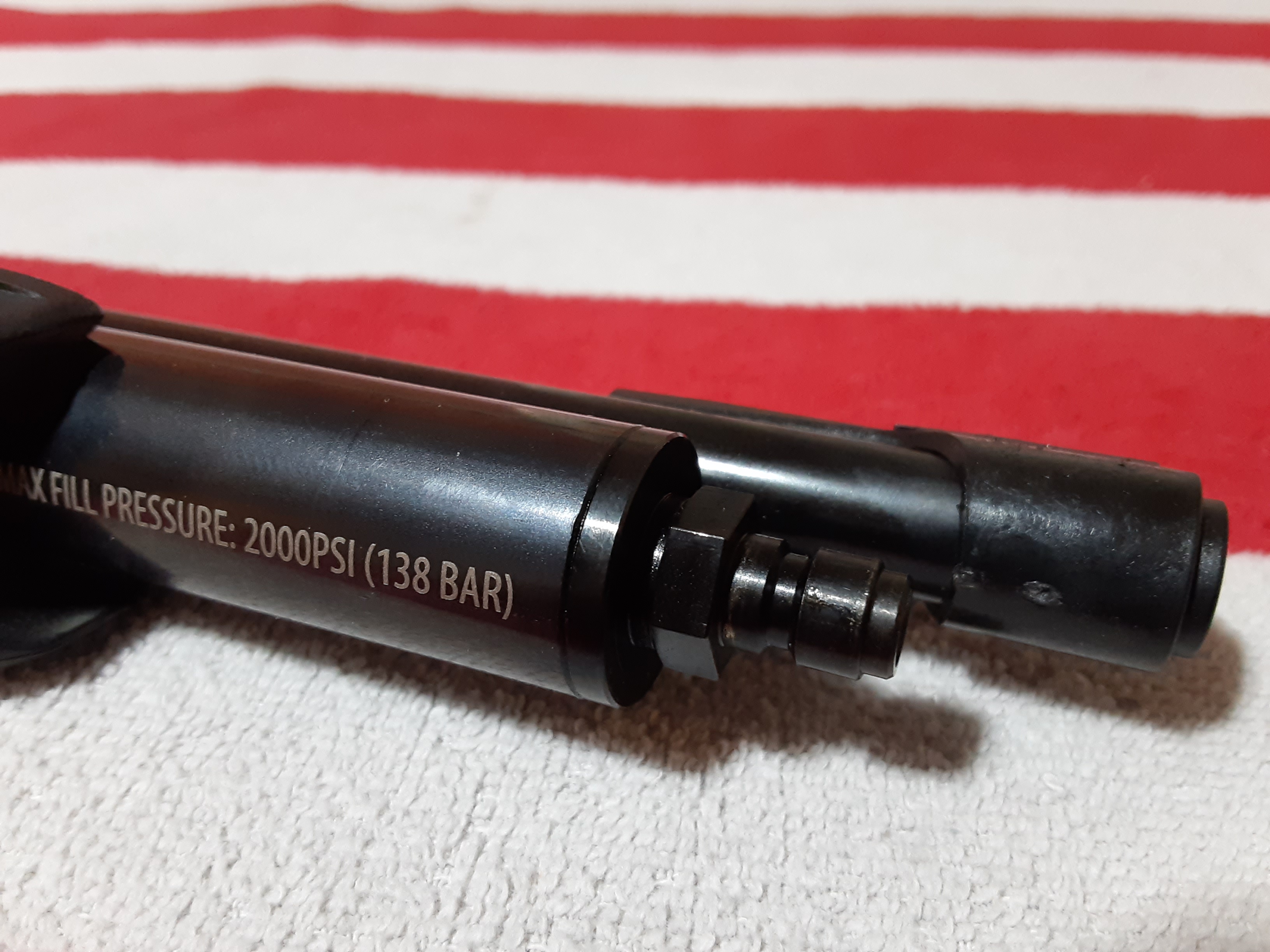

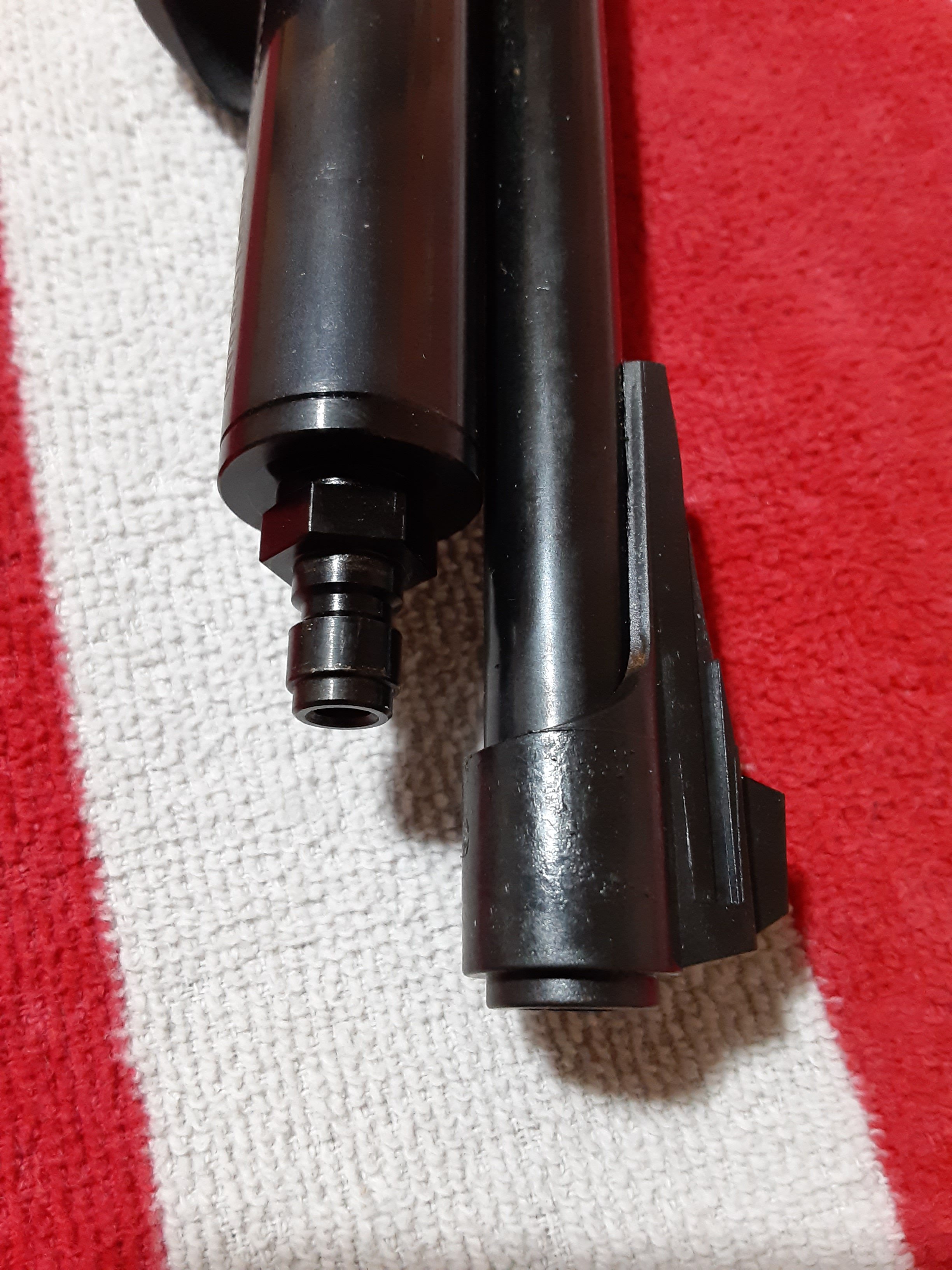

Pics of the foster. My QD barely squeezes by the front sight. I don't like that they coated it black, it will definitely look beat up in a hurry and the coating makes it a little tough to get the coupling to close. As you can see it's a bit of an interference fit with the sight. One of the factors for wanting a 24" barrel. The sight could be sanded some to create more clearance.

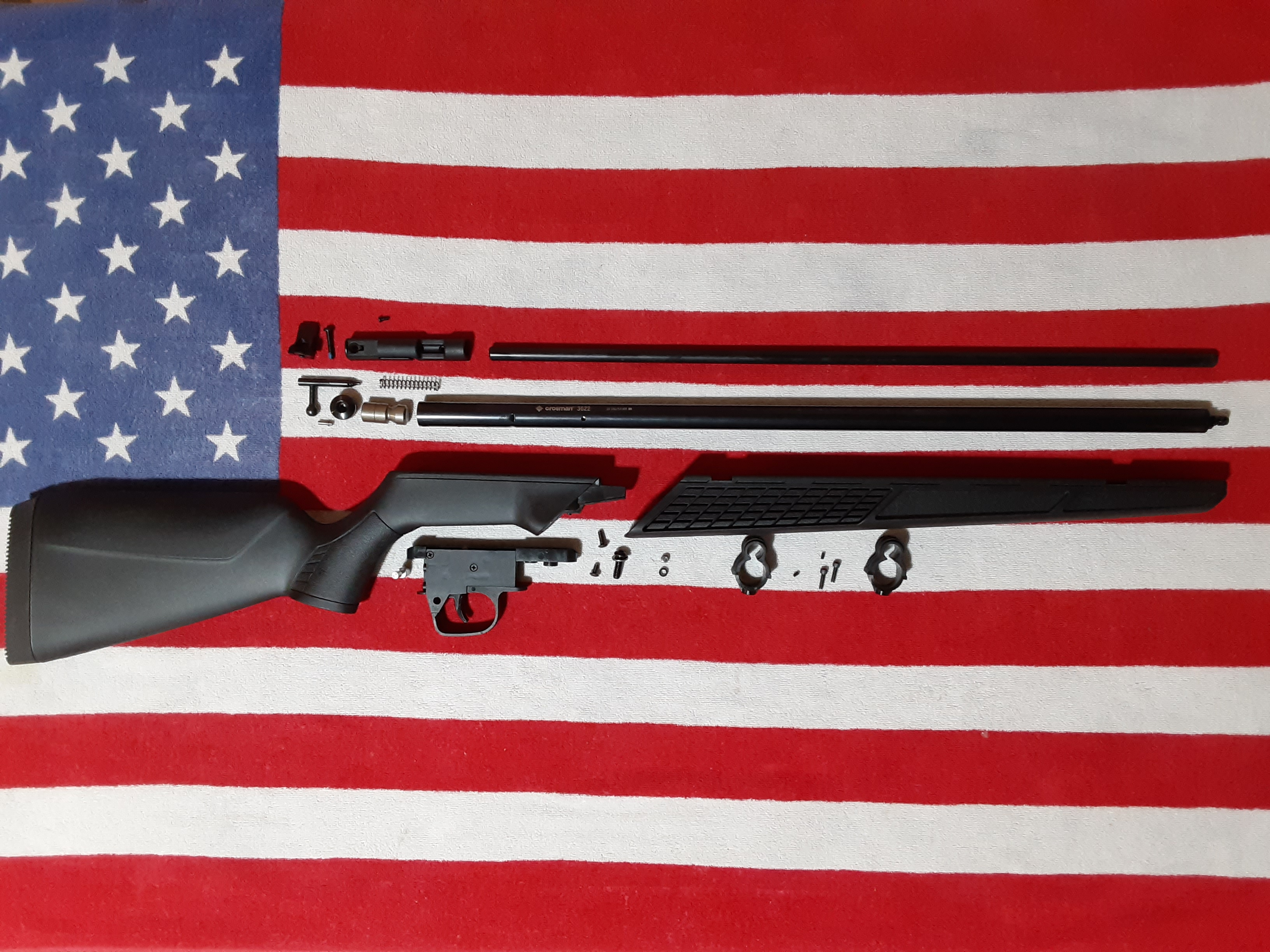

Per usual it's in pieces less than 24hrs after getting here.
Yes it has the same valve, anchored the same way as a 1322 via the tube being punched.
The transfer port is the standard size. I'm going to swap it for a larger one just because I have one. Eventually I will port the valve but I'm in no hurry to do that yet.
The hammer is a little different than what I'm familiar with in that it has a groove in it and the spring hole is deeper. I think this is to offset the depth the spring adjuster gives up and keeps the spring from deflecting when it is turned in. Seems a little self-canceling and I would personally rather just tune with a fixed cap and swapping springs. The trigger group screw and the sight screw that retain the cap, drag on the adjuster/ lock it in place so adjusting is going to be a hassle anyway. Kind of seems like an afterthought to me. I'll probably swap for a regular cap because I have one here already and just tune with shim or spring swaps.
The barrel bands are not snug on the barrel and when the set screws are tightened it flexes the barrel down. I'll be adding some 2260 barrel trim to maintain a perfect gap between the barrel and tube from breech to muzzle. I don't like my barrels to be warped when installed.
I will polish the hammer for smooth cocking. Pretty standard on the platform.
I will replace the trigger return and main springs with lighter ones. The trigger is way too heavy as per usual on this group. It uses hex screws front and rear to attach to the tube intead of the funky square/slot rear screw that nobody likes. The sear will be deburred and polished.
Nothing I do today will cost anything but time because I have the parts. The rear cap doesn't have to be swapped and many will choose not to.
