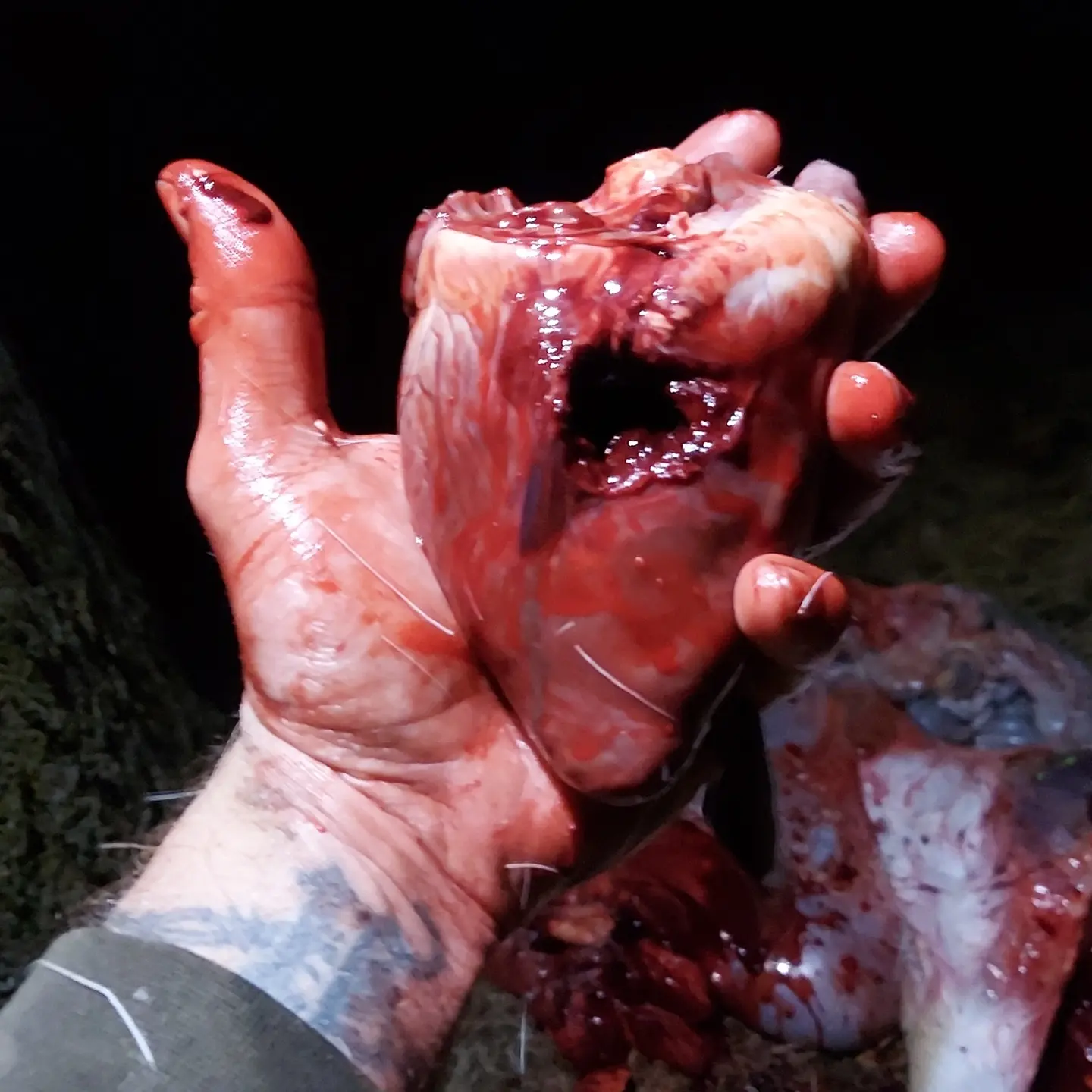

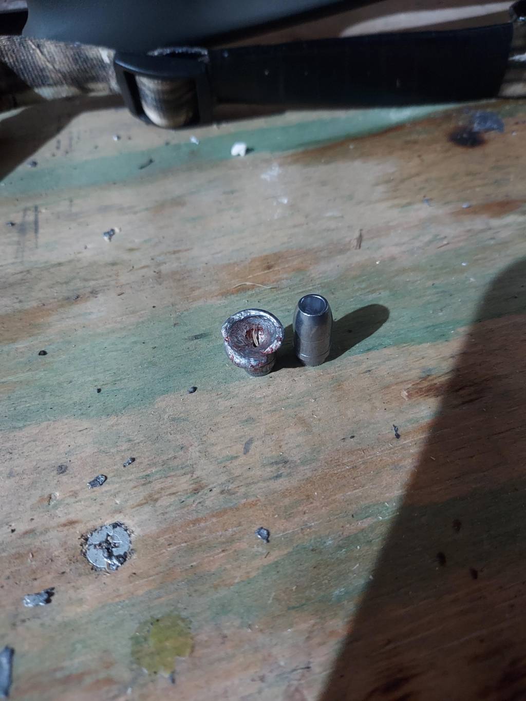

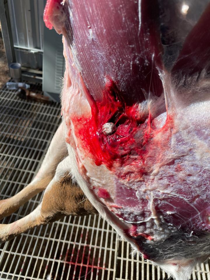

A bulldog tune can do 300+FPE or 360FPE with a 185g in .357 have folks who have taken 400lb hogs and 12 points heart lung shots at 100yds plus with no runners. With the right tune a 357 at that energy level is more than capable of big game and at distinaces exceeding 150yds.
Heart lung 85yds clean thru stopped just under skin opposite side.
